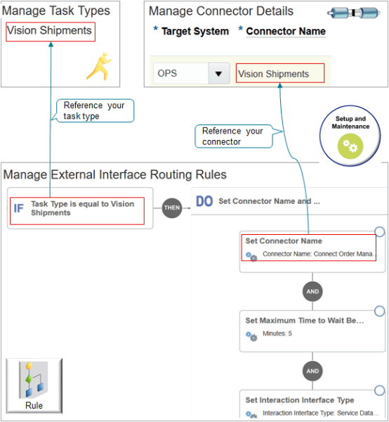

  3. Set up a connector that includes the URL to your fulfillment system and any sign in requirements, such as user and password. Order Management uses the connector to find your fulfillment system and communicate with it.
  4. Set up a routing rule that routes calls from your fulfillment system to the connector according to the task type that you specify.
  5. At run time, Order Management and your fulfillment system use the connector to communicate status updates throughout the fulfillment lifecycle, such as Started, Picked, Awaiting Shipping, and Shipped.

Assume you must integrate your shipping system, Vision Shipments, with Order Management so you can fulfill sales orders that you create in the Order Management work area. Vision Shipments uses status values that are unique to Vision Shipments, such as Awaiting Fulfillment and Awaiting Fulfillment Line Aggregation. You specify them in the Setup and Maintenance work area. Here's a summary of the steps you will do in this topic.
  1. Manage task types.
  2. Manage status values and status conditions.
  3. Create a new orchestration process.
  4. Add status values for the order line.
  5. Publish your orchestration process.
  6. Set up connector and routing rule.
  7. Test your setup.

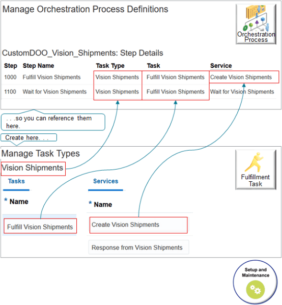

Manage Task Types
To start, you create task type, task, and services so you can reference them later in this procedure when you set up the orchestration process:

  1. Go to the Setup and Maintenance work area, then go to the Manage Task Types task.
  2. On the Manage Task Types page, click Actions > Add Custom, set values, then click Save:
    Attribute
    Value
    Task Type
    Vision Shipments
    You can use any value.
    Description
    Task type we use to communicate with our Vision Shipments fulfillment system.
  3. In the Details area, on the Services tab, add the services you will use to communicate with your Vision Shipments fulfillment system:
    Code
    Name
    Operation Code
    Hold Enabled
    Create Vision Shipments
    Create
    Yes
    Vision Shipments Inbound
    Response from Vision Shipments
    Inbound
    Cancel Vision Shipments
    Cancel
    No
    Hold Vision Shipments
    Apply Hold
    Release Vision Shipments
    Release Hold
    Update Vision Shipments
    Update
    Yes
    Wait for Vision Shipments
    Wait
    Its recommend that you use these operations to accommodate the various statuses that Order Management uses when it processes each sales order. This way, the statuses in your fulfillment system will be synchronized with the statues in Order Management.
  4. Click Tasks, click Actions > Add Row, set the values, then click Save and Close:
    Code
    Name
    Display Name
    Intermediate Replanning
    Fulfill_Vision_Shipments
    Fulfill Vision Shipments
    Doesn't contain a check mark.
    Order Management uses the task to communicate status values with your fulfillment system.

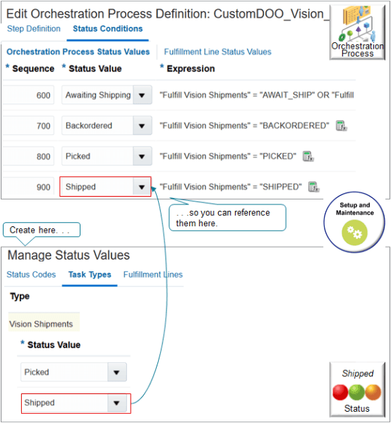

Manage Status Values
Create status values on the Manage Status Values page so you can reference them when you set up the orchestration process:
Create status values on the Manage Status Values page so you can reference them when you set up the orchestration process.
Note
  • Add status values on the Manage Status Values Page.
  • Later in this procedure, reference your status value on each orchestration process step.
  • For details, see Fulfillment Tasks.
Try it.
  1. Go to the Setup and Maintenance work area, then go to the Manage Status Values task.
  2. On the Manage Status Values page, click Task Types, click Query by Example, enter Vision Shipments in the Type column, then press the Enter key.
  3. In the Status Values area, notice that the Setup and Maintenance work area automatically created a set of status values for you when you created the Vision Shipments task type:

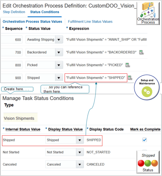

Manage Status Conditions
Create status values on the Manage Task Status Conditions page so you can reference them when you set up the orchestration process:
Create status values on the Manage Task Status Conditions page so you can reference them when you set up the orchestration process.
  1. Go to the Setup and Maintenance work area, then go to the Manage Task Status Conditions task.
  2. On the Manage Task Status Conditions page, click Query by Example, enter Vision Shipments in the Type column, then press the Enter key.
  3. In the Status Conditions area, notice that the Setup and Maintenance work area automatically created a set of conditions for you when you created the Vision Shipments task type:

  4. Modify steps:
    • In the Process Details area, modify values in the row that contains Create Shipment Request in the Step Name attribute:
      Attribute
      Value
      Step Name
      Task Type
      Vision Shipments
      This is the task type you created earlier in this procedure.
      Task
      This is the task you created earlier in this procedure.
      Service
      This is the service you created earlier in this procedure.
      Update Service
      Cancel Service
      Don't modify any of the other attributes.

  1. Click Status Conditions, then, on the Orchestration Process Status Values tab, verify values in the Expression column:
    Sequence
    Status Value
    Expression
    600
    Awaiting Shipping
    "Fulfill Vision Shipments" = "AWAIT_SHIP" OR "Fulfill Vision Shipments" = "VARIOUS"
    700
    Backordered
    "Fulfill Vision Shipments" = "BACKORDERED"
    800
    Picked
    "Fulfill Vision Shipments" = "PICKED"
    900
    Shipped
    "Fulfill Vision Shipments" = "SHIPPED"
    1200
    Partially Picked
    "Fulfill Vision Shipments" = "PARTIAL_PICK"
    1300
    Partially Backordered
    "Fulfill Vision Shipments" = "PARTIAL_BACK"
    Make sure you verify the correct rows. For example, several rows contain the Awaiting Shipping status value, but you must verify only row 600.
    If you don't have these values, then modify the expression, as necessary. For example, if you must modify row 600:
    • Click the Calculator icon in the Expression column.
    • In the Expression Builder dialog, delete everything in the Expression window, expand CustomDOO_Vision_Shipments, Fulfill Vision Shipments, click AWAIT_SHIP [ Awaiting Shipping ], then click Insert Into Expression.
    • In the Expression window, enter the text OR after the closing bracket.
    • Click VARIOUS [ Various ], then click Insert Into Expression.
    • Verify that the Expression window contains "AWAIT_SHIP" OR "VARIOUS", then click OK.

Add Status Values for the Fulfillment Line
  1. Click Fulfillment Line Status Values, then click Edit Status Rule Set.
  2. On the Edit Status Rule Set page, verify values:
    Sequence
    Status Value
    Expression
    1200
    Awaiting Shipping
    1300
    Backordered
    1400
    Picked
    1500
    Shipped
    1800
    Partially Picked
    1900
  3. Click Actions > Add Row, then set the values:
    Sequence
    Status Value
    Expression
    1930
    "Fulfill Vision Shipments" = "AWAIT_FULFILLMENT"
  4. Click Actions > Add Row, set the values, then click Save and Close:
    Sequence
    Status Value
    Expression
    1960
    "Fulfill Vision Shipments" = "AWAIT_FLINE_AGGREGATE"

Set Up Connector
  1. Go to the Setup and Maintenance work area, then go to the Manage External Interface Web Service Details
    For details about how to set up a connector, see Overview of Connecting Order Management to Your Fulfillment System. task.
  2. On the Manage Connector Details page, click Actions > Add Row, set the values, then click Save and Close:
    Attribute
    Value
    Target System
    OPS
    OPS means Order Orchestration and Planning.
    Connector Name
    Vision Shipments
    Connector URL
    Enter the URL that locates your fulfillment system.
    Connector Description
    Connect Order Management to the Vision Shipments fulfillment system.
    User Name
    Name of a user you have set up on your fulfillment system.
    Password
    Password you need to access your fulfillment system.
    Invocation Mode
    Synchronous Service
Set Up Routing Rule
Create a routing rule that routes the fulfillment request to your connector according to task type:
Create a routing rule that routes the fulfillment request to your connector according to task type.
Note
  • Reference the task type that you created on the Manage Task Types page when you create the If statement.
  • Reference the connector that you created on the Manage Connector Details page when you set the connector name in the Do statement.

  1. Go to the Setup and Maintenance work area, then go to the Manage External Integration Routing Rules for Sales Orders
    For details about how to set up a routing rule, see Use Visual Information Builder. task.
  2. On the Manage External Interface Routing Rules page, click Create New Rule.
  3. Set the values, then click Save and Close:
    Attribute
    Value
    Name
    Route Sales Orders to the Vision Shipments Fulfillment System
  4. Create the If statement.
    If Task Type is equal to Vision Shipments
  5. Create the Then statements.
    Set Connector Name to Vision Shipments
    Set Maximum Time to Wait Before Allowing Cancel to 5 Minutes
    Set Interaction Interface Time to Service Data Object
