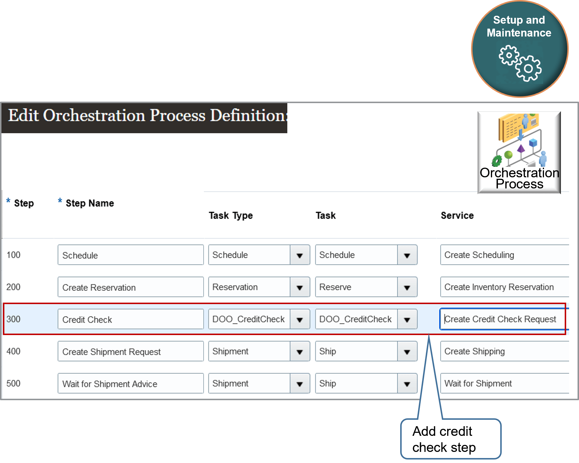

  5. Optional. Set up credit check so it happens during order fulfillment.
Check Credit During Order Fulfillment
In some situations, order fulfillment might require days to complete because of a variety of factors. For example:
  • Inventory is out of stock for the item and requires several days to replenish.
  • The credit that's available for a customer might decrease during this time because the customer continues to make other purchases.
You can add a credit check step at any point in the orchestration process. For example, to happen immediately before shipping. Use this functionality to make sure the credit check is accurate and up to date so you don't ship an item when the customer's credit no longer covers the purchase amount:
enabling credit check to happen during order fulfillment
For example, you can add a credit check step to an orchestration process immediately after the Reserve step, and immediately before the Ship step.
Set these values for the credit check step that you add:
Attribute
Value
Step Name
Enter text that describes the step, such as Credit Check.
Task Type
DOO_CreditCheck
Task
DOO_CreditCheck
Service
Create Credit Check Request
If credit check fails when you run it from the DOO_CreditCheck task, then credit check sets the task to an error state, stops processing order lines, and pauses the orchestration process. To recover, you must set up the Recover Errors scheduled process. Attempting to release a hold won't resume processing.
