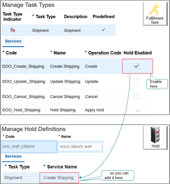

The Order Entry Specialist can select the service when placing a hold on a sales order or order line, such as the shipping service.
If you create your own task type that references the service, then you must set up the task type so it supports the hold:
If you create your own task type that references the service, then you must set up the task type so it supports the hold.
Assume you create your own task type and name it My Shipment. You want to allow the Order Entry Specialist to place the sales order on hold when the order reaches the orchestration process step that references the My Shipment task type.
  1. Go to the Setup and Maintenance work area, then go to the Manage Task Types task.
  2. On the Manage task types page, click Actions > Add Custom, set values, then click Save:
    Attribute
    Value
    Task Type
    My Shipment
    Description
    My Shipment
  3. Click the row that contains My Shipment in the Task Type column.
  4. Click Services.
    Notice that the Manage Task Types page automatically adds a create service and enables it for holds:
