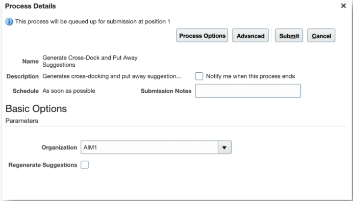

Use the Generate Cross-Dock and Put Away Suggestions scheduled process to regenerate cross-dock suggestions and nudges.
Here's how:
- Click Navigator > Tools > Scheduled Processes.
- On the Scheduled Processes Overview page, click Schedule New Process to
- Leave the type as Job.
- Search for and select the Generate Cross-Dock and Put Away Suggestions process.
- Select the Regenerate Suggestions checkbox to override
existing suggestions and generate new suggestions.
- Click Submit.
