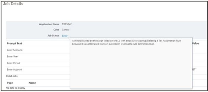

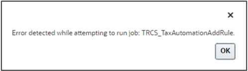

    • Adding a rule when no rule is added in the metadata or adding a rule from the wrong level returns an error message in the job console.
      Adding a Rule from wrong level - Error in Job Console
      Job Status - Error message for wrong additions

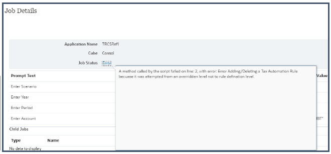

  10. Optional: Right-click the rule name cell to display the menu, and select Tax Automation, and then Delete Rule to delete one rule per account. The Delete rule deletes the selected rule by shifting the rules up from the bottom of the list. Deleting the first row only clears the rule, and the row is not removed.
    Deleting a rule from the wrong level returns an error message in the job console.
    Deleting Rule from wrong level - Error in Job Console
    Job Status - Error message for wrong deletions

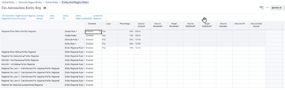

  11. Optional: Under the Disabled column, select any rows you want to exclude from the calculation to Disabled. By default, Enabled is selected for all base entities.
    For example, to override Global and Domicile rules by an Entity rule, set the Global and rules to Disabled, and then enable an Entity Rule to override the other rules and redirect the values.
    Enable or Disable Selection

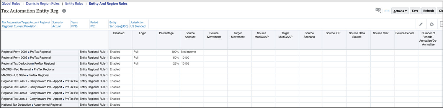

  13. Under Percentage, enter the a whole number or decimal and whole number to represent the percentage of the book data to be copied to the selected entity. For example, for 100%, enter 1, or for 50%, enter .5. The figures display correctly when you exit the cell.
    Enter the percentage of the book data to be copied to the selected entity.
  14. Under Source Account, select the source account number from which you want to copy data. You can select a different Source Account for each rule created for the account.
