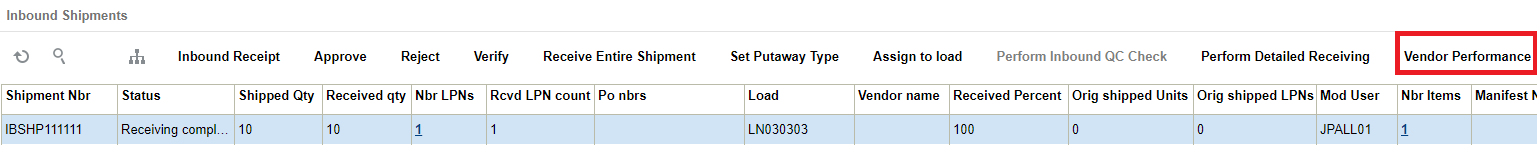

- Go to the “Inbound Shipments” screen.
- Select the ASN that has a compliance issue, and click ‘Vendor Performance’

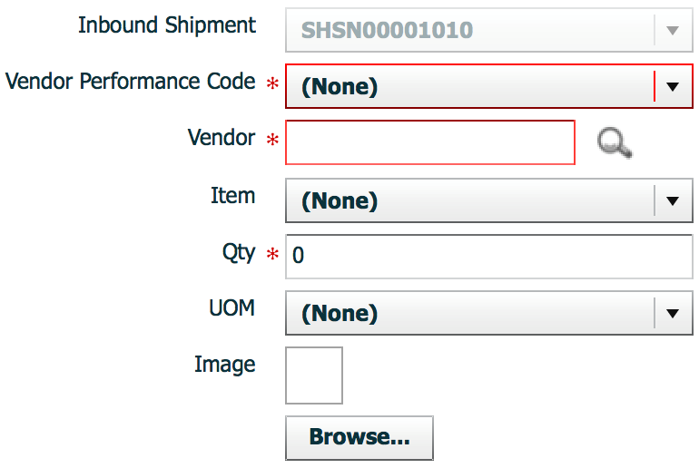

- Click the Create button to add a new vendor performance record.
- Select the appropriate vendor performance code. Note that vendor performance codes must first be configured in the “Vendor Performance Codes” screen.
- Click “Save”.
