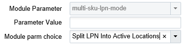

- Configure the directed putaway parameter:
- Go to Direct Putaway UI and choose "multi-sku-lpn-mode" parameter and set to "Split LPN Into Active Locations".
- Set the recalculate-putaway-type to Yes.

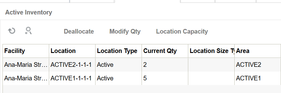

- Check if the item ACT is available in the 2 location in the active inventory
UI:
- Invoke the Direct Putaway transaction, the system allocates maximum units for
each location.

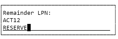

Note: On receiving the IBLPN, the putaway type Active 1 appears automatically. -
You can choose to putaway the remaining units from the IBLPN into the location you choose.

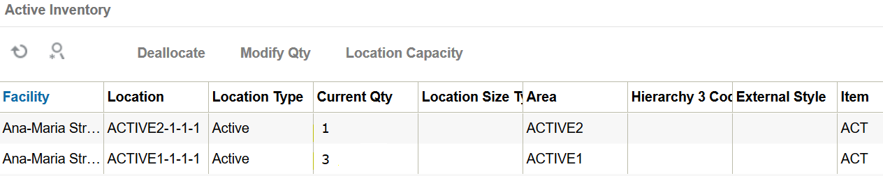

To verify, go to Active and Reserve Inventory UI to view the allocation and current qty.
