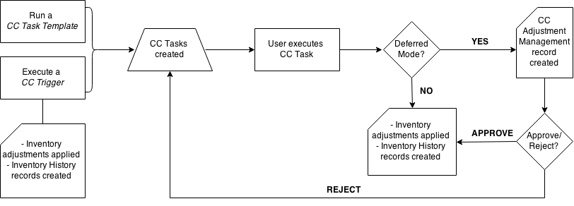

Oracle WMS Cloud allows you to approve/reject inventory adjustments before any real changes are made to warehouse inventory. This process, called the “Deferred Mode”, is enabled at both the Facility and Company levels.
Refer to the following diagram for a high-level process flow of the Deferred Mode:
To enable Deferred Mode for your facility, set the Facility and Company parameters “INVN_ADJUSTMENT_APPROVAL_REQUIRED” to “YES”. If this parameter is set to “NO” at either the facility or company level, the “Immediate Mode” (default) will be enabled – in this mode, Cycle Count inventory adjustments are applied immediately. Note that in 3PL environments, this parameter must be set to “YES” at the child company level. Below are the possible configurations:

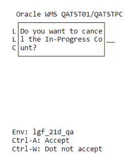

If you are on a break and you need to exit the Cycle Count Location, you will not lose the count. Upon selecting CTRL-X, a prompt with a warning message appears. If you accept the warning message, you can retain the count.
The system allows you to exit the transaction, and cancel the In-Progress count. The following is the warning message you will see:
If you select Ctrl-A, you will cancel your task in progress and Ctrl-W allows you to return to your task in progress.
