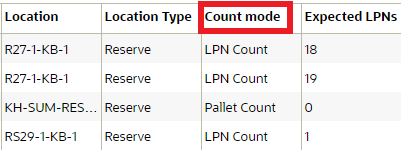

Capture Count Modes for Reserve Locations
Count modes for reserve locations are now available in the Count Mode column on the Summary CC Audit View UI. This allows you to identify and distinguish the audit records for reserve location summary cycle counts with respect to the count context.
Count Mode
Note: The existing summary count audit trail records for reserve locations will also be populated with the correct count mode values.
The Summary Cycle Count transaction (from stand alone or transactional) will capture the count mode from the location count context and populate this count mode to the respective summary audit trail.
The following table describes how the Reserve locations count mode will be populated in the Summary Cycle Count UI:
Count Mode Description
Pallet count A fully palletized location where users count the number of pallets for the location.
LPN count A non-palletized /partial palletized location where users count the number of LPNs for the location.
Pallet scan A fully palletized location where users scan the pallets and enter the number of LPNs within the scanned pallet (Pallet scan mode.)
