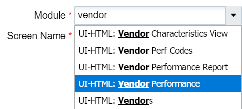

  2. From the “Screen Configuration” screen, search “Vendor Performance” in the module field to add the “Vendor QC” screen (called “Vendor Performance” in Oracle WMS Cloud):
    Vendor Performance
  3. Add this screen to the appropriate Menu

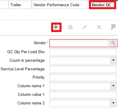

  4. Go to the “Vendor QC” screen.
  5. For each Vendor that requires QC validations, create a new record by clicking the Create button ().
  6. For each Vendor QC record, populate the following fields:
    Adding a new Vendor for QC
    1. Vendor: Populate the Vendor that will be used for QC. Use the magnifying glass to display a list of Vendors currently in the system.
    2. QC Qty Per Load SKU: Enter a value that will be checked for QC.
    3. Count or percentage: Enter a “U” for count and “P” for percentage.
    4. Service Level Percentage: Also known as ‘Reception Percent Level’, this parameter is used for advanced LPN distribution to ensure the inventory is evenly distributed to multiple stores.

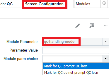

  8. Configure the RF modules that will be used in QC. First, enable the receiving RF module to recognize LPNs for QC.
    1. From the ‘Screen Configuration’ screen, select an RF receiving module that will capture QC and click on Details.
    2. If you have a Quality Control location, set the Module Parameter ‘qc_handling_mode’ to ‘Mark for QC prompt QC locn’. If you do not have a Quality Control location, select the parameter and click the ‘Edit’ button in order to update this parameter.
      Enabling the QC check in the Receiving RF module
    3. Click “Save”.

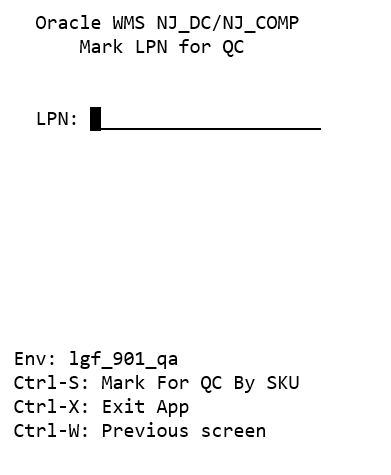

  9. The Mark LPN for QC transaction allows you to randomly select LPNs from a shipment to be marked for quality control. You can use Mark LPN for QC for cartonized shipments, and users/supervisors can select the LPNs that they would like to designate for QC.
    Mark LPN for QC

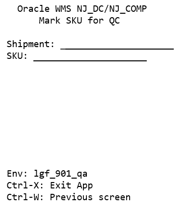

    If you need to do quality control for all of the inventory for a specific SKU, select the hot key Ctrl-S. Ctrl-S will mark the shipment detail for quality control. Once you select Ctrl-S, the Mark SKU for QC screen displays:
    Mark SKU for QC

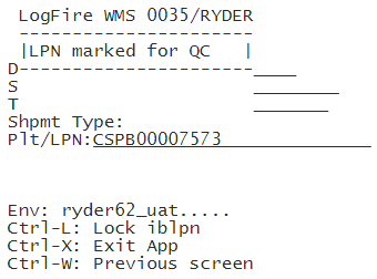

    The Mark SKU for QC transaction does not support scanning an LPN which has already been received. If the LPN has already been marked for QC, the LPN is part of a shipment, and the status is Verified, the error “Scanned LPN is not valid for QC” displays.
    If the LPN meets the criteria, the system displays the message “LPN% marked for QC”. The marked for qc flag on the inbound shipment detail for the corresponding LPN will be set to yes.
    LPNs or inventory designated for QC will be marked “Yes” on the marked for qc flag in the Inbound Shipment detail.

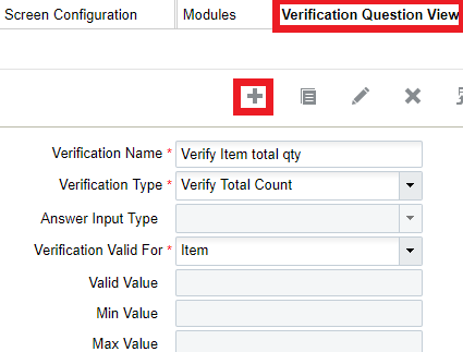

  10. You can use the Verification Questions UI to set up Verification questions to use during RF QC Complete.
    Table 1. Verification Questions UI
    Fields Description
    Verification Name What you want to call your verification questions.
    Verification Type Allows you to verify total count, standard case, standard pack, or user-defined verification question.
    Answer Input Type Allows you to set the answer input type. The Answer Input Type options include the following:
    • Yes/NO
    • Text
    • Date
    • Decimal
    • Integer
    • Yes
    Verification Valid From Can be for Item or LPN.
    Valid Value Allows you to specify valid value.
    Min Value Allows you to specify minimum value.
    Max Value Allows you to specify maximum value.

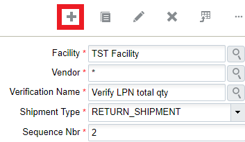

  11. The verification question must be assigned to a vendor in order for the right questions to be asked during QC confirmation.
    Next, go to the Verification Question Configuration UI and click Create to set up the Verification Question Configuration.
    You can associate questions to the following items:
    • Facility Type
    • Vendor Type
    • Verification Name
    • Shipment Type
    • Sequence Number
    Questions will be displayed in the sequence set up in this screen.

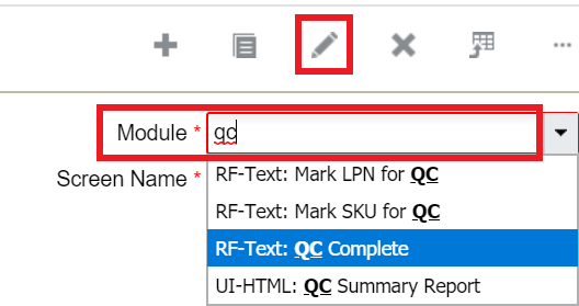

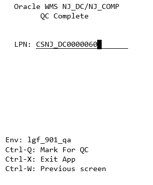

  12. Configure the RF module for processing the LPNs for QC.
    1. Go to the ‘Screen Configuration’ screen.
    2. Add a new RF screen with the Create button ().
      QC Complete
    3. Add this new RF screen to the appropriate Menu.
      Table 2. QC Complete
      Parameters Description
      qty-entry-mode None/Sku-Qty/Sku-Scan
      qty-uom None/Units/Packs/Cases
      distribute-lpn-transaction Valid Transaction name to call distribute LPN when QC passes or the LPN is accepted
      prompt-vendorperf-code None/No/Yes

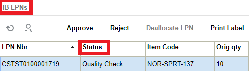

  3. At that point, the LPN will be updated to status “Quality Check” in the “IBLPN” screen:
    LPN in “Quality Check” status
    Note: This will NOT add inventory to the warehouse until the LPN has been approved.

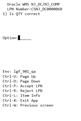

  3. Press Ctrl-P to mark the LPN to be ready for QC:
    Approve/Reject LPN
    You can answer all of the questions set up in the verification question view, and also use the control options to approve or reject LPNs.
  4. Press Ctrl-P to approve and Ctrl-R to reject.
    1. If the user enters Ctrl-R to REJECT, the RF will display a confirmation message. Press Ctrl-A to proceed.
    2. If the user enters Ctrl-P to APPROVE, the RF will display a confirmation message. Press Ctrl-A to proceed.

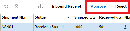

Processing LPNs from the UI
  1. From the Inbound Shipments screen, select the ASN with QC LPNs.
  2. Clicki either “Approve” or “Reject.” This will affect ALL QC LPNs in the shipment.
    Select Approve or Reject

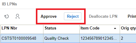

  3. From the IBLPN screen, select the IBLPN that is in “Quality Check” status.
  4. Click either “Approve” or “Reject” to process it.
    IBLPN in Quality Check Status
