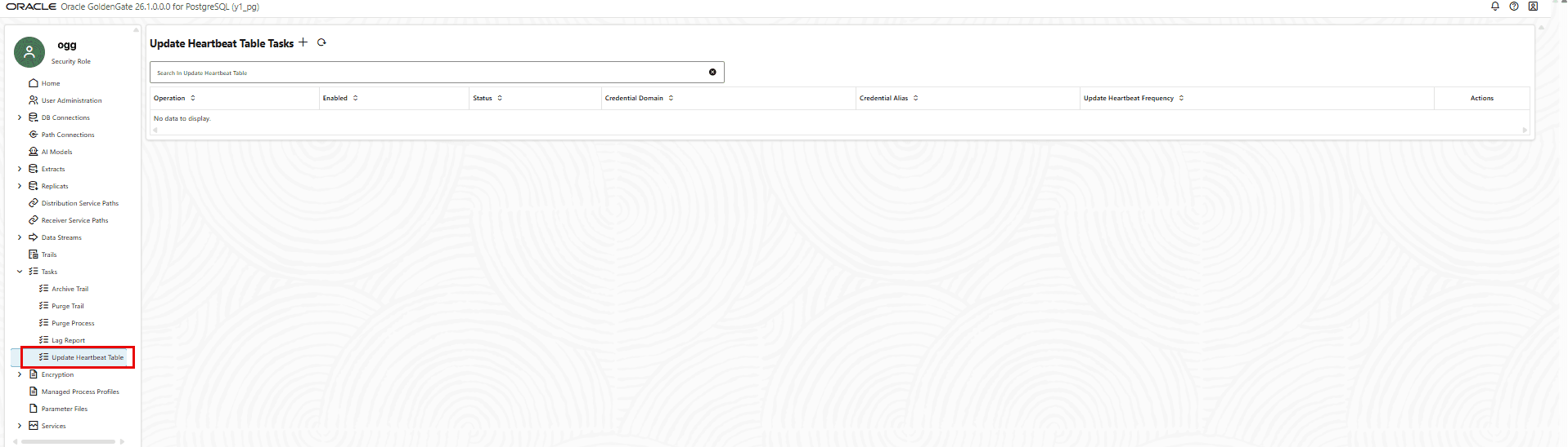

Following are the steps to create this task from the web interface:
  1. From the left-navigation pane, expand Tasks and select the Update Heartbeat Tasks option.
    Automation Task option to update heartbeat for PostgreSQL

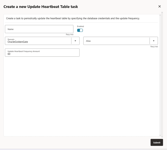

  2. Click the plus sign on the Update Heartbeat Tasks page. The Create a New Heartbeat Task dialog box is displayed.
    Create a new Update Heartbeat Task dialog box with options to choose database credential alias, domain, and specify a frequency interval for performing the automatic update of the heartbeat table.
  3. Specify the following values in the dialog box and click Submit:
    • Name: Specify a name for the task.
    • Credential Domain: Select the domain name from the drop down list.
    • Credential Alias: Select the credential alias for the PostgreSQL database instance for which you are creating the update heartbeat task.
    • Frequency Interval: Specify the frequency interval for running the update task. The minimum value is 60 (default) and the maxium value can be set to 7999.
