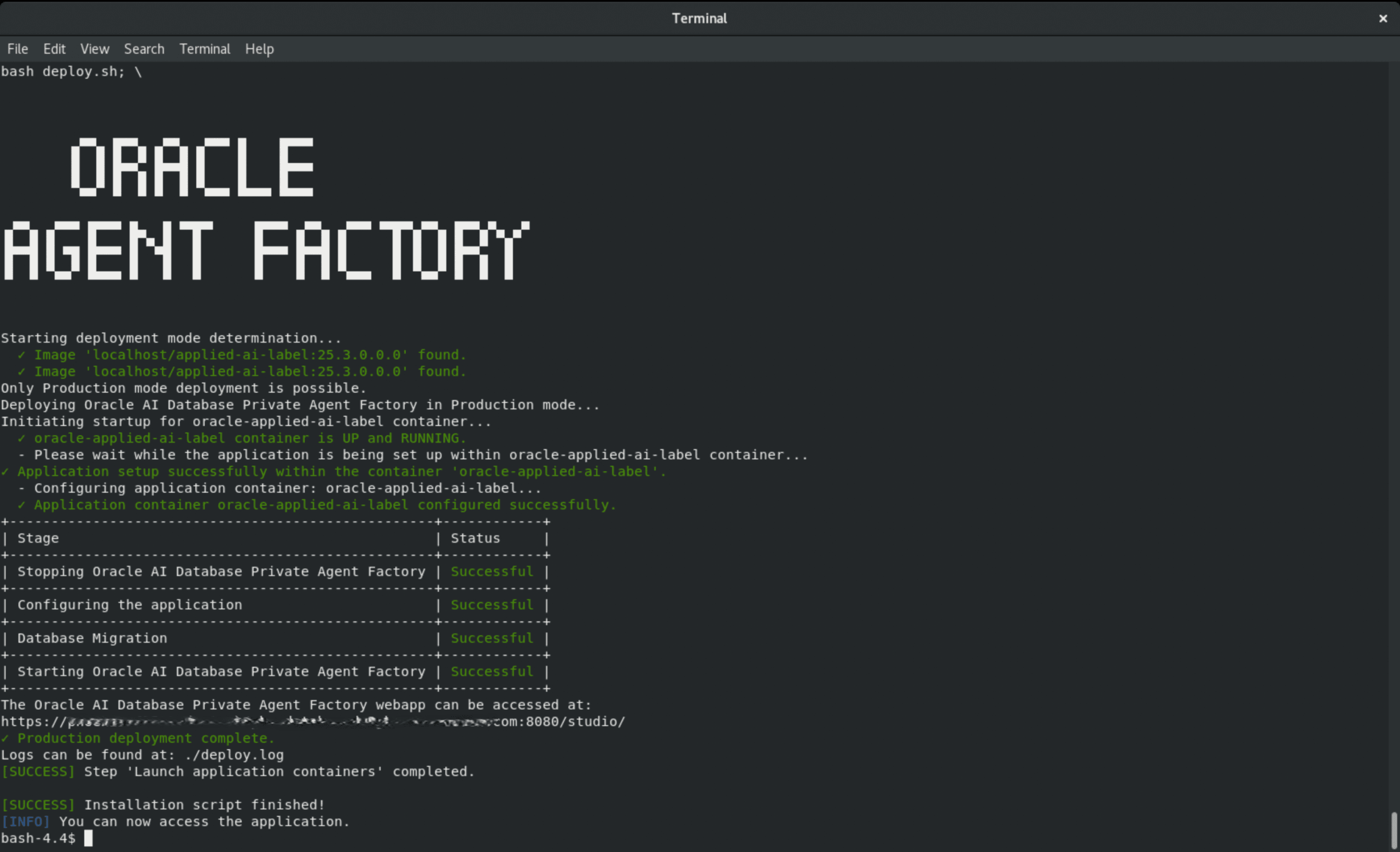

The following output indicates that the installation was completed successfully.
Once the installation script finishes successfully, you can access the application at the URL https://<hostname>:8080/agentFactory/ provided by the script and complete the remaining configuration through your web browser.

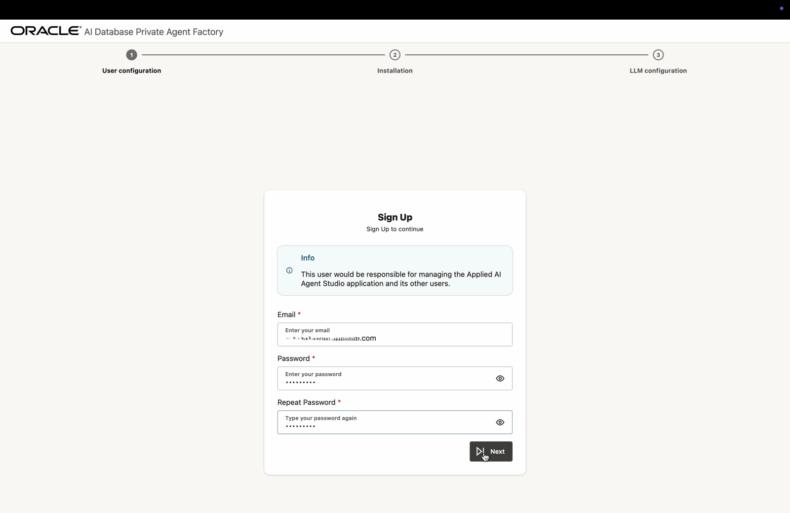

Configure User
Set up an email and a secure password.

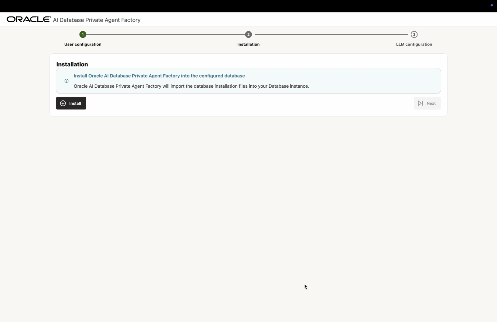

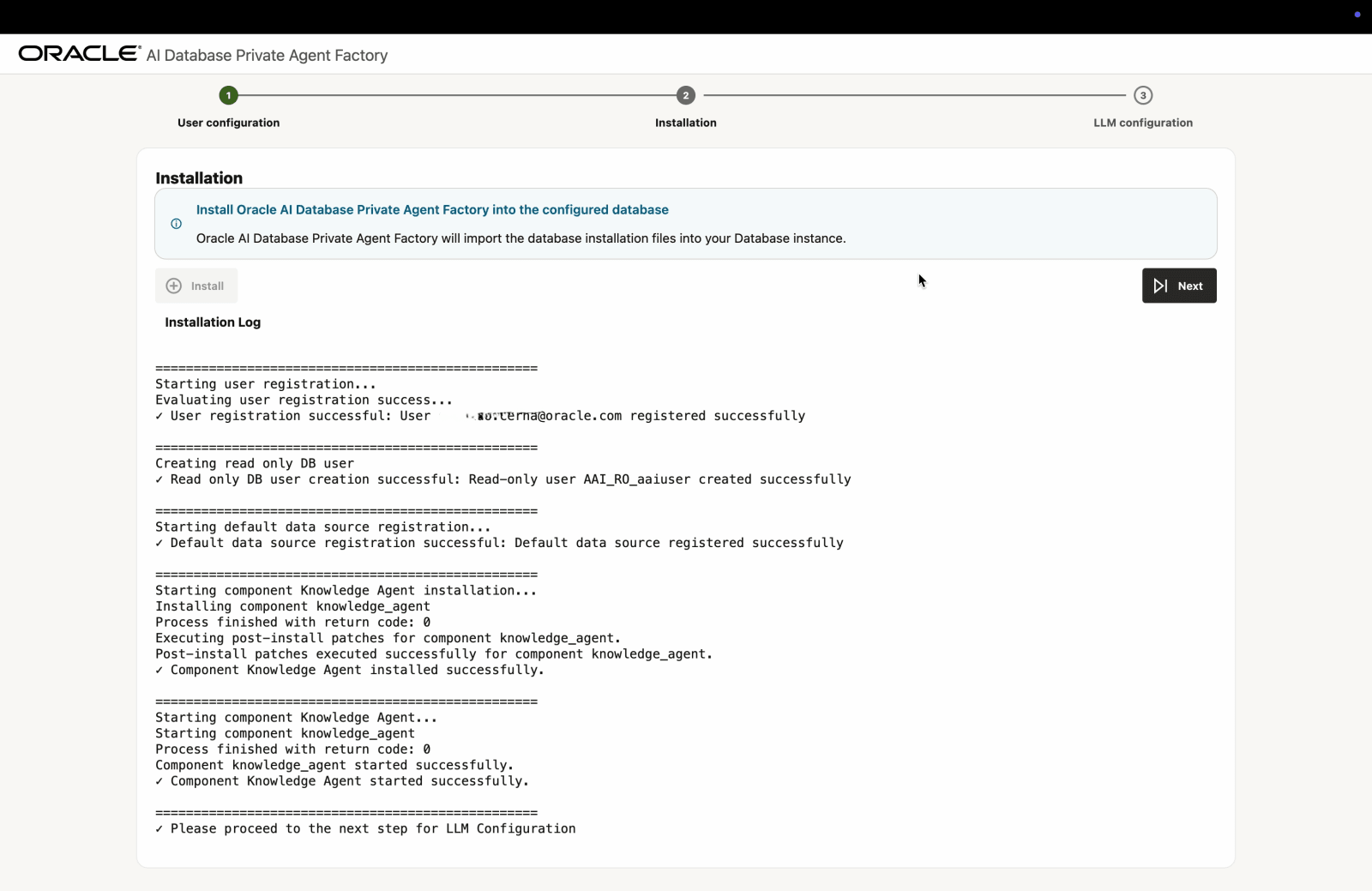

Install Components
Click Install and wait a few minutes for the setup to complete.
When finished, you will see the message ✓ Please proceed to the next step for LLM Configuration. Click Next.

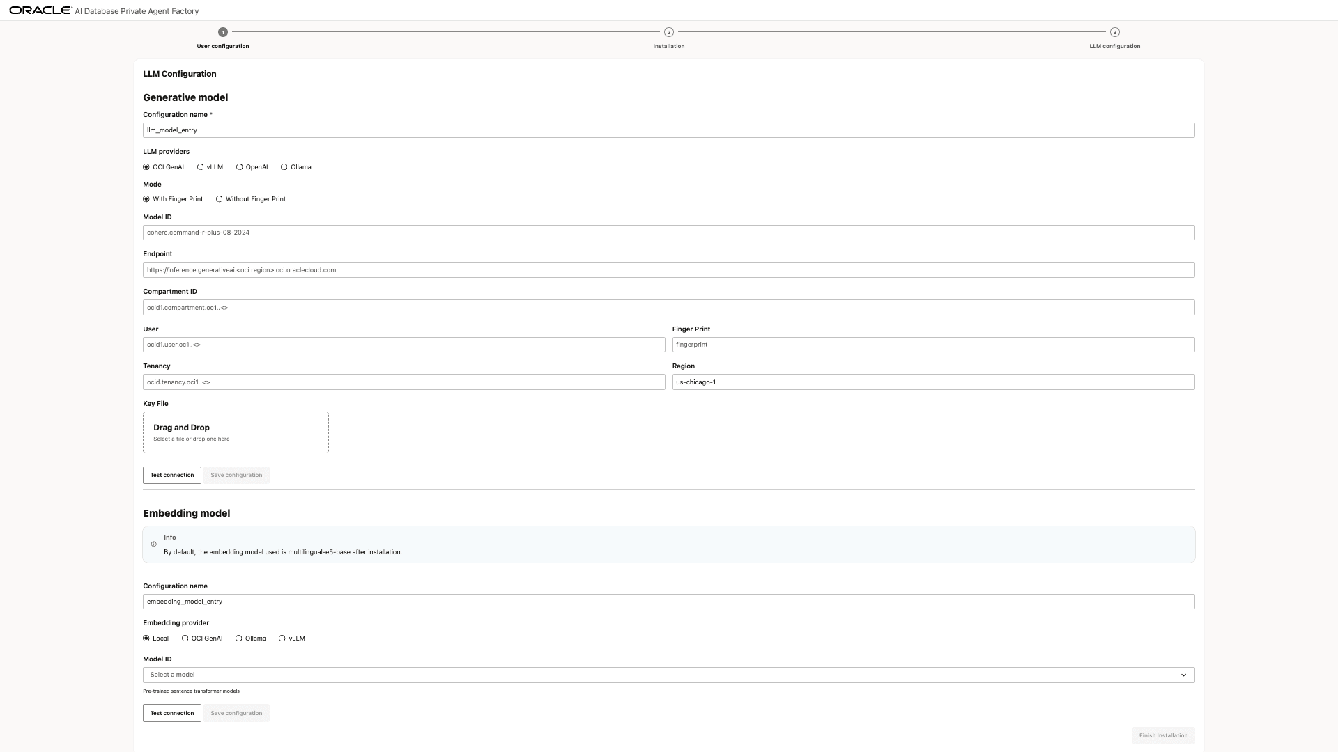

Configure LLM
Before you continue, see Manage LLM to review the supported models and LLM providers, and how to set them up.
Select an LLM configuration based on your LLM provider. The application supports integration with Ollama, vLLM, OpenAI, and the full suite of OCI GenAI offerings. Depending on your selected provider, the required connection credentials may differ.
Enter the required details in the selected LLM configuration and select Test Connection. Once you see the Connection successful message, select Save Configuration.
Optionally, configure an embedding model to use for data ingestion and retrieval. By default, multilingual-e5-base model is used to generate embeddings and is also the local embedding model included with the service. If you choose OCI GenAI as the embedding provider, note that the following embedding models are supported for Knowledge Agents.

Install Components

Now that the kit is unpacked, execute the
interactive_install.shscript from within the same directory.bash interactive_install.sh --reset (Required if previously installed) bash interactive_install.sh -
When the interactive installer prompts you, select the option:
Are you on a corporate network that requires an HTTP/HTTPS proxy? (y/N): n Do you want to use the default specs? (Y/n): y Do you want to proceed with the manual database setup? (y/N): n Select installation mode: 1) prod 2) quickstart Enter choice (1 or 2): 2 You selected Quickstart mode. Confirm? (yes/no): yes

Configure User
Install Components
Configure LLM
- cohere.embed-v4.0
- cohere.embed-english-v3.0
- cohere.embed-multilingual-v3.0
- cohere.embed-multilingual-light-v3.0
Finally, select Finish Installation to complete the setup and be redirected to the login page.
