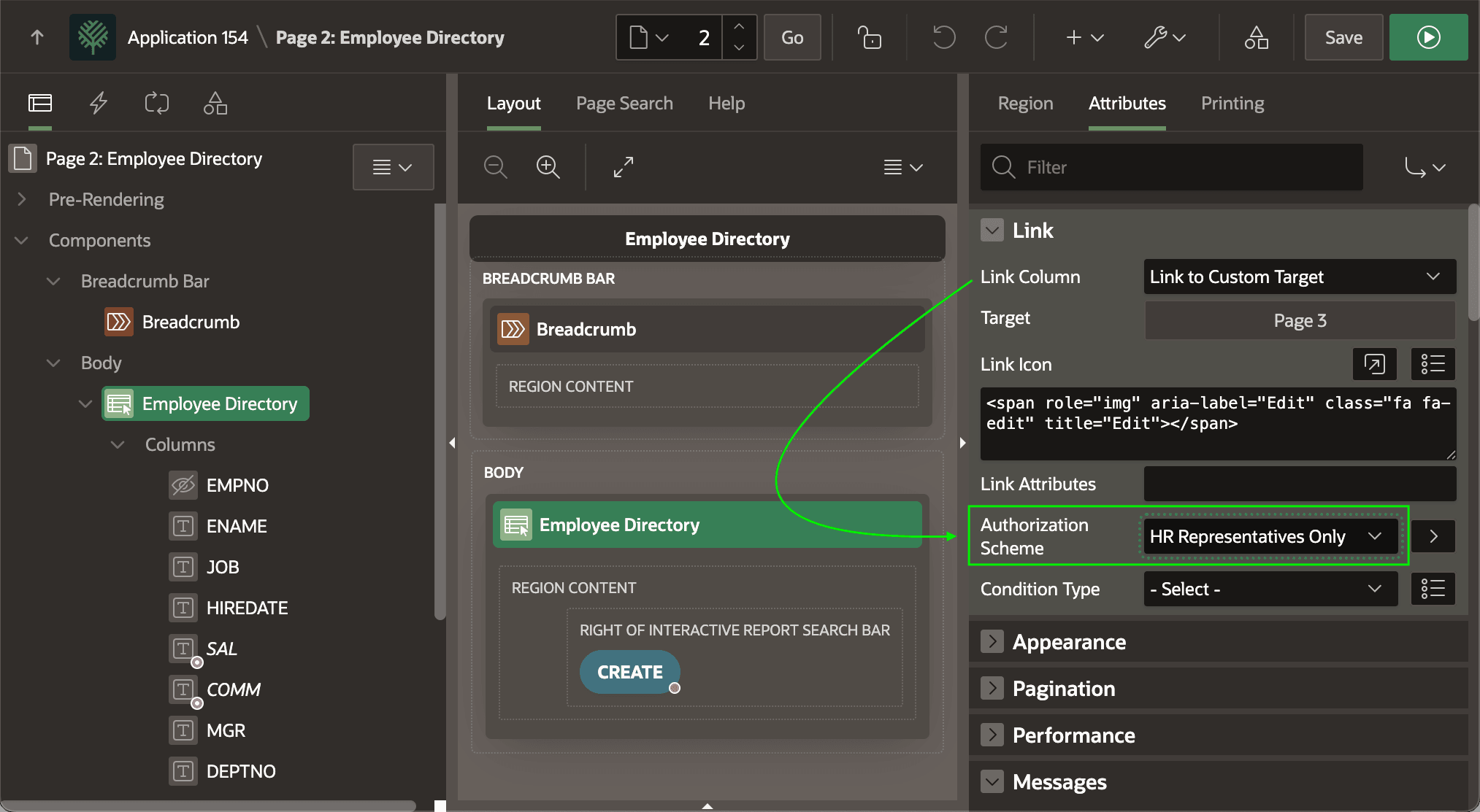

Set an Authorization Scheme on the edit link of an Interactive Report to control who can see it
As shown below, in the Employee Directory page, you set the Authorization Scheme of the Link Column to HR Representatives Only. This lets HR Reps see and click on this link to edit an existing employee. In contrast, any other users viewing the directory do not see the column at all, so they can't edit employees.
Tip:
The Employee page the edit link targets also has a page-level authorization scheme of HR Representatives Only. So any manual attempt by unauthorized users to visit that page results in an error.
Figure 11-14 Applying Authorization Scheme to an Edit Link Column
