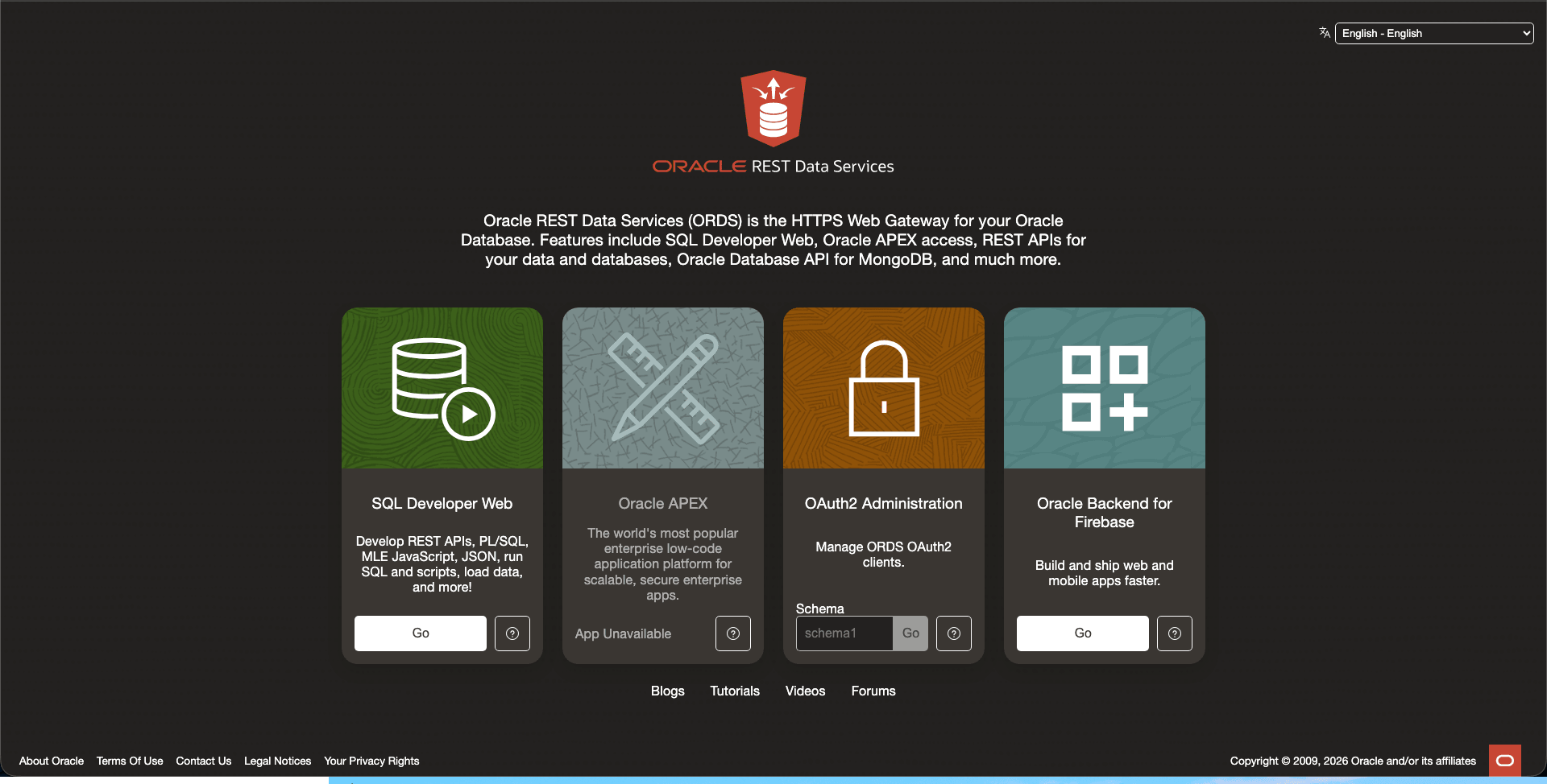

ords --config /opt/ords-config serveThen, open http://localhost:8080/ords/_/landing in your
browser. Replace the host and port if ORDS is running elsewhere. On the landing page,
open the Oracle Backend with Firebase APIs tile and sign in with the
fusabase_user credentials.
Figure 3-1 ORDS Landing Page

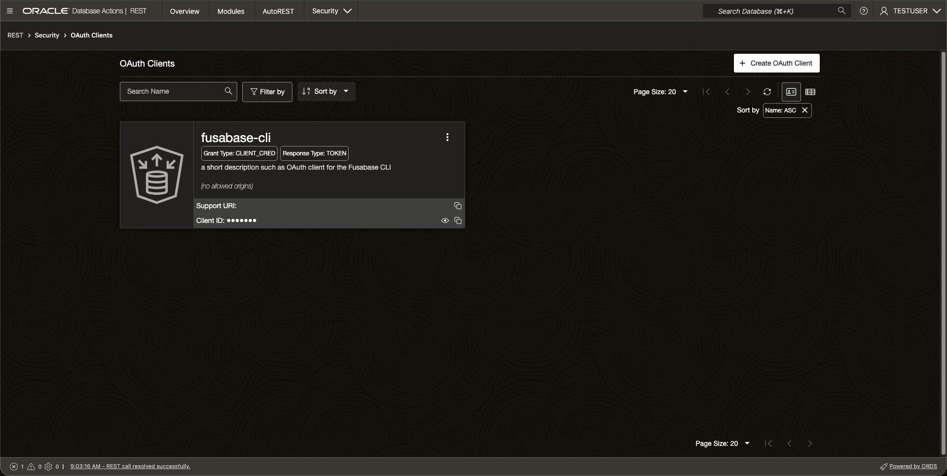

3.8.2 Create an OAuth Client for the CLI

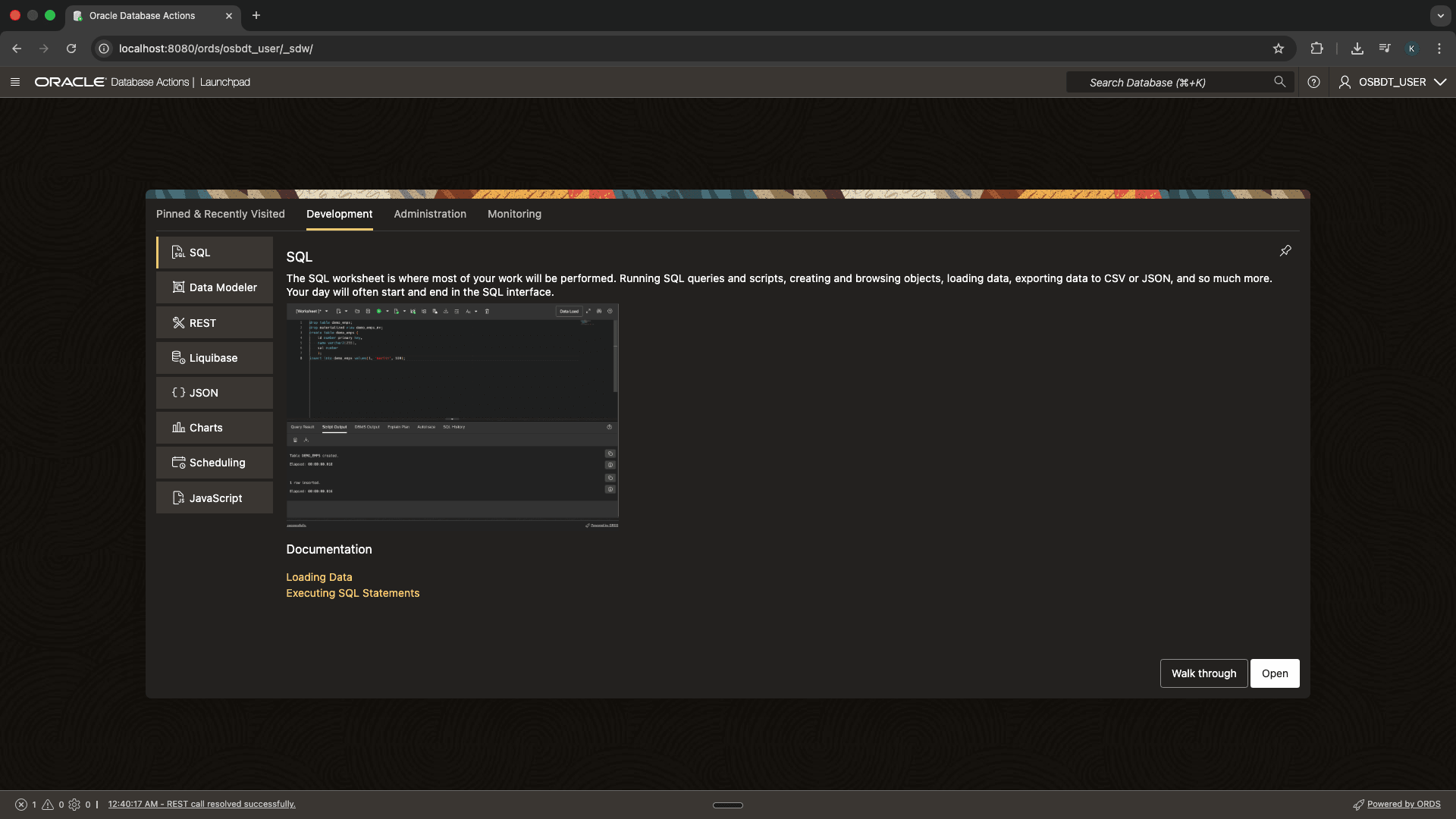

Open Database Actions for the schema you enabled for Oracle Backend with Firebase APIs.
Figure 3-2 Database Actions Launchpad

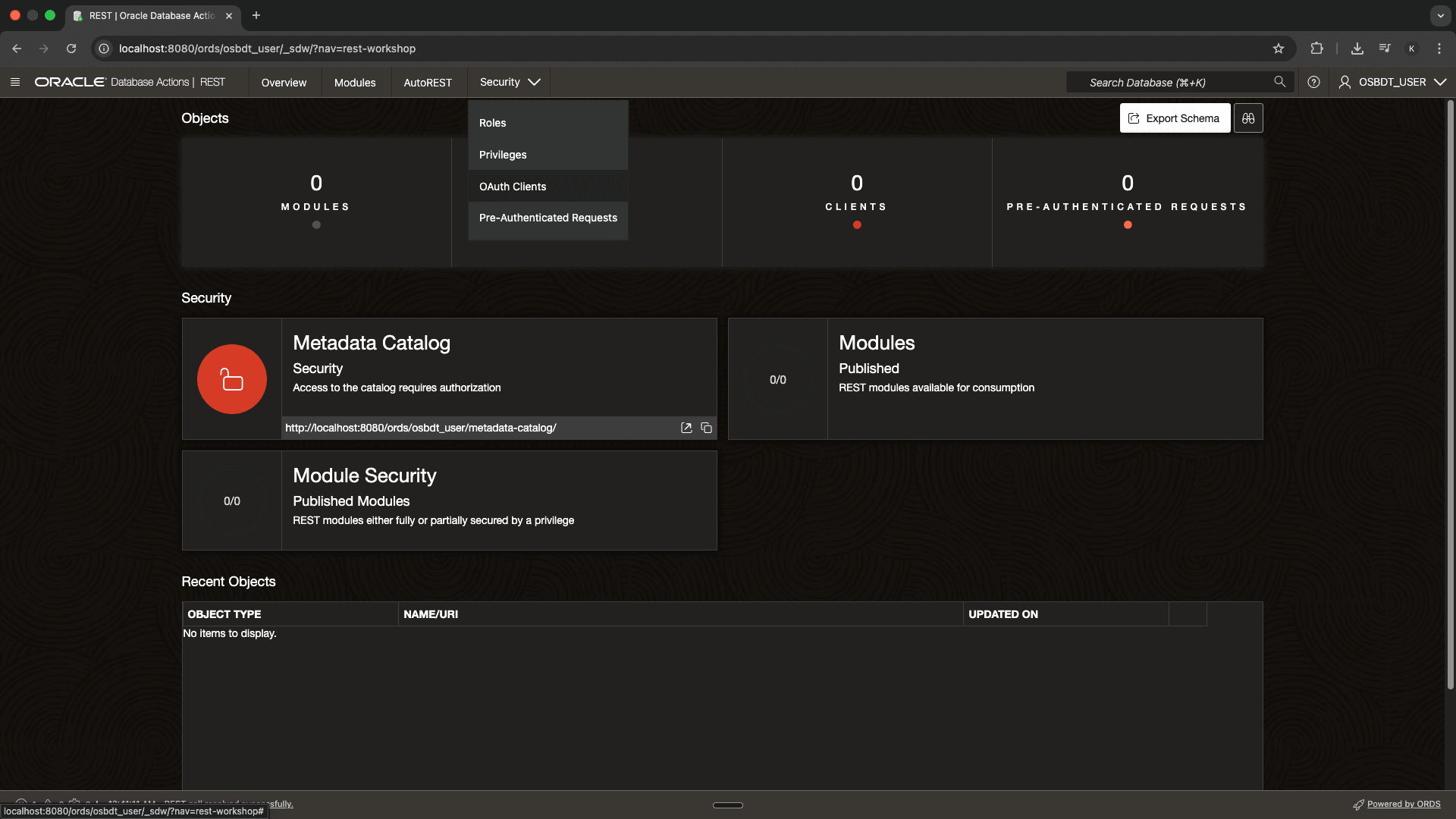

Open REST, then open Security and select OAuth Clients.
Figure 3-3 REST Security Options

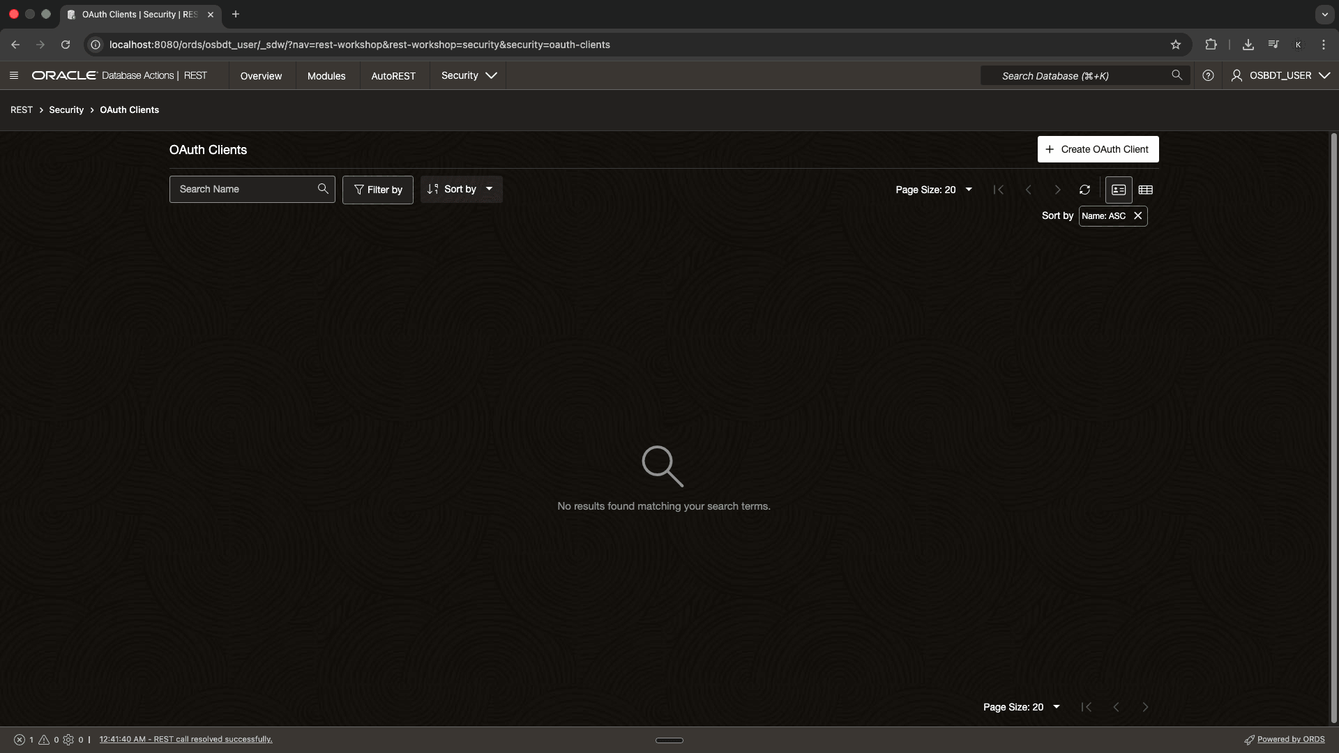

Select Create OAuth Client.
Figure 3-4 Create OAuth Client

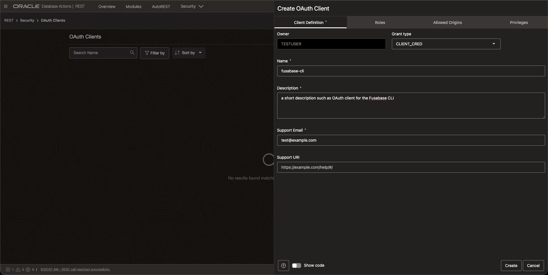

Create the OAuth client with values for your environment. The example shown here uses:
- Grant type:
CLIENT\_CRED - Name:
fusabase-cli - Description: a short description such as
OAuth client for the fusabase CLI - Support Email and Support URI: values appropriate for your environment
- Grant type:
On the Roles tab, grant the SQL Developer role to the client to enable the required administrative API calls through the CLI.
Figure 3-5 Grant SQL Developer Role

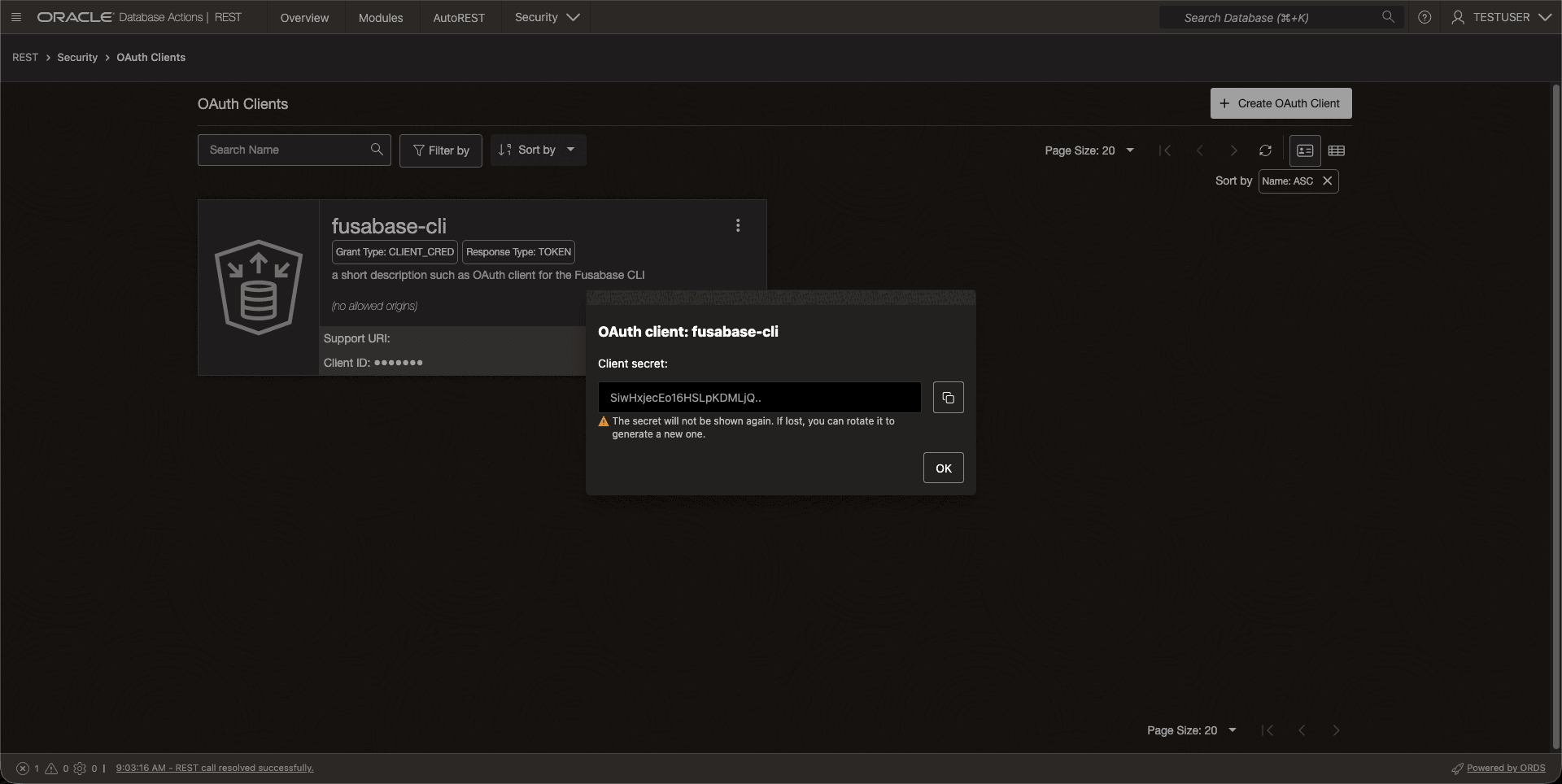

After you create the client, copy and save the Client ID and Client Secret.
The Client Secret is only shown once. Copy the Client Secret when it first shown.Figure 3-6 Client Secret
You can return to the OAuth client card later to copy the Client ID again, if required.
Figure 3-7 OAuth Client Card
Parent topic: Configure the CLI

3.8.4 Sign In to the CLI
From that same directory, run:
fusabase initWhen prompted, enter the OAuth Client ID and Client Secret for the ORDS
OAuth client you created in Database Actions. The CLI uses these credentials to request
an access token and sign in to ORDS. If the host value in
fusabase.config.js is correct and the OAuth client credentials are
valid, the CLI reports a successful login.
