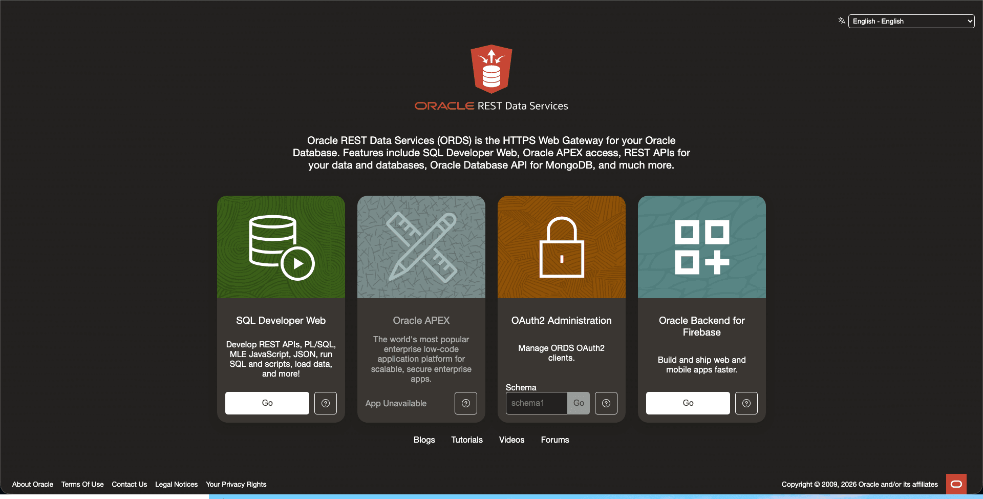

Then, open http://localhost:8080/ords/_/landing in your browser. Replace the host and port if ORDS is running elsewhere. On the landing page, open the Oracle Backend with Firebase APIs tile and sign in with the fusabase_user credentials.
Figure 3-1 ORDS Landing Page

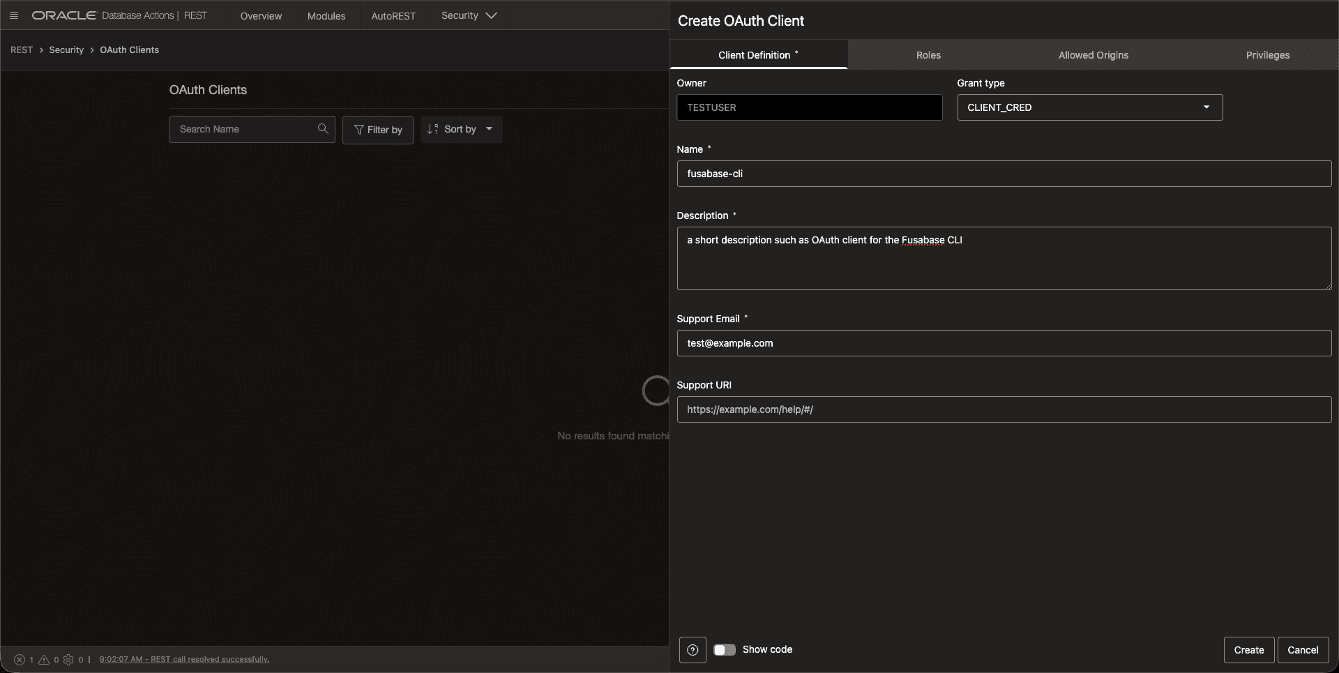

Create an OAuth Client for the CLI

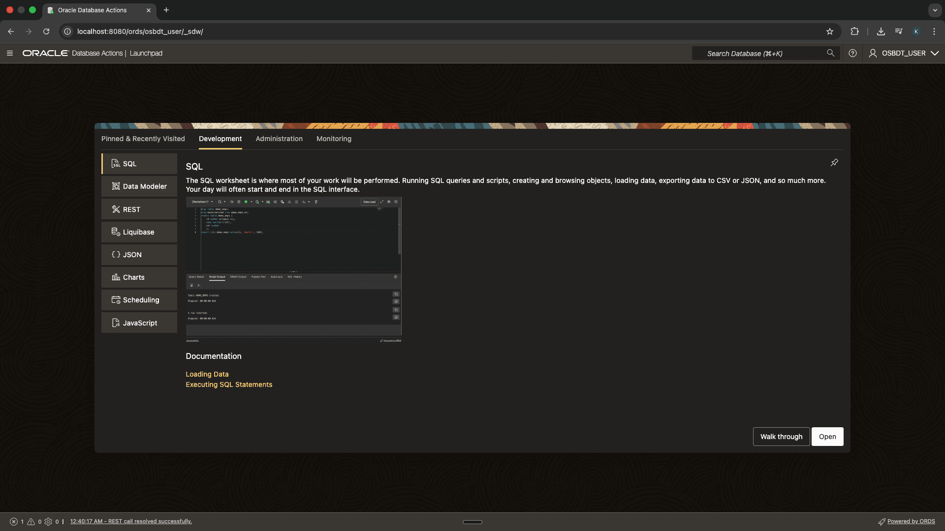

Open Database Actions for the schema you enabled for Oracle Backend with Firebase APIs.
Figure 3-2 Database Actions Launchpad

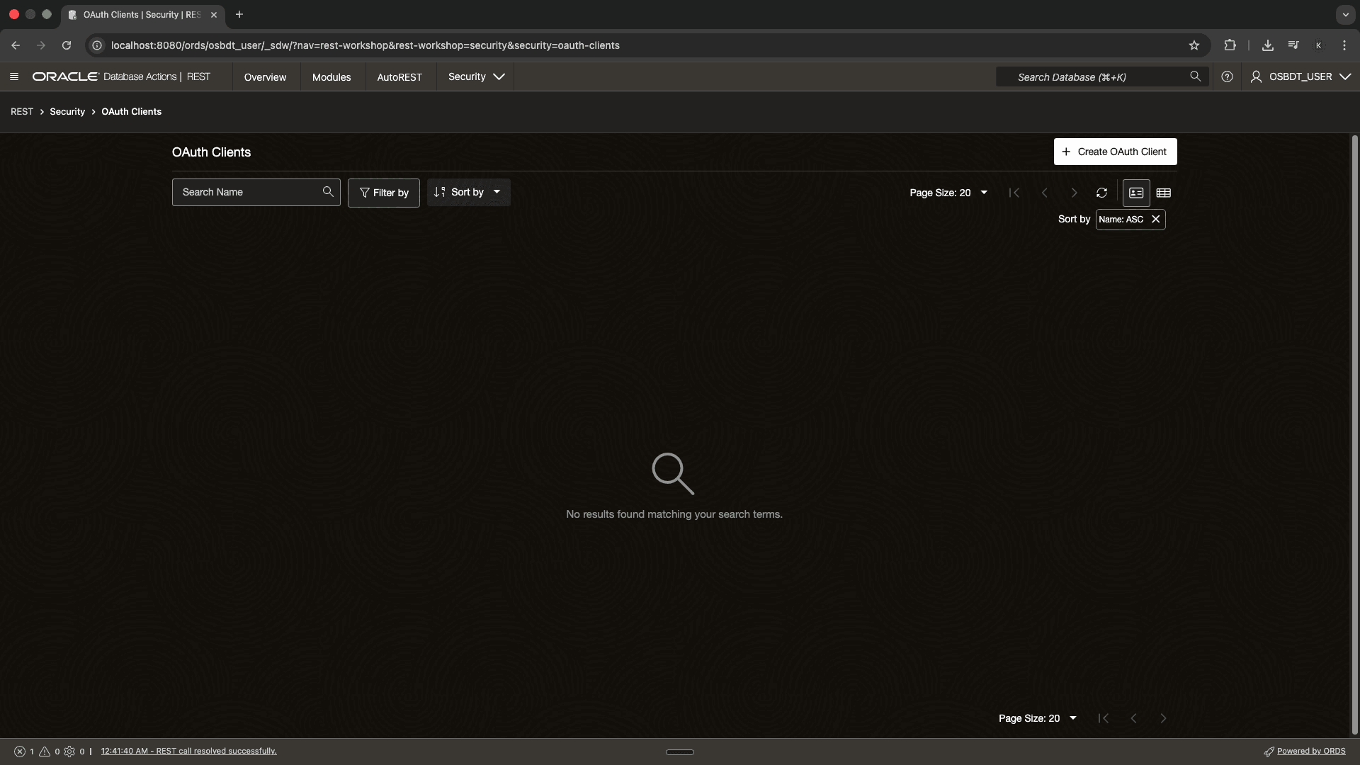

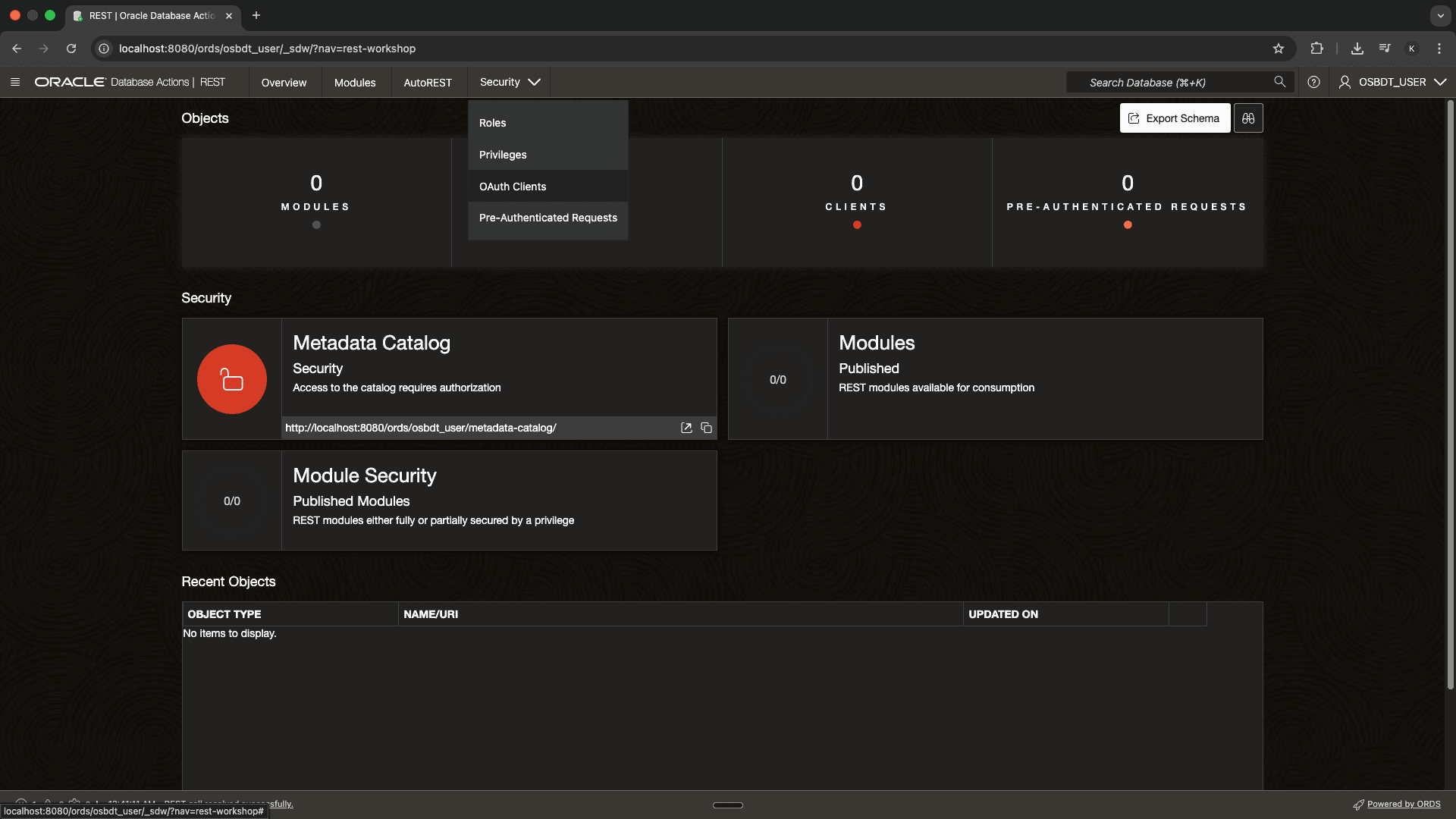

Open REST, then open Security and select OAuth Clients.
Figure 3-3 REST Security Options
Select Create OAuth Client.
Figure 3-4 Create OAuth Client
Create the OAuth client with values for your environment. The example shown here uses:
Grant type:
CLIENT_CRED -
Name:
fusabase-cli -
Description: a short description such as
OAuth client for the fusabase CLI -
Support Email and Support URI: values appropriate for your environment

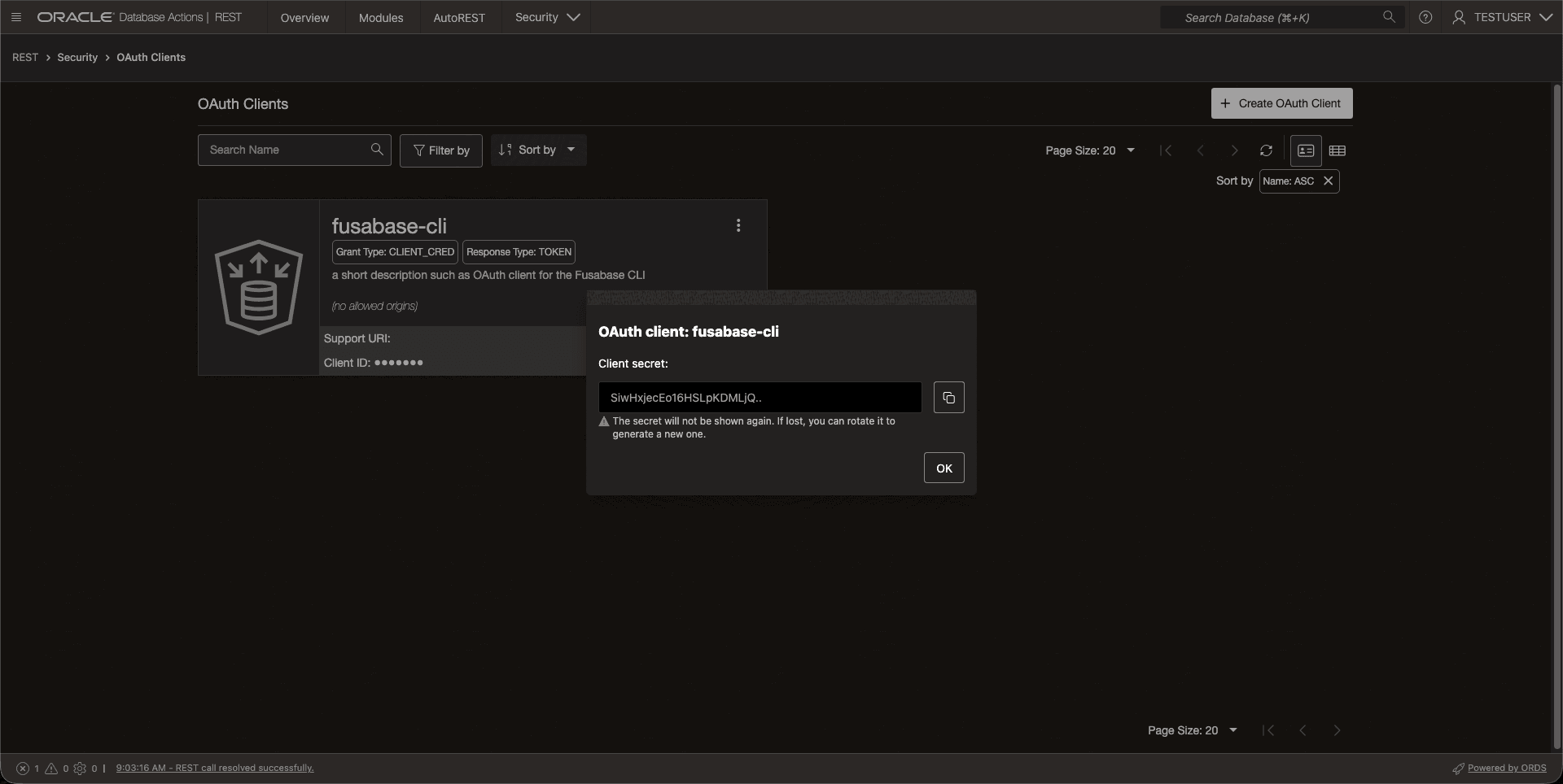

After you create the client, copy and save the Client ID and Client Secret.
Note: The Client Secret is only shown once. Copy the Client Secret when it first shown.
Figure 3-6 Client Secret

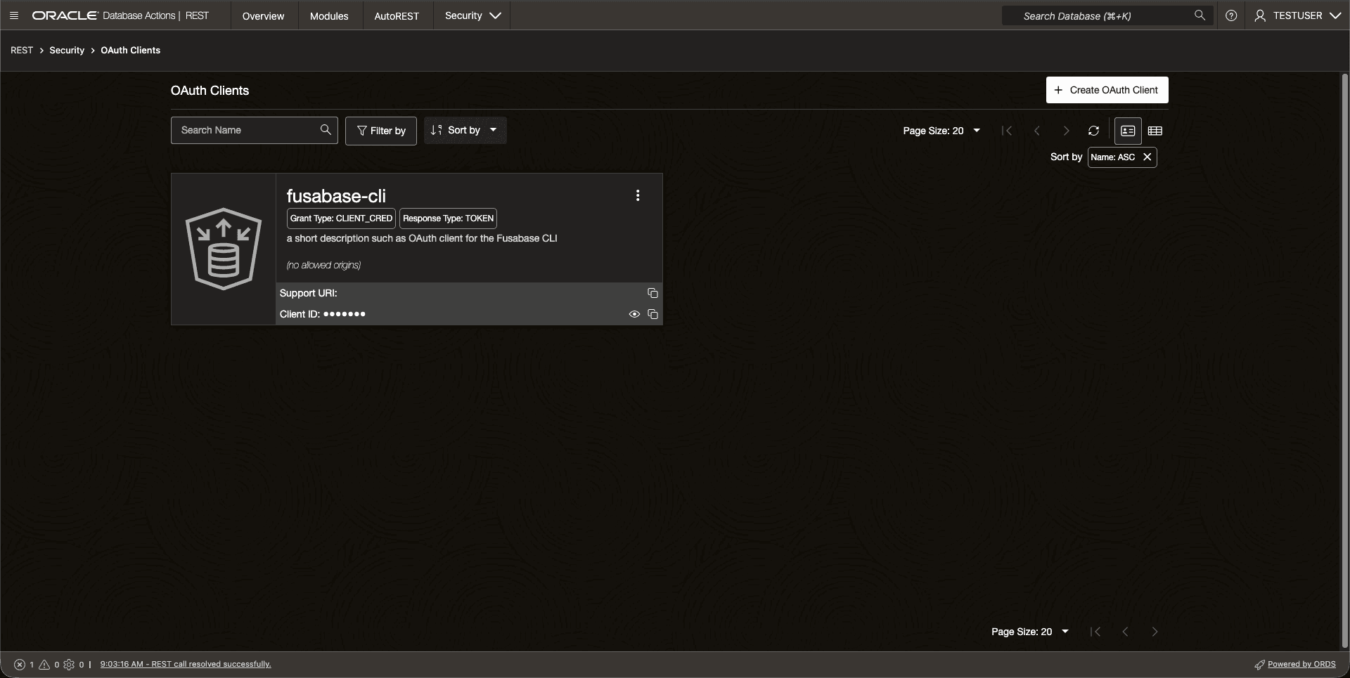

You can return to the OAuth client card later to copy the Client ID again, if required.
Figure 3-7 OAuth Client Card

CLI authentication fails: Verify that you copied the correct OAuth Client ID and Client secret, and confirm that the OAuth client has theSQL Developer role.
