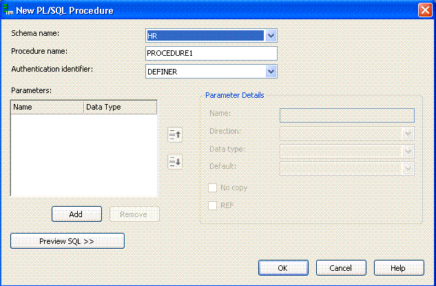

In Server Explorer, right-click the Procedures node and from the menu, select New PL/SQL Procedure.
The Procedure Designer appears as follows:
Using the Procedure Designer
In general, use the Procedure Designer to create a template for the procedure. The template contains parameters for the base definition of the procedure, but not more elaborate code such as statements to add within the template's BEGIN and END statements. After you create this template, you can customize it in the PL/SQL Code Editor.
The controls in the Procedure Designer are as follows:
| Control | Description |
Schema name |
Select from the list of available schemas in which to create the procedure. |
Procedure name |
Enter a name for the procedure. |
Authentication identifier |
Select from the following choices:
Parameters |
Lists the parameters and their data types used in this procedure. To create a new parameter, click Add, and then use the Parameter Details pane to modify the parameter as needed. As you create parameters, their PL/SQL code appears in the SQL Preview box. To modify the order of parameters, select the parameter to move and click the Up or Down arrow. To remove a parameter, select it and click Remove. |
Parameters detail |
Displays detailed information about the selected parameter:
Preview SQL |
Displays the |
OK |
Saves your work, creates the procedure with the template code in the database, and displays the procedure template code in the PL/SQL Code Editor so that you can customize it. To commit the changes to the new procedure template, click the Save button in the Visual Studio .NET toolbar or select Save from the File menu. If you have created the procedure with errors, Oracle Developer Tools displays an error dialog box, and then displays the error messages in the Output window. Click OK and correct the error in the Procedure Designer. Afterwards, when you click the designer's OK button to save your changes, click Yes to replace the incorrect function with the corrected version. After you successfully create the procedure, Oracle Developer Tools displays its node in Server Explorer. |
