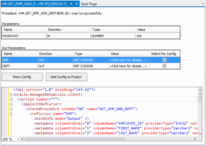

Viewing the Results from Running a Procedure or Function
Whenever you run a procedure or function, its results display in a new window. The results window appears similar to the following:
Using the Run Dialog Results Window
The controls in the Run Dialog Results Window are as follows:
Control Description
Parameters
Lists the input parameters that were entered into the Run Stored Procedure Dialog Box. The name, direction, type and value appear.
Out Parameters
Lists the output parameters exposed by this stored procedure or function. The name, direction, type and value appear. Each parameter of type REF CURSOR appears as a link, which you can click to display its value. For all other data types, the values are displayed inline with a maximum of 4000 characters shown. User Defined Types are displayed in XML format and include only the first level of nestedness. The Select for Config check box appears for output parameters of type REF CURSOR only. If this check box is selected, the REF CURSOR metadata information for this parameter is included when the Show Config or Add Config to Project buttons are pressed.
Show Config
Only appears for procedures or functions that include output parameters of type REF CURSOR.
Displays the metadata information for the procedure or function.
Adds the metadata information for the procedure or function to the app.config or web.config file of the Visual Studio project. If the metadata information already exists in the config file for this stored procedure or function, an overwrite confirmation dialog appears. If there is no project open, an error is displayed.
