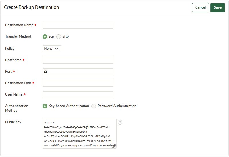

21.2.2 Creating a Remote Backup Destination
You can use the Oracle Key Vault management console to create a remote backup destination.
To create a remote backup destination, you must provide a user account, a unique existing directory location on an external server, and an authentication method (password or key-based). Oracle Key Vault needs this information to make a secure connection with the remote server.
  1. Log in to the Oracle Key Vault management console as a user with the System Administrator role.
  2. Select the System tab, and then Settings from the left navigation bar.
  3. In the System Configuration area, click Backup and Restore.
  4. In the System Backup page, select Manage Backup Destinations.
  5. Click Create.
    The Create Backup Destination window appears.
    Description of 218_create_backup_dest.png follows
  6. Enter the following information for the backup location:
    • Destination Name: Enter a descriptive name to identify the backup destination.
    • Transfer Method: Choose between scp and sftp to copy files to the remote destination.
    • Policy: Select the backup policy from the list.
    • Hostname: Enter the host name or IP address of the remote server for the backup destination. If you enter the host name, then ensure that DNS is configured to translate the host name to its corresponding IP address. Do not include spaces, single quotation marks, or double quotation marks in a host name that is in a remote backup destination.
    • Port: Enter the SCP or SFTP port number on the external server. The default is 22.
    • Destination Path: Enter the path to an existing directory on the external server where the backup file will be copied. You cannot modify this directory location after the backup destination is created. This path must not be the destination for backups from another Oracle Key Vault server. Do not include spaces, single quotation marks, or double quotation marks destination path that is in a remote backup destination.
    • Username Enter the user name of the user account that can be used to establish an SCP or SFTP connection to the remote server. Ensure that this user has write permissions on the directory that is specified in Destination Path. Do not include spaces, single quotation marks, or double quotation marks in a user name that is in a remote backup destination.
    • Authentication Method: Choose one of the following:
      • Key-based Authentication: Copy the public key that appears and paste it in the appropriate configuration file, such as authorized_keys, on the destination server. Be aware that certain events may trigger a change of the public key, which means that Oracle Key Vault cannot use the backup destination until the new public key is re-copied from Oracle Key Vault to the appropriate configuration file. These events include but are not limited to certificate rotation, changing the IP address, and conversion to a cluster node.
      • Password Authentication: The password of the user account entered in the Username field.
        When using password authentication with scp transfer method, the home directory for the user account on the remote server must be present and has the correct permissions set. The remote backup destination creation will fail if the home directory is missing or does not have the correct permissions set.
  7. Click Save.
Oracle Key Vault validates the input that you supplied to create the backup destination by creating empty test files under both /tmp and the directory that you supplied in the Destination Path field. If the validation fails, then the backup destination is not created. If this happens, then check values for the user account on the remote server (user name and password or key) and ensure that the directory has write permissions for the user. Finally, ensure that the remote server is active.

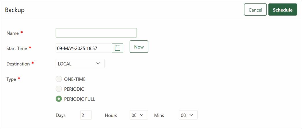

21.4.1 Scheduling a Backup for Oracle Key Vault
You can schedule a one-time, periodic, or a periodic full backup to a local or remote backup destination.
You can start a one-time backup to start immediately without setting a time. However, do not schedule backup operations if a certificate rotation or cluster operation is in progress.
  1. Log in to the Oracle Key Vault management console as a user who has the System Administrator role.
  4. In the Backup page, click Backup.
    The Backup page appears. The following image shows how it appears when PERIODIC FULL is selected.
  5. In the Name field, enter a name for the backup.
  6. If you want to perform a periodic backup, then do the following steps:
    1. In the Start Time field, use the Calendar icon to specify the start time for the backup. If you want the first backup to perform immediately after you click Schedule, then select Now.
    2. For Type, select PERIODIC.
      The additional fields Days, Hours, and Mins appear.
    3. In the Days, Hours, and Mins fields, specify the interval at which periodic backups will occur.
    4. For Destination, select the backup destination.
    5. Click Schedule to add the scheduled backup to the Scheduled Backup(s) page.
    A periodic backup is skipped if another backup is ongoing at the same time. The periodic backup will start at next scheduled interval after the ongoing backup completes.
  7. If you want to perform a one-time backup, then do the following steps:
    1. In the Start Time field, use the Calendar icon to specify the start time for the backup. If you want the backup to perform immediately after you click Schedule, then select Now.
    2. For Type, select ONE-TIME.
    3. For Destination, select the destination backup from the list.
    4. Click Schedule to add the scheduled backup to the Scheduled Backup(s) page.
  8. If you want to perform a periodic full backup, then do the following steps:
    1. In the Start Time field, click the Calendar icon to specify the start time for the backup. If you want the backup to perform immediately after you click Schedule, then select Now.
    2. For Type, select PERIODIC FULL.

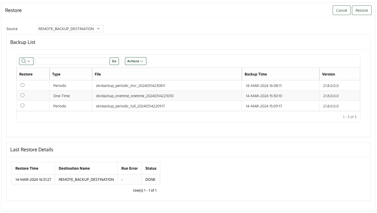

21.5.2 Procedure for Restoring Oracle Key Vault Data
You can restore Oracle Key Vault data to a standalone server using the Oracle Key Vault management console.
Before you restore, ensure that you have the correct recovery passphrase. You will need to enter this passphrase during the restore process. In addition, do not perform a restore operation while a certificate rotation process is in progress.
  4. In the System Backup page, click Restore.
  5. Select Source from the drop-down list.
    Values are either LOCAL or the names of configured remote destinations.
  6. Select Restore next to the backup you want to restore from.
  7. Click Restore to initiate the restore or recovery process.
    You are prompted for the recovery passphrase.
  8. Enter the recovery passphrase and then click Restore to begin.
    The system will restore from the backup and then restart.
  9. After the restore is complete and the system has restarted, delete any paused periodic backup jobs and then re-create them, using a new backup destination.
    Oracle recommends that you delete such jobs in order to avoid corrupting the backup catalog file.

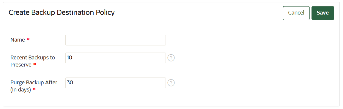

21.6.2 Creating a Backup Destination Policy
The Oracle Key Vault management console enables you to manage periodic purging of Oracle Key Vault backups from remote destinations.
  4. In the System Backup page, click Manage Backup Destinations.
  5. In the Manage Backup Destinations page, click Manage Policies.
  6. In the Manage Backup Destination Policies page, click Create.
    The Create Backup Destination Policy page appears.
    Description of 214_purge_backups.png follows
  7. Enter the following values:
    • Name: Enter a name for the backup destination policy.
    • Recent Backups to Preserve: Enter the number of most recent backups that must always be preserved. Valid values are from 1 through 999. For example, configuring a value of 10 will ensure that Oracle Key Vault does not purge the most recent 10 backups regardless of their age. These backups will remain available for use.
    • Purge Backup After (in days): Enter the number of days after which a backup is to be purged. A backup that is eligible for purging will continue to remain available if it is among the number of most recent backups that are specified in the Recent Backups to Reserve field. Valid values are 1 through 999. For example, configuring a value of 30 will purge any backups that are older than 30 days unless they are among the required number of most recent backups to preserve.
  8. Click Save.
    The Manage Backup Destination Policies page lists currently configured backup destination policies. Clicking on a policy name displays backups that have been purged by the policy. A status value of Purged indicates that a backup was successfully removed by the policy. A value of Unknown indicates there was a problem while deleting the backup. Examples of problems can be a backup not being available on the remote destination, or Oracle Key Vault not having permission to delete this remote backup.
    • Current backup destination policies
    • Purged backups

21.8.2 Step 2: Copy the Oracle Key Vault Public Key to the Oracle ZFS Storage Appliance
The public key enables authentication of the Oracle Key Vault node to Oracle ZFS Storage Appliance for the user created in Step 1 of the previous procedure.
  1. Log in to Oracle Key Vault as a user who has the System Administrator role.
  2. Select the System tab, and in the left navigation bar, select Settings.
  3. Under System Configuration select Backup and Restore.
  4. Select Manage Backup Destinations.
  5. In the Manage Backup Destinations page, click Create.
  6. On the Create Backup Destination page, scroll to the Public Key field.
  7. Copy the contents of the field, except for the line ssh-rsa.
  8. Do not exit Oracle Key Vault; you need to return to it in a later step.

21.8.4 Step 4: Configure Oracle Key Vault to Connect to the Oracle ZFS Storage Appliance Project
The Oracle ZFS Storage Appliance storage project requires the backup key that is generated when you create an Oracle Key Vault backup.
  6. On the Create Backup Destination page, do the following:
    1. In the Destination Name field, enter a name for the backup destination.
    2. For Transfer Method, select sftp.
    3. For Hostname, enter the host information for the server where Oracle ZFS Storage Appliance resides, either the IP address or the name of the server.
    4. For Port, ensure that it matches the port number that was specified in the Oracle ZFS Storage Appliance project that you created.
    5. For Destination Path, enter /export/ followed by the file system name that you gave in Oracle ZFS Storage Appliance when you configured the file system.
    6. In the User Name field, enter the name of the user who was configured to manage the Oracle Key Vault backup project in Oracle ZFS Storage Appliance
    7. Click Save to create the backup destination.
  7. In the left navigation bar, select System Backup and then Backup.
  8. In the Backup page, do the following:
    1. In the Name field, enter a name for the backup.
    2. For Start Time, use the calendar icon to specify a time for the backup to begin.
    3. For Destination, the value typed in Step 6a will be displayed.
    4. For Type, select Periodic, and then enter the days, hours, and minutes for the backup.
    5. Click Schedule.
      The scheduled backup appears in the Scheduled Backups area of the System Backup page.
