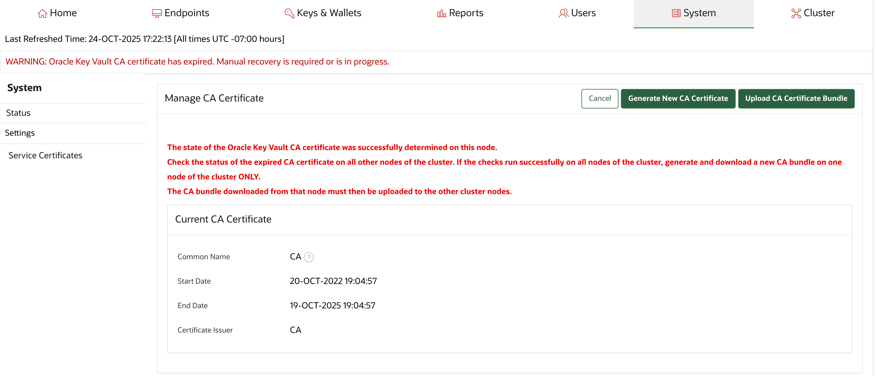

If you do not rotate the CA certificate before it expires, none of the endpoints can communicate with the Oracle Key Vault server or any node of the Oracle Key Vault cluster and all the endpoints will face a downtime. In the cluster deployment none of the Oracle Key Vault nodes will be able to communicate with each other and in case of primary-standby, the communication between primary and standby servers will breakdown.
The CA Certificate must be rotated before it expires to prevent outage to endpoints. Start the CA certificate rotation several weeks in advance of CA certificate expiry to prevent outage to the Oracle Key Vault deployment and endpoints.

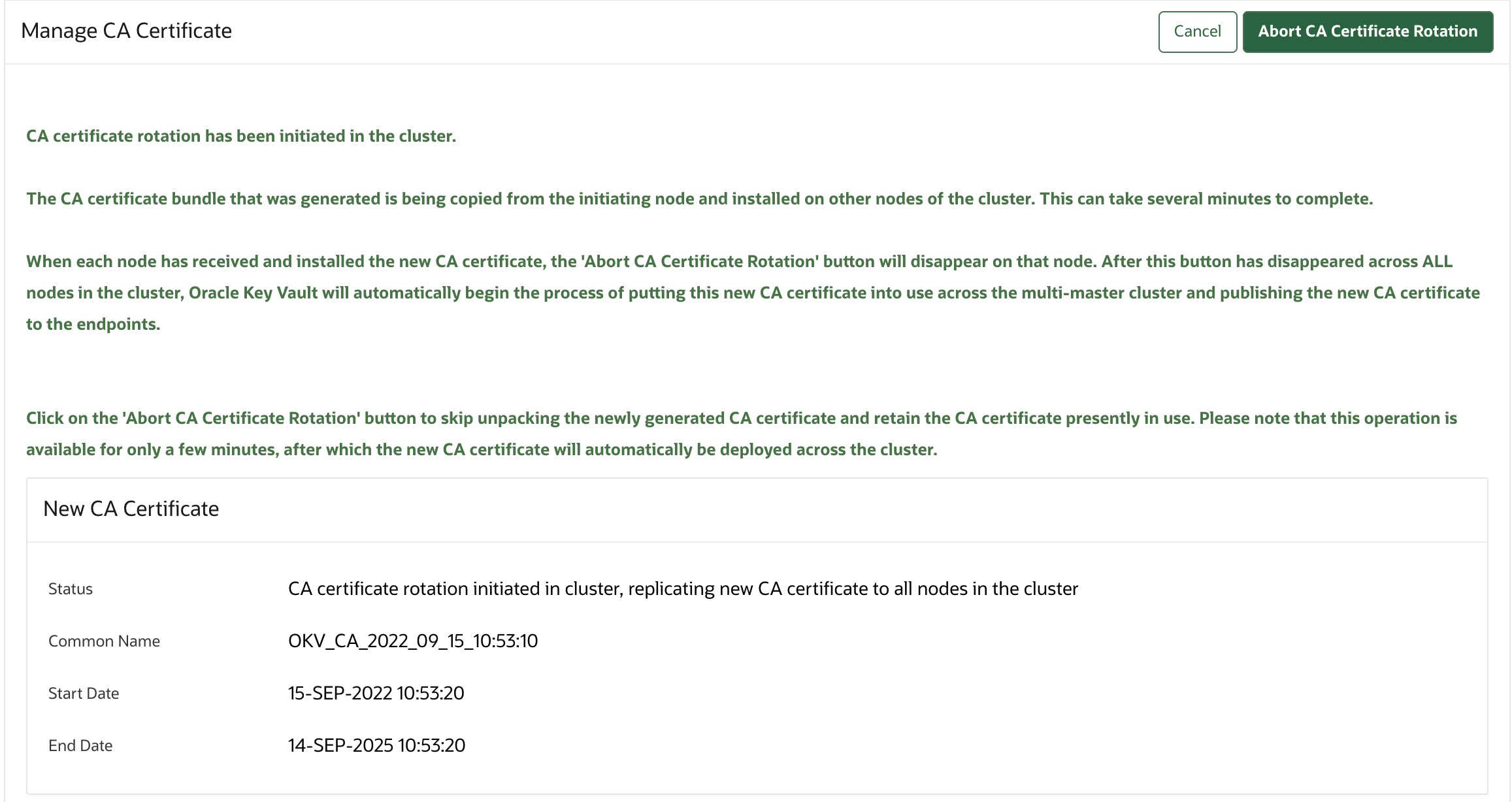

Rotating CA certificates also rotates the server or node certificates and endpoint certificates.

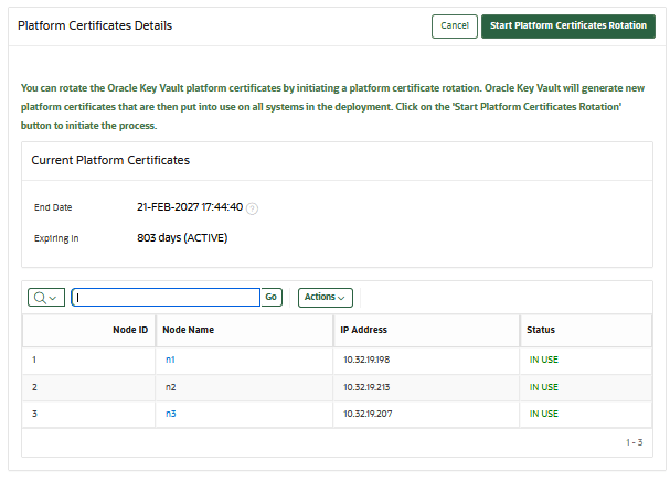

Platform Certificates
Oracle Key Vault platform certificates are used when adding a new node to an Oracle Key Vault multi-master cluster. Platform certificates are also used when shipping redo between read/write nodes in the cluster. The platform certificates are different from the Oracle Key Vault service certificates.

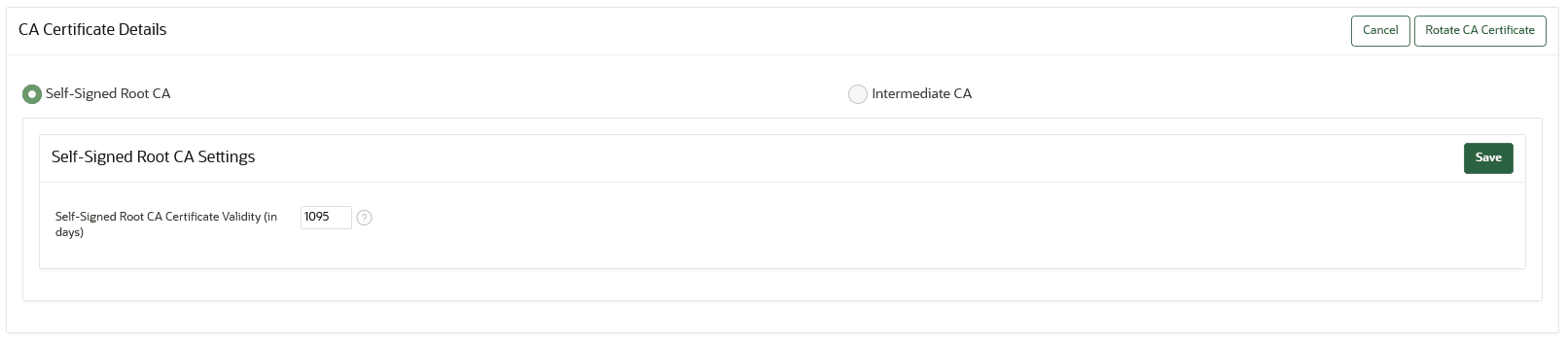

19.2.2 Setting Validity Period of Self-Signed Root CA Certificate
You can configure the validity period for the self-signed Root certificate authority (CA) certificate from the Oracle Key Vault management console.
The CA certificate validity period governs the end date of the CA certificate. The end date of the CA certificate acts as an upper bound on the validity period of the server or node, and the endpoint certificates, when they are issued.
Setting the validity of self-signed Root CA certificate does not enable it, that is, switch it into use. You have to rotate the CA certificate to generate and enable a new self-signed Root CA with the set validity period as described in Rotating CA Certificate.
To set the validity period for the self-signed Root CA:
  1. Log in to the Oracle Key Vault management console as a user who has the System Administrator role.
    In a primary-standby environment, log in to the primary Oracle Key Vault server. In a multi-master cluster environment, log in to the node selected for CA certificate rotation in the cluster.
  2. Select the System tab, then Settings from the left navigation side bar.
  3. In the Certificates area, click Service Certificates.
  4. In the Service Certificates page, select Manage CA Certificate.

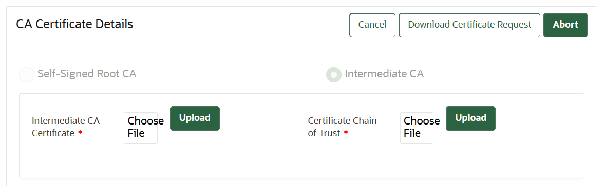

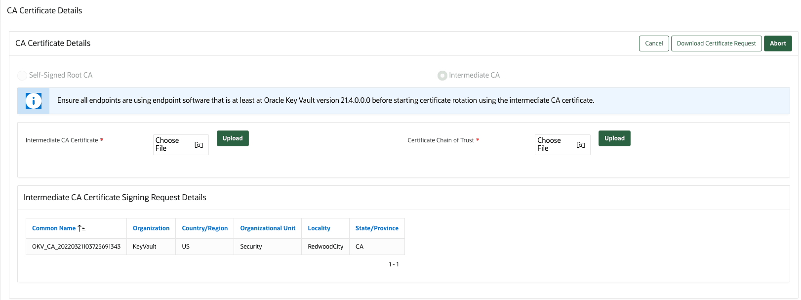

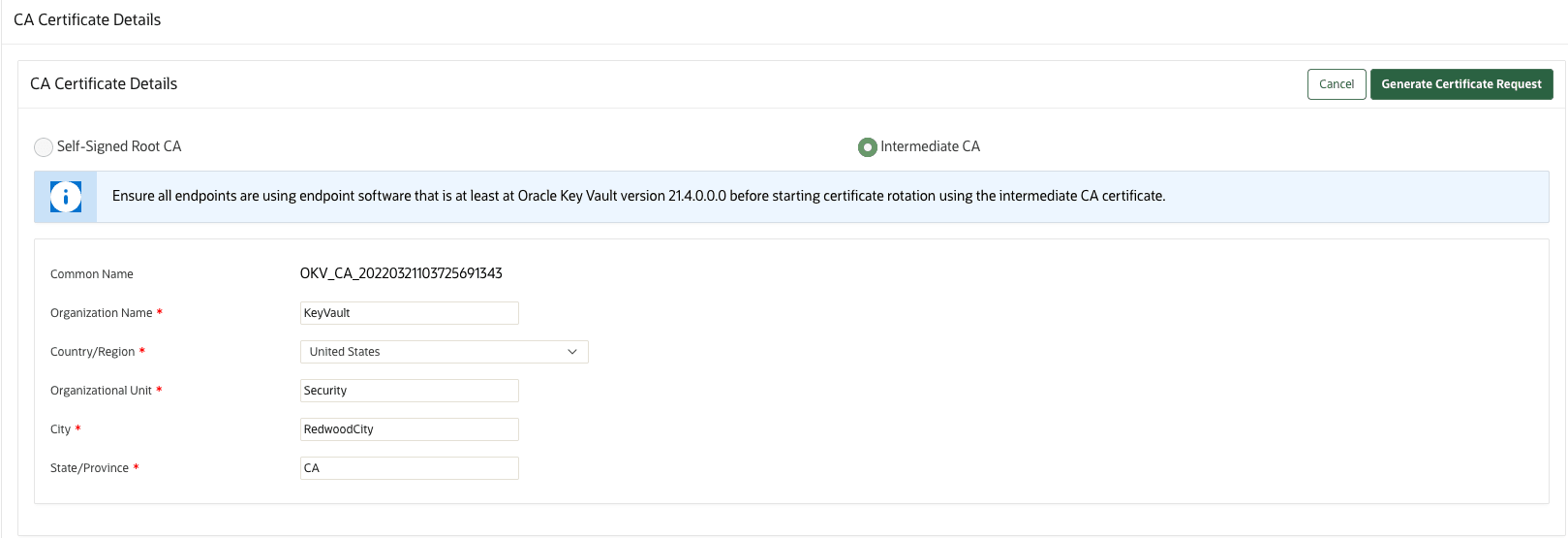

  5. In the CA Certificate Details page, select the Self-Signed Root CA option. The Self-Signed Root CA option is selected by default.
  6. Set the validity value in the Self-Signed Root CA Certificate Validity (in days) field. The default is 1095 days (3 years). You can set a maximum validity period of 3650 days (10 years) and a minimum validity period of 365 days (1 year).
  7. Click Save.

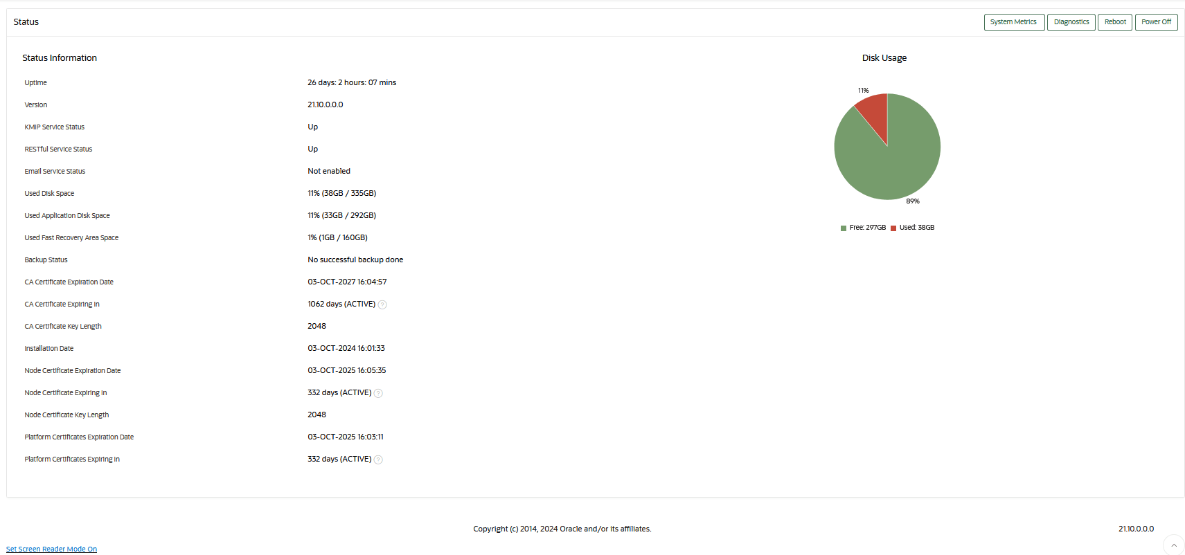

19.3.3 CA Certificate Expiration Date on Status Page
You can check the CA Certificate Expiration Date, which is the expiration date of the Oracle Key Vault CA certificate, from the Status page.
The CA Certificate Expiration Date field in the System Status page reflects the expiration date of the CA certificate. The CA Certificate Expiring In on the System Status page shows how many days are left to expire for the CA certificate.
To navigate to the System Status page, select the System tab.
  1. Log in to the Oracle Key Vault management console as a System Administrator.
    In a multi-master cluster environment, you can log in to any node in the cluster.
  2. Select the System tab and then Status from the left navigation side bar.
  3. Check the CA Certificate Expiration Date field.
  4. Check the CA Certificate Expiring in field.
Description of 2110_ca_certificate_details_status_page1.png follows
Description of the illustration 2110_ca_certificate_details_status_page1.png
Oracle Key Vault raises an alert for the CA certificate expiration when the CA Certificate Expiration Date falls within the alert threshold period. You can also monitor the CA Certificate Expiration Date over SNMP.
19.3.4 Server and Node Certificate Expiration on Status Page
You can check the Server Certificate Expiration Date (in a standalone or primary-standby environment) or the Node Certificate Expiration Date (in a multi-master cluster environment) from the Status page.
The Server Certificate Expiration Date field on the System Status reflects the expiration date of the server certificate. The Server Certificate Expiring In on the Status page shows how many days are left for the server certificate to expire.
In a multi-master cluster environment, these fields are called Node Certificate Expiration Date and Node Certificate Expiring In. The Node Certificate Expiration Date field reflects the expiration date of the node certificate, while Node Certificate Expiring In shows how many days are left for the node certificate to expire.
In a multi-master cluster environment, log into the node whose node certificate expiration date you wish to check. Different nodes can have different node certificate expiration dates.
To navigate to the Status page, select the System tab.
  3. Check the Server Certificate Expiration Date field. In a multi-master cluster environment, this field is Node Certificate Expiration Date.
  4. Check the Server Certificate Expiring in field. In a multi-master cluster environment, this field is Node Certificate Expiring In.
Oracle Key Vault raises an alert for the Server or Node certificate expiration, when the server or node certificate expiration date falls within the configured alert threshold period. You can also monitor the Server Certificate Expiration Date over SNMP.

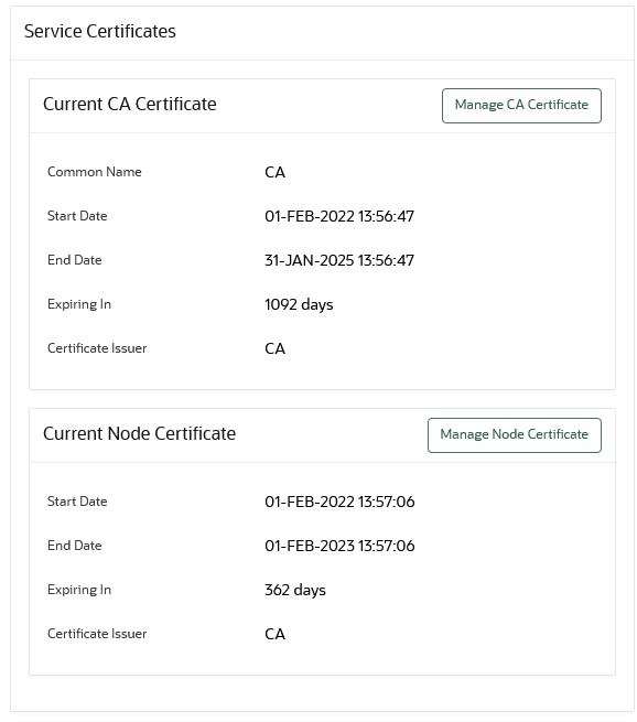

  3. In the Certificates area, select Service Certificates.
  4. In the Current CA Certificate area, check the End Date setting to know when the CA certificate is expiring.
    The Expiring In setting shows the number of days left for the CA certificate to expire.

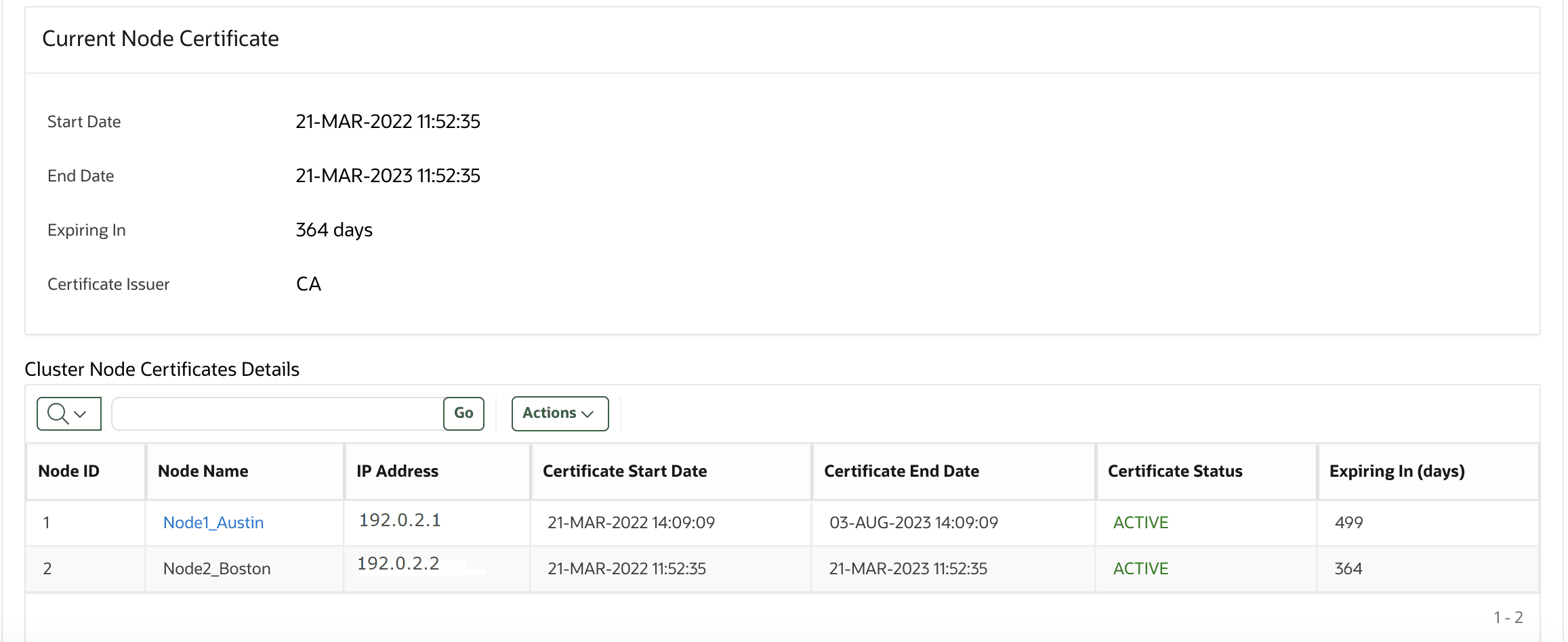

  5. In a multi-master cluster environment:
    • In the Current Node Certificate area, select Manage Node Certificate. Under Current Node Certificate, check the End Date setting. The Expiring In setting also shows the number of days left for the node certificate expiry.
    • You can view the end dates and time to expire of all the node certificates in the cluster in the Cluster Node Certificate Details area.
If a server or node certificate is expiring soon, then Oracle recommends that you rotate the certificate at the earliest.

19.4.2 Checking for Self-Signed Root CA or Intermediate CA Certificate
Oracle Key Vault uses either a self-signed root CA certificate or an intermediate CA certificate.
To check if the current Oracle Key Vault CA certificate is a self-signed root CA or an intermediate CA, check the Common Name and Certificate Issuer fields in the Service Certificates page. If they are similar, for example, both are CA, or start with OKV_CA_, then the current CA certificate is a self-signed root CA. Otherwise, the current CA certificate is an intermediate CA. Additionally, in the intermediate CA certificate, the Certificate Issuer field displays the common name of the trusted third party.
Check the Common Name and Certificate Issuer of the current CA certificate in the Oracle Key Vault management console.
  4. In the Current CA Certificate area, check and compare the Common Name and Certificate Issuer fields. Help text is available for the Common Name field that indicates whether the CA certificate is a self-signed CA or an intermediate CA.

19.4.4 Setting the Validity of Self-Signed Root CA Certificate
You can set the number of days for the validity of a self-signed Root certificate authority (CA) certificate.
The CA certificate validity period acts as an upper limit on the validity period of the server certificates, node certificates and endpoint certificates.
    In a primary-standby environment, log in to the primary Oracle Key Vault server. In a multi-master cluster environment, you can log in to any node in the cluster.
  5. In the CA Certificate Details page, select the Self-Signed Root CA option (this should be selected by default).
    The default is 1095 days (3 years). You can set a maximum of 3650 days (10 years).
  7. Click Save.
    Go to section Rotating CA Certificate to generate and enable the self-signed root CA certificate.
19.4.5 Setting Up the Intermediate CA Certificate
Use the Oracle Key Vault management console to generate the certificate signing request for the intermediate CA certificate, and upload the intermediate CA certificate signed by a trusted third party.
Uploading the intermediate CA certificate does not enable it (that is, uploading the intermediate CA certificate does not put it into use). Perform the following steps to rotate the CA certificate and enable the uploaded intermediate CA certificate:
  5. Under CA Certificate Details, select the Intermediate CA option.
  6. Enter information about your organization in the following fields:
    • Organization Name
    • Country/Region
    • Organization Unit
    • City
    • State/Province
  7. Select Generate Certificate Request.
  8. In the dialog box that lets you know that the generation will take a few minutes, click OK.
  9. After Oracle Key Vault generates the certificate request, in the CA Certificate Details area, select Download Certificate Request to download the certificate request file.
    The certificate signing request file is named as follows:
    OKV_Intermediate_CA_Certificate.csr
    The Intermediate CA Certificate Signing Request Details area shows the details of certificate signing request.
    At this stage, the current CA certificate is still enabled in Oracle Key Vault. The Current Certificate area displays the details of the currently active CA. If you want to cancel the setup of the intermediate CA certificate, then click Abort.
    Description of 214_ca_download_certificate_request.png follows
  10. Have a trusted third party issue the intermediate CA certificate using the downloaded certificate signing request.
  11. Upload the intermediate CA certificate. In the CA Certificate Details area, select Choose File for Intermediate CA Certificate to find and select the intermediate CA certificate file, and then click Upload. In a multi-master cluster environment, you must upload the intermediate CA certificate on the same node where the certificate signing request was downloaded.
  12. Upload the chain of trust for the intermediate CA certificate. In the CA Certificate Details area, select Choose File for Certificate Chain of Trust to find and select the chain of trust file, and then click Upload.
    Description of 214_upload_ca_intermediate_and_trust_chain_certificate.png follows
    Description of the illustration 214_upload_ca_intermediate_and_trust_chain_certificate.png
    The chain of trust file is a PEM bundle that consists of the CA certificate used by the external signing authority to sign the intermediate certificate signing request, OKV_Intermediate_CA_Certificate.csr file, as well as all of the certificates in that CA's trust chain, in reverse order.
    For example, suppose that OKV_Intermediate_CA_certificate.csr has been signed by the external signing authority, and that the generated certificate is called OKV_Intermediate_CA_certificate.crt . Also suppose that the external signing authority used its CA certificate, CACertA, to generate OKV_Intermediate_CA_certificate.crt from OKV_Intermediate_CA_certificate.csr. CACertA was, in turn, issued by CACertB. CACertB was issued by CACertC. The certificate trust chain file that you must upload must consist of CACertA, CACertB, CACertC, in that order, in the PEM bundle format. It should NOT contain OKV_Intermediate_CA_certificate.crt. For example, assuming that CACertA, CACertB, and CACertC are all certificates in PEM format, where each certificate file is of the form:
    -----BEGIN CERTIFICATE-----
    <cert contents>
    -----END CERTIFICATE----
    The certificate chain of trust would look like this:
    <CACertA contents>
    <CACertB contents>
    <CACertC contents>
    In a multi-master cluster environment, you must upload the certificate chain of trust on the same node where you uploaded the intermediate CA certificate.
    As part of the upload, Oracle Key Vault performs the following validations:
    1. The uploaded intermediate CA is verified using the uploaded certificate chain of trust.
    2. The certificate chain of trust has a depth of less than or equal to 8.
    After the uploads are successful, the Rotate CA Certificate button is displayed.
    Go to section Rotating CA Certificate to enable the uploaded intermediate CA certificate.

  9. In the Manage CA Certificate page, in the Current CA Certificate area, select Start CA Certificate Rotation.
  10. In the confirmation dialog box, click OK.
    If you enable a self-signed root CA certificate, a new self-signed root CA certificate is created. In a multi-master cluster environment, Oracle Key Vault distributes and installs the newly created self-signed root CA certificate or uploaded intermediate CA certificate to all nodes of the cluster. In a primary-standby environment Oracle Key Vault distributes and installs these certificates to the standby. In case of a standalone environment, Oracle Key Vault simply installs the certificate that you enable.
    At this stage, the endpoints continue to use the certificates issued using the previous CA certificate. The Old CA Certificate area displays the details of the currently active CA. The New CA Certificate area displays the certificate you have rotated along with its common name. Additionally, once a CA certificate rotation has begun, a banner is displayed, indicating that a CA certificate rotation is in progress and the number of days left to expiration of the old CA. It continues to be displayed until CA certificate rotation is complete. The banner is periodically updated with the number of days left to expiration of the old CA, and continues to be displayed until CA certificate rotation is complete.
    If you want to cancel the rotation process, click Abort CA Certificate Rotation.
    The Abort CA Certificate Rotation operation is available for initial few minutes. After this, when the Abort CA Certificate Rotation button is no longer visible, Oracle Key Vault automatically begins the process of enabling the new Oracle Key Vault CA certificate.
    In Oracle Key Vault 21.4 and earlier, CA certificate rotation involved two steps: Start CA Certificate Rotation, followed by Activate CA Certificate. Starting with Oracle Key Vault 21.5, it is now a single-step process initiated by Start CA Certificate Rotation. Please exercise caution and initiate CA certificate rotation only when fully ready to do so.
    In a multi-master cluster environment, note the following:
    • After the start of the certification rotation process, the details of the new certificate that was generated is displayed on the node on which you started the CA rotation. If you refresh the Manage CA Certificate page on all of the other nodes, this page displays a message that the new certificate is propagated to that node.
    • To access this page, select the System tab, select Settings in the left navigation bar, select Service Certificates, and then select Manage CA Certificate in the Certificates area.
    • The certificate is now distributed to all the nodes. The propagation process takes a few minutes to complete.
    • You can abort the certificate rotation before the point where:
      • All nodes in the cluster have received the new CA certificates.
      • Each node has notified the other nodes that it has received the certificate.
    Periodically refresh the Manage CA Certificate page, in case there are any changes to the rotation status. For example, refresh the page to determine if the Abort CA Certificate Rotation button is no longer displayed.
    Oracle Key Vault automatically initiates the activation when all nodes receive the new CA certificate and displays the message,
    Automatic certificate update of the endpoints is in progress.
    After you click Start CA Certificate Rotation, you have only a few minutes to cancel the CA certificate rotation process. When the Abort CA Certificate Rotation button is no longer visible, the certificate rotation cannot be aborted and will proceed. It is therefore recommended that you click Start CA Certificate Rotation only when required.
    The new CA certificate takes a few minutes to propagate to all the nodes and the Manage CA Certificate page on other nodes may show no change in status. Refresh the Manage CA Certificate page on the other nodes till the following message is displayed:
    The new CA certificate is now activated and the Oracle Key Vault servers or nodes begin issuing new endpoint certificates signed by the new CA certificate. The endpoints can now connect to the Oracle Key Vault server or nodes using the endpoint certificate issued by either the new or the old Oracle Key Vault CA. In the background, Oracle Key Vault starts issuing certificates for its endpoints, a few endpoints at a time.
    When a new certificate is generated on Oracle Key Vault for an endpoint, it is not delivered to the endpoint right away. The endpoint receives the new certificate the next time it reaches out to Oracle Key Vault, and in particular, to the server or node that has generated the certificate. After the endpoint has received the new certificate, the endpoint must connect to Oracle Key Vault a second time to let the server know that the endpoint has successfully received (and is using) the new certificate. When Oracle Key Vault receives this acknowledgment from the endpoint, Oracle Key Vault updates the Common Name of Certificate Issuer field for that endpoint on the Endpoints page to the common name of the new Oracle Key Vault CA certificate.
    Periodically check the status of replication across the cluster by viewing either the Cluster Monitoring page or the Cluster Management page. To access either of these pages, click the Cluster tab, and then select either Management or Monitoring in the left navigation bar.
  11. To check if the credentials for an endpoint are updated, click the Check Endpoint Progress button.
    Click the Check Endpoint Progress button to display the Endpoints page.
    For more information, see, Checking Certificate Rotation Status for Endpoints

Use the Oracle Key Vault management console to check the overall status of a certificate rotation.
After all the endpoints have been updated to using the new certificate, the Oracle Key Vault server begins the process of fully rotating its own server certificates in the background.
  2. Select the System tab, then Settings in the left navigation side bar.
  3. In the Certificates area, select Service Certificate.
    By default, Service Certificate is selected.
  4. Check the Manage CA Certificate page.
  5. Check the certificate rotation status.
    After clicking the Manage CA Certificate and if you are directed to the CA Certificate Details page, you can make a choice between the Self-Signed Root CA and Intermediate CA, the certificate rotation is complete. Otherwise it is still in progress.
    The End Date field in the Service Certificates page should reflect the expiration time of the new CA certificate.
    In a multi-master cluster environment CA certificate rotation process is complete when certificate rotation is complete on every node of the cluster.
    When a CA certificate rotation is in progress, OKV management console displays a banner on the Home page , as well as Manage Service Certificates, to that effect. In a multi-master cluster environment, the presence of the banner on a given node indicates that CA certificate rotation is still in progress on that node.
    You can initiate another certificate rotation only after all the nodes have completed their certification rotation process.

19.4.13 Guidelines for Managing CA Certificate Rotations
Consider these Oracle Key Vault guidelines for managing certificate authority (CA) certificate.
Guidelines for Endpoint Software Versions
  • For self-signed root CA certificate rotation, ensure that all the endpoints software are at version 18.2.0.0.0 or later.
  • For intermediate CA certificate rotation, ensure that all the endpoints software are at version 21.4.0.0.0 or later.
  • Upgrade the endpoint software to the same version as Oracle Key Vault before initiating a CA certificate rotation to ensure that the latest fixes to certificate rotation are also available on the endpoint software.

19.5.2 Configuring Certificate Validity Period for Server and Node Certificates
You can configure the validity period for server or node certificates in the Oracle Key Vault management console.
The certificate validity period takes effect the next time you rotate the server or node certificates. It will also be taken into account when you generate the server or node certificates as part of a CA certificate rotation, or when you add a new node to the cluster, to the node certificates for that new node. Irrespective of the value that the server or node certificate validity is set to, when the certificates are eventually generated, Oracle Key Vault ensures that their expiry date is less than that of the CA certificate.
  4. Depending on your environment, perform the following:
    • In a standalone or primary-standby environment: In the Current Server Certificate area, select Manage Server Certificate.
    • In a multi-master cluster environment: In the Current Node Certificate area, select Manage Node Certificate.
  5. In the Server Certificate Validity (in days) or Node Certificate Validity (in days) field, enter a value between 365 days (the minimum and the default) and 1095 days for this setting.
  6. Click Save.
19.5.3 Rotating Server Certificates and Node Certificates
You can rotate server certificates and node certificates in the Oracle Key Vault management console.
Before you perform the rotation, ensure that you read the guidelines for rotating server certificates and node certificates.
  5. If required, in the Server Certificate Validity (in days) field (for standalone or primary-standby environments) or Node Certificate Validity (in days) field (for multi-master cluster environments), enter a value between 365 days (the minimum and the default) and 1095 days for this setting.
    Wait several minutes to make sure that this setting takes effect, particularly in a multi-master cluster environment. When the change is visible across all cluster nodes (navigate to the same page on each node to verify), you are ready to initiate a server or node certificate rotation.
  6. Depending on your environment, do the following:
    • In a standalone or primary-standby environment: Select Generate Server Certificate.
    • In a multi-master cluster environment: Select Generate Node Certificate.
  7. In the confirmation window, click OK.
    This process can take several minutes to complete. It may also result in a momentary disruption of endpoint servicing.
If the process successfully completes, then the Current Server Certificate (for standalone or primary-standby environments) and the Current Node Certificate (for multi-master cluster environments) sections display new values for the End Date and Expiring in settings. In a multi-master cluster environment, you can view the expiry dates of all the node certificates in the cluster in the Cluster Node Certificate Details area.

19.6 Managing the Oracle Key Vault CA Certificate After Expiry
You cannot start a CA certificate rotation when the Oracle Key Vault CA certificate has already expired.
When the endpoints cannot communicate with Oracle Key Vault it results in an outage. As a result, in a multi-master cluster environment, Oracle Key Vault nodes cannot communicate with each other. In such a scenario, you must regenerate a new CA certificate manually using the following steps.
In a multi-master cluster environment, this new CA certificate must be distributed from the generating node to all other nodes. After the CA certificate has been distributed across the cluster, you must rotate the node certificates on each cluster node in turn.
Finally, you must re-enroll all endpoints because this involves endpoint outage until they have been re-enrolled. Oracle recommends that you configure alerts for CA certificate expiration and complete CA certificate rotation, see Managing CA Certificate Rotation before the CA certificate expires, in preference to the following steps. This ensures that the CA certificate rotation is completed with minimal disruption to endpoints and in a multi-master cluster environment, to the Oracle Key Vault cluster nodes.
Back up Oracle Key Vault before commencing with these steps.
To manually issue a new CA certificate after the current CA certificate has expired, perform the following steps.
  1. Log into the Oracle Key Vault management console as a user with the System Administrator role.
    • In a primary-standby environment: Log into the Oracle Key Vault primary server.
    • In a multi-master cluster environment: Select a node to generate a new CA certificate and log into that node. If you want to enable an intermediate CA certificate, then log into the node where the intermediate CA certificate was previously uploaded.
    The current CA certificate details including its start and end date displays, as well as a message to the effect that the CA certificate has expired.
  5. Click on Check Expired CA Certificate Rotation Status.
  6. In the confirmation dialog box, click OK. In the backend, this performs a series of checks on the Oracle Key Vault system.
  7. In a multi-master cluster environment, you must perform Steps 1 - 6 on each node of the cluster.
  8. On successful validation, the Generate New CA Certificate button becomes active. In a multi-master cluster environment, an additional button, Upload CA Certificate Bundle, is shown.
    These buttons are shown on each node of a multi-master cluster only if the checks are completed successfully on that node. If the checks are unsuccessful on any cluster node or if the Generate New CA Certificate and Upload CA Certificate Bundle buttons do not show on every node of the cluster, then do not proceed to the next step. Contact Oracle Support.

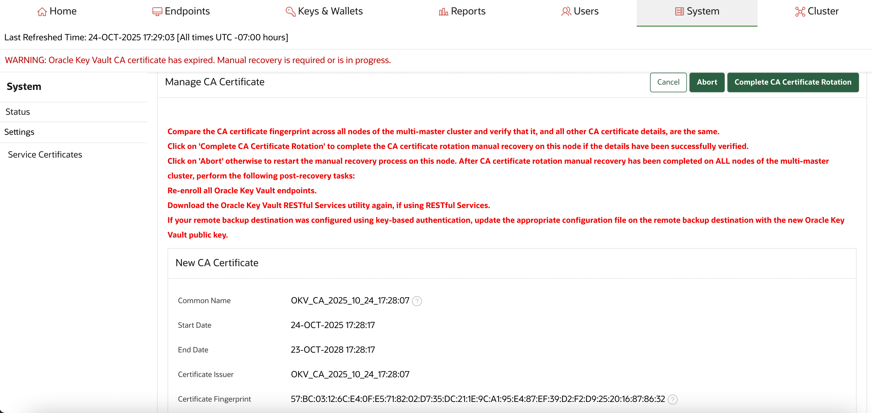

  9. On the Oracle Key Vault system selected for generation of the new CA certificate in Step 1, click Generate New CA Certificate.
    In a primary-standby environment, this is the Oracle Key Vault primary server.
    In a multi-master cluster environment, this is the cluster node that was chosen in Step 1 to generate the new CA. If you want to enable an intermediate CA certificate, then this is the node that the intermediate CA was uploaded on before the current CA expired.
  10. Click OK in the confirmation box. In the backend, this generates a new CA certificate.
    In a multi-master cluster environment, this also creates a certificate bundle that is made available to download. The bundle must be stored in a safe place because it must be distributed to all cluster nodes.
  11. Refresh the page on the Oracle Key Vault management console on which the new CA certificate was generated. The Complete CA Certificate Rotation button is now active. Additionally, other details of the new CA certificate, such as the certificate common name and certificate fingerprint are displayed.
    Description of 21.5_complete_ca_certificate_rotation.png follows
    In a multi-master cluster environment, proceed to Step 12. In standalone and primary-standby environments, proceed to Step 15.
  12. In a multi-master cluster environment, log into a node of the cluster other than the one on which the CA certificate was generated. Click on Upload CA Certificate Bundle and upload the bundle that was downloaded in Step 10.When this successfully completes, details of the new CA are displayed, including the common name of the CA and its certificate fingerprint. Compare these details with those displayed on the generating node (see Step 11).
  13. If any of the details of the new CA certificate uploaded in Step 12 do not match with the details displayed on the generating node in Step 11, then click Abort and repeat Step 12 again. Proceed to Step 14 only after the CA certificate details on this node match with that of the generating node.
  14. Perform Step 12 (and if necessary, Step 13) on every node of the cluster other than the generating node. Proceed to Step 15 only after the CA certificate bundle has been uploaded to all nodes of the cluster, and the certificate details have been verified to be an exact match across all nodes.
  15. Click Complete CA Certificate Rotation. In the confirmation dialog box, click OK. This process may take several minutes to complete.
    In the backend, this generates new server or node certificates, issued by the new CA that was generated in Step 9.In a primary-standby environment, this operation must be performed on the Oracle Key Vault primary server. In a multi-master cluster environment, this operation must be performed on every node of the cluster, one after the other.
  16. In case of an error, click Abort. In a multi-master cluster environment, you can upload the certificate bundle and try performing the process again.
  17. You can also select Complete CA Certificate Rotation again.
    In a multi-master cluster environment proceed to next steps only after successful certificate validation on all nodes.
  18. In a multi-master cluster environment, check the Cluster Monitoring pages, verify that communication is restored between all cluster nodes. Also consider testing replication between nodes by creating a wallet on each node of the cluster and verifying that it transitions from the PENDING to ACTIVE state.
  19. Re-enroll all the Oracle Key Vault endpoints.
  20. Complete the recommended post-recovery tasks - download the Oracle Key Vault RESTful services utility again and update the Oracle Key Vault remote backup destination configuration file with the new public key, if required.

19.7.2 Configuring Oracle Key Vault Alternate Hostname on the Management Console
You can configure alternate hostnames on the Oracle Key Vault management console. The alternate hostname must be a valid IP address or a fully-qualified domain name (FQDN).
Up to two alternate hostnames can be configured for a given Oracle Key Vault server/node. You can choose one of these alternate hostnames (or the Oracle Key Vault server/node IP address) as the hostname for endpoints to use when communicating with the system.
Configuring the alternate hostname requires rotating the Oracle Key Vault server/node certificates. Ensure that you follow the guidelines for server/node certificate rotation when doing so.
  1. Log into the Oracle Key Vault management console as a user who has the System Administrator role. In a multi-master cluster environment, you must log into the management console of the node whose alternate hostname you are configuring.
  4. In a standalone environment, select Manage Server Certificate. In a multi-master cluster environment, select Manage Node Certificate. Alternate hostnames cannot be configured in primary-standby deployments.
  5. Depending on the environment, do the following:
    1. In a standalone environment, on the Server Certificates Details page, scroll down to the Current Server Alternate Hostname area. Enter a valid IP address or fully-qualified domain name (FQDN) in the Alternate Hostname1 field. If desired, enter a different IP address or FQDN in the Alternate Hostname2 field. Select Generate Server Certificate.
    2. In a multi-master cluster environment, on the Node Certificates Details page, scroll down to the Current Node Alternate Hostname area. Enter a valid IP address or fully-qualified domain name (FQDN) in the Alternate Hostname1 field. If desired, enter a different IP address or FQDN in the Alternate Hostname2 field. Select Generate Node Certificate.
  6. In the confirmation window, select OK.
  7. After the server/node certificates have been successfully generated, the alternate hostname(s) can be viewed in the Current Server Certificate (in standalone environments) or Current Node Certificate (in multi-master clusters) section. In a multi-master cluster environment, the alternate hostname(s) used by each multi-master cluster node can be viewed in the Cluster Node Certificates Details section of the Node Certificates Details page.

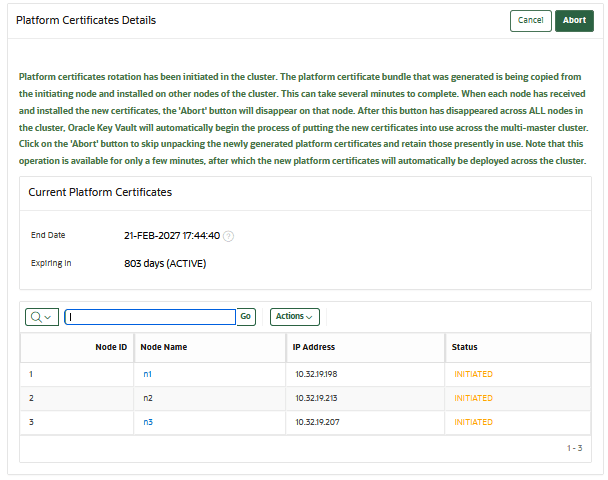

  4. In the Service Certificates page, select Manage Platform Certificates. The Platform Certificates Details page appears.
    The Current Platform Certificates window pane displays the following:
    • End Date: The platform certificate expiry date with time. The expiration date displayed is the minimum of the expiration dates of the platform certificates used for Oracle Key Vault operations.
    • Expiring In: The number of days the platform certificates will be active.
    • Node ID: The ID of the node.
    • Node Name: The name of the node.
    • IP Address: The IP address of the node.
    • Status: The current status of the node.
    After you start the platform certificates rotation process, the status of the node changes according to the stage of the platform certificate rotation.
  5. Click Start Platform Certificates Rotation button. A confirmation dialogue box for starting the platform certificate rotation is displayed.
  6. Select Yes. The platform certificate rotation process starts in the background. The Oracle Key Vault management console displays the platform certificate rotation notification with a message as shown in the following image:
  7. The Abort button appears on the Platform Certificate Details page.
    You can select the Abort button to prevent the platform certificates rotation process from proceeding. The Abort button disappears after a few minutes and then you can no longer abort the process. You might have to refresh the web console to check if you are past the stage where abort is possible.
  8. After the Abort button disappears from the Platform Certificate Details page, the platform certificate rotation process is initiated with the following message:
    Platform certificates rotation has been initiated.
     In a few minutes, Oracle key Vault will automatically start to put these new certificates into use.
    After the platform certification rotation process is complete, the End Date field is updated with the new expiry date.
