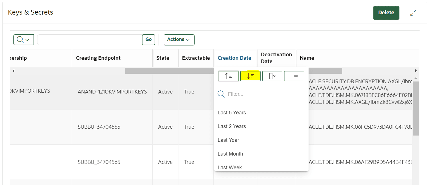

- Log in to the Oracle Key Vault management console as the Key Administrator user.
- Verify whether the latest keys are added to the wallet. Go to the Keys & Secrets page, and sort the keys in descending order by Creation Date.
- Check whether the latest keys created from that particular endpoint, Creating Endpoint are assigned to the wallet.

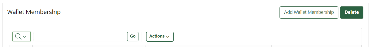

- If the key is not assigned to any wallet then, edit the key by clicking on the pencil icon.
- On the edit page, click on Add Wallet Membership and select the wallet assigned to the endpoint and save it.
- Verify whether the key has wallet membership by revisiting the Keys & Secrets page.

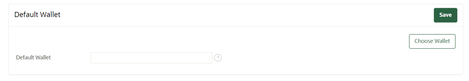

- Go to the endpoints page.
- Search for the endpoint then click on the endpoint name.
- Check the default wallet setting. If no default wallet is assigned, then click Choose Wallet to select the desired wallet.
- Click Save.
- Revisit the endpoint edit page to verify whether the default wallet is assigned correctly.

- If the key is available and has no name or any other details, then perform Steps 9 to 13.
- On the right of the Key Details field, click the pencil icon to edit the key.
- Remove the assignment of the wallet membership for the current wallet of the endpoint, and then save your changes.
