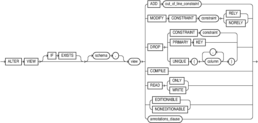

alter_view::=
(out_of_line_constraint::=—part of constraint::= syntax, annotations_clause)

schema
Specify the schema containing the view. If you omit schema, then Oracle Database assumes the view is in your own schema.
view
Specify the name of the view to be recompiled.
MODIFY CONSTRAINT Clause
Use the MODIFY CONSTRAINT clause to change the RELY or NORELY setting of an existing view constraint. Refer to "Notes on View Constraints" for general information on view constraints.
Restriction on Modifying Constraints
You cannot change the setting of a unique or primary key constraint if it is part of a referential integrity constraint without dropping the foreign key or changing its setting to match that of view.
ADD Clause
Use the ADD clause to add a constraint to view. Refer to constraint for information on view constraints and their restrictions.
DROP Clause
Use the DROP clause to drop an existing view constraint.
Restriction on Dropping Constraints
You cannot drop a unique or primary key constraint if it is part of a referential integrity constraint on a view.
{ READ ONLY | READ WRITE }
These clauses are valid only for editioning views.
Specify
READONLYto indicate that the editioning view cannot be updated. -
Specify
READWRITEto return a read-only editioning view to read/write status.
When you specify these clauses, the database does not invalidate dependent objects, but it may invalidate cursors.
EDITIONABLE | NONEDITIONABLE
Use these clauses to specify whether the view becomes an editioned or noneditioned object if editioning is later enabled for the schema object type VIEW in schema. The default is EDITIONABLE. For information about altering editioned and noneditioned objects, see Oracle Database Development Guide.
See Also:
CREATE VIEW for information about editioning views
annotations_clause
For the full semantics of the annotations clause see, annotations_clause.
You can only change annotations at the view level with the ALTER statement. To drop column-level annotations, you must drop and recreate the view.
