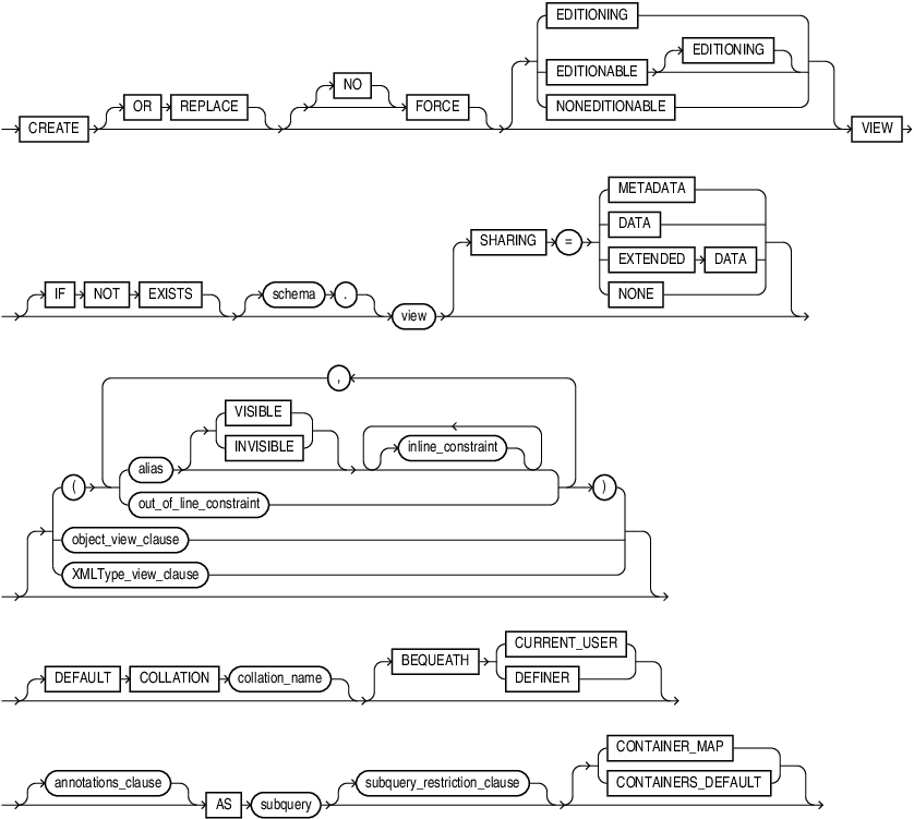

Syntax
create_view::=
(inline_constraint::= and out_of_line_constraint::=, object_view_clause::=, XMLType_view_clause::=, subquery::=—part of SELECT
, subquery_restriction_clause::=, annotations_clause)
XMLSchema_spec::=

DEFAULT COLLATION
Use this clause to specify the default collation for the view. The default collation is used as the derived collation for all the character literals included in the defining query of the view. The default collation is not used by the view columns; the collations for the view columns are derived from the view’s defining subquery. The CREATE
VIEW
statement fails with an error if any of its character columns is based on an expression in the defining subquery that has no derived collation.
For collation_name
, specify a valid named collation or pseudo-collation.
If you omit this clause, then the default collation for the view is set to the effective schema default collation of the schema containing the view. Refer to the DEFAULT_COLLATION clause of ALTER
SESSION
for more information on the effective schema default collation.
You can specify the DEFAULT
COLLATION
clause only if the COMPATIBLE
initialization parameter is set to 12.2
or greater, and the MAX_STRING_SIZE
initialization parameter is set to EXTENDED
To change the default collation for a view, you must recreate the view.
Restriction on the Default Collation for Views
If the defining query of the view contains the WITH
plsql_declarations
clause, then the default collation of the view must be USING_NLS_COMP
BEQUEATH
Use the BEQUEATH
clause to specify whether functions referenced in the view are executed using the view invoker's rights or the view definer's rights.
If you specify BEQUEATH
CURRENT_USER
, then functions referenced by the view are executed using the view invoker's rights as long as one of the following conditions is met:
The view owner has the
INHERIT
PRIVILEGES
object privilege on the invoking user. -
INHERIT
ANY
PRIVILEGES
system privilege.
If a query of the view invokes an identity- or privilege-sensitive SQL function, or an invoker's rights PL/SQL or Java function, then the current schema, current user, and currently enabled roles within the operation's execution are inherited from the querying user's environment, rather than from the owner of the view.
This clause does not turn the view itself into an invoker's rights object. Name resolution within the view is still handled using the view owner's schema, and privilege checking for the view is done using the view owner's privileges.
DEFINER
, then functions referenced by the view are executed using the view definer's rights. If a query on the view invokes an identity- or privilege-sensitive SQL function, or an invoker's rights PL/SQL or Java function, then the current schema, current user, and currently enabled roles within the operation's execution are inherited from the owner of the view.
Name resolution within the view is handled using the view owner's schema, and privilege checking for the view is done using the view owner's privileges.
This is the default.
Restriction on the BEQUEATH Clause
You cannot specify this clause with the EDITIONING
clause.
See Also:
Oracle Database Security Guide for more information on controlling invoker's rights and definer's rights in views
annotations_clause
For the full semantics of the annotations clause see annotations_clause.
AS subquery
Specify a subquery that identifies columns and rows of the table(s) that the view is based on. The select list of the subquery can contain up to 1000 expressions.
If you create views that refer to remote tables and views, then the database links you specify must have been created using the CONNECT
TO
clause of the CREATE
DATABASE
LINK
statement, and you must qualify them with a schema name in the view subquery.
If you create a view with the flashback_query_clause
Use the subquery_restriction_clause
to restrict the defining query of the view in one of the following ways:
WITH READ ONLY
Specify WITH
READ
ONLY
to indicate that the table or view cannot be updated.
WITH CHECK OPTION
Specify WITH
CHECK
OPTION
to indicate that Oracle Database prohibits any changes to the table or view that would produce rows that are not included in the subquery. When used in the subquery of a DML statement, you can specify this clause in a subquery in the FROM
clause but not in subquery in the WHERE
clause.
CONSTRAINT constraint
Specify the name of the READ
ONLY
or CHECK
OPTION
constraint. If you omit this identifier, then Oracle automatically assigns the constraint a name of the form SYS_C
n
, where n is an integer that makes the constraint name unique within the database.
For tables, WITH
CHECK
OPTION
guarantees that inserts and updates result in tables that the defining table subquery can select. For views, WITH
CHECK
OPTION
cannot make this guarantee if:
There is a subquery within the defining query of this view or any view on which this view is based or
INSERT
,UPDATE
, orDELETE
operations are performed usingINSTEAD
OF
triggers.
Restriction on the subquery_restriction_clause
You cannot specify this clause if you specify an ORDER
BY
clause.
See Also:
CONTAINER_MAP
Specify the CONTAINER_MAP
clause to enable the view to be queried using a container map.
CONTAINERS_DEFAULT
Specify the CONTAINERS_DEFAULT
clause to enable the view for the CONTAINERS
clause.
