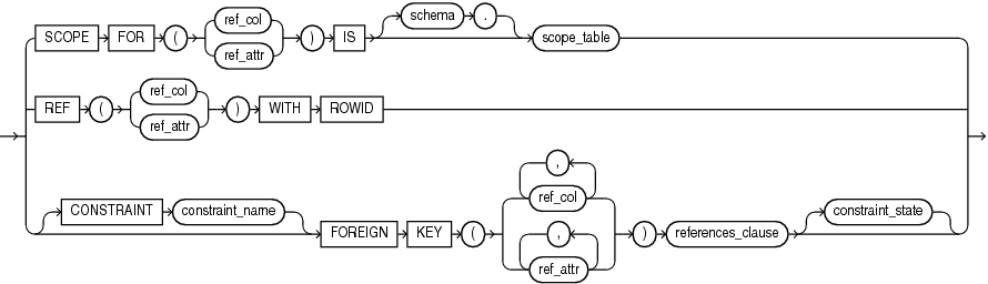

out_of_line_ref_constraint::=
Description of the illustration out_of_line_ref_constraint.eps
(references_clause::=, constraint_state::=)

REF Constraints
REF constraints let you describe the relationship between a column of type REF and the object it references.
ref_constraint
REF constraints use the ref_constraint syntax. You define a REF constraint either inline or out of line. Out-of-line specification requires you to specify the REF column or attribute you are further describing.
For ref_column, specify the name of a
REFcolumn of an object or relational table. -
For ref_attribute, specify an embedded
REFattribute within an object column of a relational table.
Both inline and out-of-line specification let you define a scope constraint, a rowid constraint, or a referential integrity constraint on a REF column.

REF Constraint Examples
The following example creates a duplicate of the sample schema object type cust_address_typ, and then creates a table containing a REF column with a SCOPE constraint:
CREATE TYPE cust_address_typ_new AS OBJECT
( street_address VARCHAR2(40)
, postal_code VARCHAR2(10)
, city VARCHAR2(30)
, state_province VARCHAR2(10)
, country_id CHAR(2)
CREATE TABLE address_table OF cust_address_typ_new;
CREATE TABLE customer_addresses (
add_id NUMBER,
address REF cust_address_typ_new
SCOPE IS address_table);
The following example creates the same table but with a referential integrity constraint on the REF column that references the object identifier column of the parent table:
add_id NUMBER,
address REF cust_address_typ REFERENCES address_table);
The following example uses the type department_typ and the table departments_obj_t, created in “Creating Object Tables: Examples”. A table with a scoped REF is then created.
CREATE TABLE employees_obj
( e_name VARCHAR2(100),
e_number NUMBER,
e_dept REF department_typ SCOPE IS departments_obj_t );
The following statement creates a table with a REF column which has a referential integrity constraint defined on it:
e_number NUMBER,
e_dept REF department_typ REFERENCES departments_obj_t);
