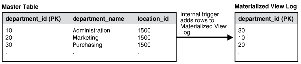

The three database objects displayed in Figure 38-1 are required at a master database to support fast refreshing of materialized views.
Master Table
The master table is the basis for the materialized view.
A master table is located at the target master database. Remember that a materialized view points to only one master database. Data manipulation language (DML) changes made to the master table, as recorded by the materialized view log, are propagated to the materialized view during the refresh process.
Fast refreshable materialized views must be based on master tables or synonyms of master tables. Complete refresh must be used for a materialized view based on a view.
Internal Trigger for the Materialized View Log
When changes are made to the master table using DML, an internal trigger records information about the affected rows in the materialized view log.
This information includes the values of the primary key, rowid, or object id, or both, as well as the values of the other columns logged in the materialized view log. This is an internal AFTER ROW trigger that is automatically activated when you create a materialized view log for the target master table. It inserts a row into the materialized view log whenever an INSERT, UPDATE, or DELETE statement modifies the table's data. This trigger is always the last trigger to fire.
