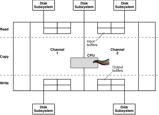

Figure 22-1 depicts two channels backing up data stored on three disks. Each channel reads the data into the input buffers, processes the data while copying it from the input to the output buffers, and then writes the data from the output buffers to disk.
Figure 22-1 Phases of a Multichannel Backup to Disk
Description of Figure 22-1 follows
Description of "Figure 22-1 Phases of a Multichannel Backup to Disk"

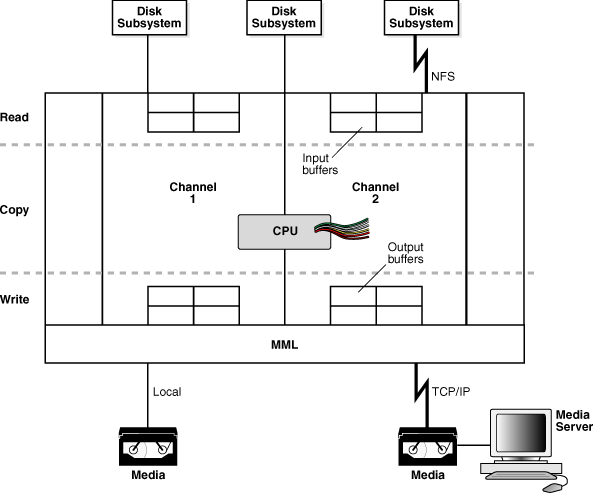

Figure 22-2 also depicts two channels backing up data stored on three disks, but one disk is mounted remotely over the network. Each channel reads the data into the input buffers, processes the data while copying it from the input buffers to the output buffers, and then writes the data from the output buffers to tape. Channel 1 writes the data to a locally attached tape drive, whereas channel 2 sends the data over the network to a remote media server.
Figure 22-2 Phases of a Multichannel Backup to Tape
Description of Figure 22-2 follows
Description of "Figure 22-2 Phases of a Multichannel Backup to Tape"

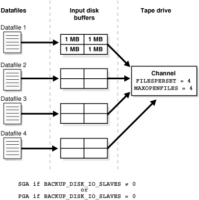

In the example shown in Figure 22-3, one channel is backing up four data files. MAXOPENFILES is set to 4 and FILESPERSET is set to 4. Thus, the level of multiplexing is 4. So, the total size of the buffers for each data file is 4 MB. The combined size of all the buffers is 16 MB.
Figure 22-3 Disk Buffer Allocation
Description of Figure 22-3 follows
Description of "Figure 22-3 Disk Buffer Allocation"

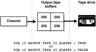

22.2.3.1.1 Allocation of Tape Buffers
If you back up to or restore from an SBT device, then by default the database allocates four buffers for each channel for the tape writers (or reads if restoring data as shown in Figure 22-4). The size of the tape I/O buffers is platform-dependent. You can change this value with the PARMS and BLKSIZE parameters of the ALLOCATE CHANNEL or CONFIGURE CHANNEL command.
Figure 22-4 Allocation of Tape Buffers
Description of Figure 22-4 follows
Description of "Figure 22-4 Allocation of Tape Buffers"

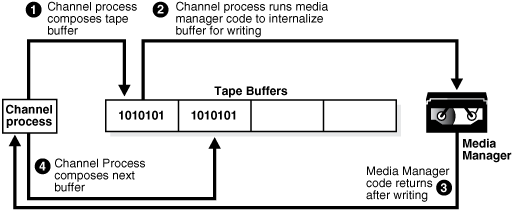

Figure 22-5 shows synchronous I/O in a backup to tape.
Figure 22-5 Synchronous Tape I/O
Description of Figure 22-5 follows
Description of "Figure 22-5 Synchronous Tape I/O"
The following steps occur:
  1. The channel process composes a tape buffer.
  2. The channel process executes media manager code that processes the tape buffer and internalizes it for further processing and storage by the media manager.
  3. The media manager code returns a message to the server process stating that it has completed writing.
  4. The channel process can initiate a new task.

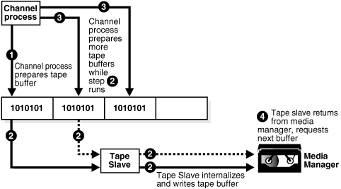

Figure 22-6 shows asynchronous I/O in a tape backup. Asynchronous I/O to tape is simulated by using tape child processes. In this case, each allocated channel corresponds to a server process, which in the explanation that follows is identified as a channel process. For each channel process, one tape child process is started (or more than one, if multiple copies exist).
Figure 22-6 Asynchronous Tape I/O
Description of Figure 22-6 follows
Description of "Figure 22-6 Asynchronous Tape I/O"
  1. A channel process writes blocks to a tape buffer.
  2. The channel process sends a message to the tape child process to process the tape buffer. The tape child process executes media manager code that processes the tape buffer and internalizes it so that the media manager can process it.
  3. While the tape child process is writing, the channel process is free to read data from the data files and prepare more output buffers.
  4. After the tape child channel returns from the media manager code, it requests a new tape buffer, which usually is ready. Thus waiting time for the channel process is reduced, and the backup is completed faster.

22.4.4.2 Tuning the Read Phase
Tuning the read phase can help to improve RMAN performance.
RMAN may not be able to send data blocks to the output device fast enough to keep it occupied. For example, during an incremental backup, RMAN only backs up blocks changed since a previous data file backup as part of the same strategy. If you do not turn on block change tracking, then RMAN must scan whole data files for changed blocks, and fill output buffers as it finds such blocks. If few blocks changed, and if RMAN is making an SBT backup, then RMAN may not fill output buffers fast enough to keep the tape drive streaming.
You can improve backup performance by adjusting the level of multiplexing, which is number of input files simultaneously read and then written into the same RMAN backup piece. The level of multiplexing is the minimum of the MAXOPENFILES setting on the channel and the number of input files placed in each backup set. The following table makes recommendations for adjusting the level of multiplexing.
Table 22-4 Adjusting the Level of Multiplexing
ASM Striped Disk Recommendation
No
Yes
Increase the level of multiplexing. Determine which is the minimum, MAXOPENFILES or the number of files in each backup set, and then increase this value.
In this way, you increase the rate at which RMAN fills tape buffers, which makes it more likely that buffers are sent to the media manager fast enough to maintain streaming.
No
No
Increase the MAXOPENFILES setting on the channel.
Yes
Not applicable
Set the MAXOPENFILES parameter on the channel to 1 or 2.
