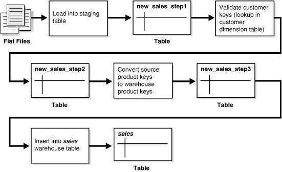

19.1.1.1 Multistage Data Transformation in Data Warehouses
The data transformation logic for most data warehouses consists of multiple steps. For example, in transforming new records to be inserted into a sales table, there may be separate logical transformation steps to validate each dimension key.
Figure 19-1 offers a graphical way of looking at the transformation logic.
Figure 19-1 Multistage Data Transformation
Description of "Figure 19-1 Multistage Data Transformation"
When using Oracle AI Database as a transformation engine, a common strategy is to implement each transformation as a separate SQL operation and to create a separate, temporary staging table (such as the tables new_sales_step1 and new_sales_step2 in Figure 19-1) to store the incremental results for each step. This load-then-transform strategy also provides a natural checkpointing scheme to the entire transformation process, which enables the process to be more easily monitored and restarted. However, a disadvantage to multistaging is that the space and time requirements increase.
It may also be possible to combine many simple logical transformations into a single SQL statement or single PL/SQL procedure. Doing so may provide better performance than performing each step independently, but it may also introduce difficulties in modifying, adding, or dropping individual transformations, as well as recovering from failed transformations.

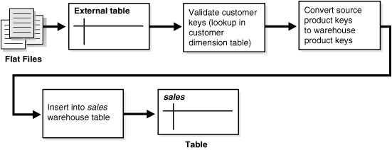

19.1.1.2 Pipelined Data Transformation in Data Warehouses
The ETL process flow can be changed dramatically and the database becomes an integral part of the ETL solution.
The new functionality renders some of the former necessary process steps obsolete while some others can be remodeled to enhance the data flow and the data transformation to become more scalable and non-interruptive. The task shifts from serial transform-then-load process (with most of the tasks done outside the database) or load-then-transform process, to an enhanced transform-while-loading.
Oracle offers a wide variety of new capabilities to address all the issues and tasks relevant in an ETL scenario. It is important to understand that the database offers toolkit functionality rather than trying to address a one-size-fits-all solution. The underlying database has to enable the most appropriate ETL process flow for a specific customer need, and not dictate or constrain it from a technical perspective. Figure 19-2 illustrates the new functionality, which is discussed throughout later sections.

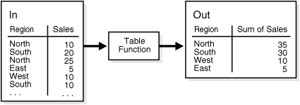

Figure 19-3 illustrates a typical aggregation where you input a set of rows and output a set of rows, in that case, after performing a SUM operation.
The pseudocode for this operation would be similar to:
INSERT INTO Out SELECT * FROM ("Table Function"(SELECT * FROM In));
The table function takes the result of the SELECT on In as input and delivers a set of records in a different format as output for a direct insertion into Out.

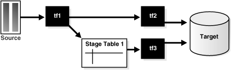

Additionally, a table function can fan out data within the scope of an atomic transaction. This can be used for many occasions like an efficient logging mechanism or a fan out for other independent transformations. In such a scenario, a single staging table is needed.
Figure 19-4 Pipelined Parallel Transformation with Fanout
Description of "Figure 19-4 Pipelined Parallel Transformation with Fanout"
The pseudocode for this would be similar to:
INSERT INTO target SELECT * FROM (tf2(SELECT * FROM (tf1(SELECT * FROM source))));
This inserts into target and, as part of tf1, into Stage Table 1 within the scope of an atomic transaction.
INSERT INTO target SELECT * FROM tf3(SELT * FROM stage_table1);
