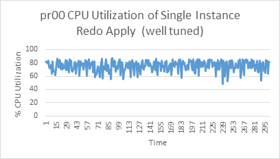

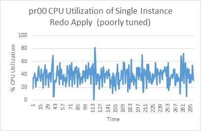

Gather
topprocess information to check if the recovery coordinator (PR00) is CPU bound by usingtoporpscommands.

During the apply phase it is normal to observe that the recovery coordinator process (pr00) has high utilization on a single CPU, while during the checkpoint phase there is an increase in DB writer processes (dbwn) CPU utilization indicating increased write I/O to the data files.

Single-instance redo apply (SIRA) has been completely tuned and is not I/O bound.
Recovery coordinator (PR00) is CPU bound.
Examine the CPU utilization of the recovery coordinator/log merger process ora_pr00_<SID> over a period of an hour. If the coordinator process has a CPU utilization % of over 70% for a majority of that time, this may be the bottleneck, and MIRA may improve recovery performance.
Shown here are two examples of output from the
topcommand showing the CPU utilization of the pr00.
If the recovery coordinator CPU utilization is largely below 70% with only a few short spikes, it is not CPU bound, and there is likely a resource issue or some additional tuning that will improve performance. If the recovery coordinator is not CPU bound, return to tuning SIRA.
