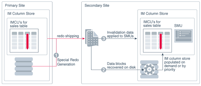

The following graphic illustrates the internal mechanism for updating a standby database with redo from the primary database.
The process is as follows:
The primary database generates redo, and then transfers the redo to the standby database.
The redo generated on the primary database for all DML statements includes metadata indicating whether the change is to an
INMEMORYobject. -
The standby database applies the redo to the data blocks stored in disk.
As the standby database applies redo generated from ongoing operations on the primary database, the standby database keeps them transactionally consistent.
If an
INMEMORYobject is modified, then the standby database invalidates the modified rows just as it does on the primary database, using the transaction journal and Snapshot Metadata Unit (SMU) to track the changes.
The repopulation mechanism works the same way in a standby database as it does in a primary database. When sufficient DML occurs on an object to reach an internal threshold, the standby database repopulates the object in the IM column store.
