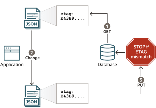

Figure 5-1 illustrates the process.
Figure 5-1 Optimistic Concurrency Control Process
Description of "Figure 5-1 Optimistic Concurrency Control Process"
Basing concurrency control on the actual persisted data/content is more powerful and more reliable than using locks or surrogate information such as document version numbers and timestamps.
Because they are value-based, Oracle ETAGs automatically synchronize updates to data in different documents. And they automatically ensure consistency between document updates and direct updates to underlying tables — document APIs and SQL applications can update the same data concurrently.
Steps 2 (modify locally) and 3 (write) are actually combined. When you
provide the modified document for an update operation you include the ETAG value
returned by a read operation, as the value of modified document's etag
field.
An attempted update operation fails if the current content of the document in
the database is different from that etag
field value, because it means
that something has changed the document in the database since you last read it. If the
operation fails, then you try again: read again to get the latest ETAG value, then try
again to update using that ETAG value in field etag

podium
, passing the ETAG value it obtained. Because of S4's update of the same row, this attempt fails. -
S3 tries again to update the row, using a fresh ETAG value. This attempt succeeds, and S3 commits the change.
-- S3 gets ETAG based on columns name, race_date, and podium.
SELECT SYS_ROW_ETAG(name, race_date, podium)
FROM race WHERE race_id = 201;
SYS_ROW_ETAG(NAME,RACE_DATE,PODIUM)
201FC3BA2EA5E94AA7D44D958873039D
-- S4 successfully updates column name of the same row.
UPDATE race SET name = 'Blue Air Bahrain Grand Prix'
1 row updated.
-- S3 unsuccessfully tries to update column podium.
-- It passes the ETAG value, to ensure it's OK to update.
UPDATE race SET podium =
'{"winner" : {"name" : "Charles Leclerc",
"time" : "01:37:33.584"},
"firstRunnerUp" : {"name" : "Carlos Sainz Jr",
"time" : "01:37:39.182"},
"secondRunnerUp" : {"name" : "Lewis Hamilton",
"time" : "01:37:43.259"}}'
WHERE race_id = 201
AND SYS_ROW_ETAG(name, race_date, podium) =
'201FC3BA2EA5E94AA7D44D958873039D';
0 rows updated.
-- S4 commits its update.
COMMIT;
Commit complete.
-- S3 gets a fresh ETAG value, and then tries again to update.
E847D5225C7F7024A25A0B53A275642A
WHERE race_id = 201
'E847D5225C7F7024A25A0B53A275642A';
1 row updated.
COMMIT;
Commit complete.
-- The data now reflects S4's name update and S3's podium update.
SELECT name, race_date, podium FROM race WHERE race_id = 201;
NAME RACE_DATE PODIUM
20-MAR-22
{"winner":{"name":"Charles Leclerc","time":"01:37:33.584"},"firstRunnerUp":{"nam
e":"Carlos Sainz Jr","time":"01:37:39.182"},"secondRunnerUp":{"name":"Lewis Hami
lton","time":"01:37:43.259"}}
1 row selected.
