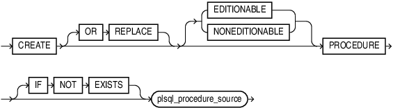

create_procedure
OR REPLACE
Re-creates the procedure if it exists, and recompiles it.
Users who were granted privileges on the procedure before it was redefined can still access the procedure without being regranted the privileges.
If any function-based indexes depend on the procedure, then the database marks the indexes DISABLED
[ EDITIONABLE | NONEDITIONABLE ]
Specifies whether the procedure is an editioned or noneditioned object if editioning is enabled for the schema object type PROCEDURE
in schema
. Default: EDITIONABLE
. For information about editioned and noneditioned objects, see Oracle Database Development Guide.
IF NOT EXISTS
Creates the procedure if it does not already exist. If a procedure by the same name does exist, the statement is ignored without error and the original procedure remains unchanged.
IF NOT EXISTS
cannot be used in combination with
OR REPLACE

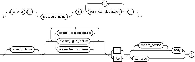

plsql_procedure_source
schema
Name of the schema containing the procedure. Default: your schema.
procedure_name
Name of the procedure to be created.
If you plan to invoke a stored subprogram using a stub generated by SQL*Module, then the stored subprogram name must also be a legal identifier in the invoking host 3GL language, such as Ada or C.
body
The required executable part of the procedure and, optionally, the exception-handling part of the procedure.
declare_section
The optional declarative part of the procedure. Declarations are local to the procedure, can be referenced in body
, and cease to exist when the procedure completes execution.
call_spec
The reference to a call specification mapping a C procedure, Java method name, or JavaScript function name, parameter types, and return type to their SQL counterparts.
