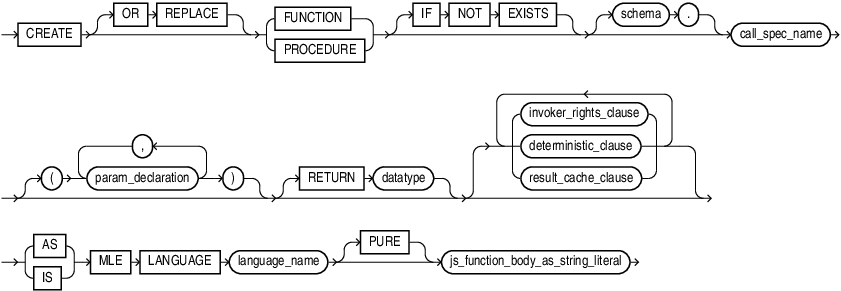

Components of an Inline MLE Call Specification
The elements of an inline MLE call specification are listed along with descriptions.
Figure 6-5 MLE Inline Call Specification Syntax
Table 6-2 Components of an Inline MLE Call Specification
| Element Name | Description |
OR REPLACE |
Specifies that the function should be replaced if it already exists. This clause can be used to change the definition of an existing function without dropping, recreating, and re-granting object privileges previously granted on the function. Users who had previously been granted privileges on a recreated function or procedure can still access the function without being re-granted the privileges. |
IF NOT EXISTS |
Specifies that the function should be created if it does not already exist. If a function by the same name does exist, the statement is ignored without error and the original function body remains unchanged. Note that SQL*Plus will display the same output message regardless of whether the command is ignored or executed, ensuring that your DDL scripts remain idempotent.
schema |
Specifies the schema that will contain the call specification. If the schema is omitted, the call specification is created in the schema of the current user. |
call_spec_name |
Specifies the name of the call specification to be created. Call specifications are created in the default namespace, unlike MLE modules and environments, which use dedicated namespaces. |
param_declaration |
Specifies the call specification's parameters. If no parameters are specified, parentheses must be omitted. |
RETURN datatype |
Only used for functions and specifies the data type of the return value of the function. The return value can have any data type supported by MLE. Only the data type is specified; length, precision, or scale information must be omitted. |
invoker_rights_clause |
Specifies whether a function is invoker's or definer's rights.
If the |
deterministic_clause |
Only used for functions and indicates that the function returns the same result value whenever it is called with the same values for its parameters. As with PL/SQL functions, this clause should not be used for functions that access the database in any way that might affect the return result of the function. The results of doing so will not be captured if the database chooses not to re-execute the function. |
MLE LANGUAGE |
Specifies the language of the following code, for example, JavaScript. The string following the language name is interpreted as MLE language code implementing the desired functionality. For JavaScript, this embedded code is interpreted as the body of a JavaScript function. |
PURE |
The PURE keyword specifies that the
function or procedure should be created in a restricted execution
context. During PURE execution, access to database state is
disallowed, providing an additional layer of security for
user-defined functions that do not require access to database state.
For more information, see About Restricted Execution Contexts.
