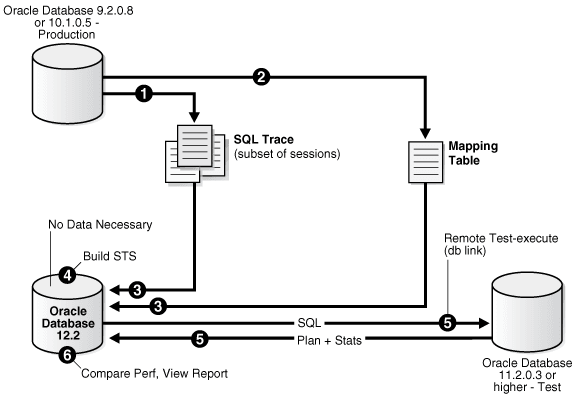

Because SQL Performance Analyzer only accepts a set of SQL statements stored in a SQL tuning set as its input source, and SQL tuning sets are not supported for Oracle9i Database, a SQL tuning set must be constructed so that it can be used as an input source for SQL Performance Analyzer if you are upgrading from Oracle9i Database.
Figure 8-1 SQL Performance Analyzer Workflow for Database Upgrade from Oracle9i or 10g Release 1 to Oracle Database 11g Release 2 or Higher
Description of Figure 8-1 follows
Description of "Figure 8-1 SQL Performance Analyzer Workflow for Database Upgrade from Oracle9i or 10g Release 1 to Oracle Database 11g Release 2 or Higher"
Before the database upgrade can be tested, ensure that the following conditions are met:
  • The production system which you are upgrading from is running Oracle9i (9.2.0.8) or Oracle Database 10g Release 1 (10.1.0.5).
  • The test system which you are upgrading to is running Oracle Database 11g Release 2 or higher.
    The database version can be release 11.2.0.3 or higher.
  • The test system must resemble the production system as closely as possible because the performance on both systems will be compared to each other.
  • The hardware configurations on both systems must also be as similar as possible.
You will also need to set up a separate SQL Performance Analyzer system running Oracle Database 12c Release 2. You will be using this system to build a SQL tuning set and to run SQL Performance Analyzer. Neither your production data or schema need to be available on this system, since the SQL tuning set will be built using statistics stored in the SQL trace files from the production system. SQL Performance Analyzer tasks will be executed remotely on the test system to generate the execution plan and statistics for the SQL trial over a database link that you specify. The database link must be a public database link that connects to a user with the EXECUTE privilege for the DBMS_SQLPA package and the ADVISOR privilege on the test system. You should also drop any existing PLAN_TABLE from the user's schema on the test system.
Once the upgrade environment is configured as described, perform the steps as described in the following procedure to use SQL Performance Analyzer in a database upgrade from Oracle9i or Oracle Database 10g Release 1 to a newer release.
  1. Enable the SQL Trace facility on the production system, as described in "Enabling SQL Trace on the Production System".
    To minimize the performance impact on the production system and still be able to fully capture a representative set of SQL statements, consider enabling SQL Trace for only a subset of the sessions, for as long as required, to capture all important SQL statements at least once.
  2. On the production system, create a mapping table, as described in "Creating a Mapping Table".
    This mapping table will be used to convert the user and object identifier numbers in the SQL trace files to their string equivalents.
  3. Move the SQL trace files and the mapping table from the production system to the SQL Performance Analyzer system, as described in "Creating a Mapping Table".
  4. On the SQL Performance Analyzer system, construct a SQL tuning set using the SQL trace files, as described in "Building a SQL Tuning Set".
    The SQL tuning set will contain the SQL statements captured in the SQL trace files, along with their relevant execution context and statistics.
  5. On the SQL Performance Analyzer system, use SQL Performance Analyzer to create a SQL Performance Analyzer task and convert the contents in the SQL tuning set into a pre-upgrade SQL trial that will be used as a baseline for comparison, then remotely test execute the SQL statements on the test system over a database link to build a post-upgrade SQL trial, as described in "Testing Database Upgrades from Oracle9i Database and Oracle Database 10g Release 1".
  6. Compare SQL performance and fix regressed SQL.
    SQL Performance Analyzer compares the performance of SQL statements read from the SQL tuning set during the pre-upgrade SQL trial to those captured from the remote test execution during the post-upgrade SQL trial. A report is produced to identify any changes in execution plans or performance of the SQL statements.
    If the report reveals any regressed SQL statements, you can make further changes to fix the regressed SQL, as described in "Tuning Regressed SQL Statements After Testing a Database Upgrade".
    Repeat the process of executing the SQL tuning set and comparing its performance to a previous execution to test any changes made until you are satisfied with the outcome of the analysis.

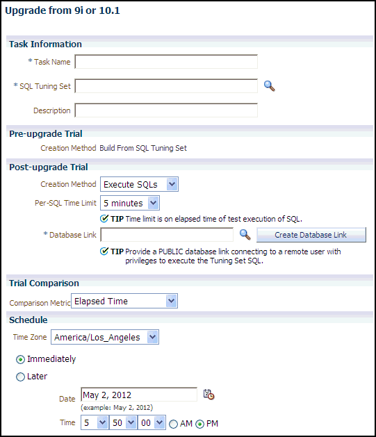

Testing Database Upgrades from Releases 9.x and 10.1 Using Cloud Control
To test a database upgrade from Oracle9i Database or Oracle Database 10g Release 1 using SQL Performance Analyzer:
  1. From the Performance menu, select SQL, then SQL Performance Analyzer.
    If the Database Login page appears, then log in as a user with administrator privileges.
    The SQL Performance Analyzer Home page appears.
  2. Under SQL Performance Analyzer Workflows, click Upgrade from 9i or 10.1.
    The Upgrade from 9i or higher releases page appears.
  3. Under Task Information:
    1. In the Task Name field, enter the name of the task.
    2. In the SQL Tuning Set field, enter the name of the SQL tuning set that was built.
      Alternatively, click the search icon to search for the SQL tuning set using the Search and Select: SQL Tuning Set window.
      The selected SQL tuning set now appears in the SQL Tuning Set field.
    3. In the Description field, optionally enter a description of the task.
  4. In the Creation Method field, select:
    • Execute SQLs to generate both execution plans and statistics for each SQL statement in the SQL tuning set by actually running the SQL statements remotely on the test system over a public database link.
    • Generate Plans to create execution plans remotely on the test system over a public database link without actually running the SQL statements.
  5. In the Per-SQL Time Limit list, determine the time limit for SQL execution during the trial by performing one of the following actions:
    • Select 5 minutes.
      The execution will run each SQL statement in the SQL tuning set up to 5 minutes and gather performance data.
    • Select Unlimited.
      The execution will run each SQL statement in the SQL tuning set to completion and gather performance data. Collecting execution statistics provides greater accuracy in the performance analysis but takes a longer time. Using this setting is not recommended because the task may be stalled by one SQL statement for a prolonged time period.
    • Select Customize and enter the specified number of seconds, minutes, or hours.
  6. In the Database Link field, enter the global name of a public database link connecting to a user with the EXECUTE privilege for the DBMS_SQLPA package and the ADVISOR privilege on the test system.
    Alternatively, click the search icon to search for and select a database link, or click Create Database Link to create a database link using the Create Database Link page.
  7. In the Comparison Metric list, select the comparison metric to use for the comparison analysis:
    • Elapsed Time
    • CPU Time
    • User I/O Time
    • Buffer Gets
    • Physical I/O
    • Optimizer Cost
    • I/O Interconnect Bytes
    Optimizer Cost is the only comparison metric available if you generated execution plans only in the SQL trials.
    To perform the comparison analysis by using more than one comparison metric, perform separate comparison analyses by repeating this procedure with different metrics.
  8. Under Schedule:
    1. In the Time Zone list, select your time zone code.
    2. Select Immediately to start the task now, or Later to schedule the task to start at a time specified using the Date and Time fields.
  9. Click Submit.
    In the SQL Performance Analyzer Tasks section, the status of this task is displayed. To refresh the status icon, click Refresh. After the task completes, the Status field changes to Completed.
  10. Under SQL Performance Analyzer Tasks, select the task and click the link in the Name column.
    The SQL Performance Analyzer Task page appears.
    This page contains the following sections:
    • SQL Tuning Set
      This section summarizes information about the SQL tuning set, including its name, owner, description, and the number of SQL statements it contains.
    • SQL Trials
      This section includes a table that lists the SQL trials used in the SQL Performance Analyzer task.
    • SQL Trial Comparisons
      This section contains a table that lists the results of the SQL trial comparisons
  11. Click the icon in the Comparison Report column.
    The SQL Performance Analyzer Task Result page appears.
  12. Review the results of the performance analysis, as described in "Reviewing the SQL Performance Analyzer Report Using Oracle Enterprise Manager".
    If regressed SQL statements are found following the database upgrade, tune them as described in "Tuning Regressed SQL Statements After Testing a Database Upgrade".

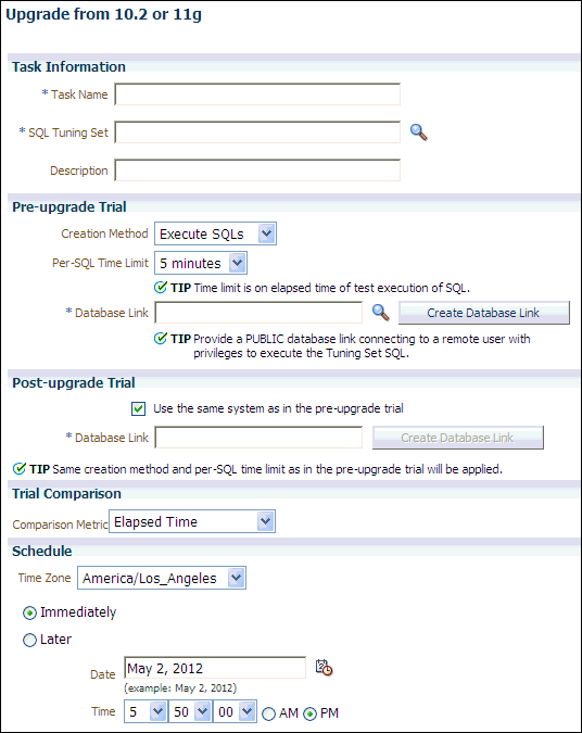

To test a database upgrade from Oracle Database 10g Release 2 or a newer release using SQL Performance Analyzer:
  2. Under SQL Performance Analyzer Workflows, click Upgrade from 10.2 or 11g.
    The Upgrade from 10.2 or higher releases page appears.
    • Select 5 minutes.
    • Select Unlimited.
  6. In the Database Link field, enter the global name of a public database link connecting to a user with the EXECUTE privilege for the DBMS_SQLPA package and the ADVISOR privilege on the pre-upgrade system.
  7. Under Post-upgrade Trial:
    1. Select Use the same system as in the pre-upgrade trial to use the same system for executing both the pre-upgrade and post-upgrade trials.
      Oracle recommends using this option to avoid possible errors due to different system configurations. When using this option, you will need to upgrade the test database to the higher database version before the post-upgrade trial is executed.
    2. In the Database Link field, enter the global name of a public database link connecting to a user with the EXECUTE privilege for the DBMS_SQLPA package and the ADVISOR privilege on the post-upgrade system.
  8. In the Comparison Metric list, select the comparison metric to use for the comparison analysis:
    • Elapsed Time
    • CPU Time
    • User I/O Time
    • Buffer Gets
    • Physical I/O
    • Optimizer Cost
  9. Under Schedule:
  10. Click Submit.
    If you are using the same system to execute both the pre-upgrade and post-upgrade trials, you will need to upgrade the database after the pre-upgrade trial step is completed. After the database is upgraded, the post-upgrade trial can be executed. After the task completes, the Status field changes to Completed.
  11. Under SQL Performance Analyzer Tasks, select the task and click the link in the Name column.
