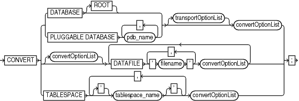

convert::=
(transportOptionList::=, convertOptionList::=)
Semantics
This clause specifies the objects to be converted: data files, tablespaces, or database.

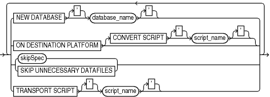

transportOptionList
This clause specifies options for the data files, tablespaces, or database to be transported.
skipSpec
This subclause specifies which files are excluded from the conversion.
convertOptionList
This subclause specifies input and output options for the conversion.
You can use either the FORMAT or fileNameConversionSpec arguments to control the names of the output files generated by the CONVERT command. If you do not specify either, then the rules governing the location of the output files equal those governing the output files from a BACKUP AS COPY operation. These rules are described in the backupTypeSpec entry.

TRANSPORT SCRIPT '/tmp/transport_newdb.sql'
NEW DATABASE 'prodaix'
DB_FILE_NAME_CONVERT '/u01/oradata/DBUA/datafile','+DATA';
