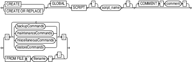

Syntax
createScript::=
backupCommands::=, maintenanceCommands::=, miscellaneousCommands::=, restoreCommands::=)
Semantics
Syntax Element | Description |
Creates a new script, if a script with the specified name does not exist. If a script with the specified name already exists, it is recreated. |
Identifies the script as global. Note: A virtual private catalog has read-only access to global scripts. Creating or updating global scripts must be done while connected to the base recovery catalog. |
Specifies the name of the script. Quotes must be used around the script name when the name contains either spaces or reserved words. |
Associates an explanatory comment with the stored script in the recovery catalog. The comment is used in the output of |
Specifies commands to include in the stored script. The commands allowable within the brackets of the |
Reads the sequence of commands to define the script from the specified file. The file looks like the body of a valid stored script. The first line of the file must be a left brace ( |
