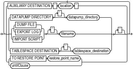

transpt_tbs_optlist
This subclause specifies optional parameters that affect the tablespace transport.
| Syntax Element | Description |
AUXILIARY DESTINATION'location' |
Specifies the location for files for the auxiliary instance. You can use See Also: Oracle AI Database Backup and Recovery User’s Guide for details on the interactions among the different techniques for naming the auxiliary instance files |
DATAPUMP DIRECTORY datapump_directory |
Specifies a database directory object where Data Pump Export outputs are created (see Example 3-82). If not specified, then RMAN creates files in the location specified by See Also: Oracle AI Database Utilities for more details on Data Pump Export and database directory objects |
Specifies where to create the Data Pump Export dump file. If not specified, the export dump file is named Note: If a file under the name of the export dump file exists in the tablespace destination, then |
Specifies the location of the log generated by Data Pump Export. If omitted, the export log is named |
Specifies the file name for the sample input script generated by RMAN for use in plugging in the transported tablespace at the destination database. If omitted, the import script is named |
TABLESPACE DESTINATION tablespace_destination |
Specifies the location of the data files for the transported tablespaces after the tablespace transport operation completes. |
TO RESTORE POINT restore_point_name |
Specifies a restore point for tablespace restore and recovery, with the SCN at which the restore point was created as the upper, inclusive limit. Because the limit is inclusive, RMAN selects only files that it can use to restore or recover tablespaces up to and including the SCN corresponding to the restore point. |
Specifies a past time, SCN, or log sequence number (see Example 3-81). If specified, RMAN restores and recovers the tablespaces at the auxiliary instance to their contents at that past point in time before export. If you rename a tablespace, then you cannot use this command to create a transportable tablespace set as of a point in time before the tablespace was renamed. RMAN has no knowledge of the previous name of the tablespace. Tablespaces including undo segments as of the |
