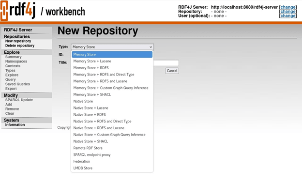

  5. Verify that Oracle is not listed as a default repository in the drop-down in the following Figure 12-1.
    Figure 12-1 Data Source Repository in RDF4J Workbench
    Description of Figure 12-1 follows
    Description of "Figure 12-1 Data Source Repository in RDF4J Workbench"
    If the Oracle data source repository is already set up in the RDF4J Workbench repository, then it will appear in the preceding drop-down list.

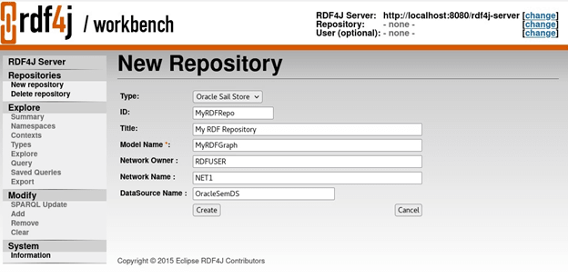

  5. Create the configuration file create-oracle.xsl within the Tomcat $CATALINA_HOME/webapps/rdf4j-workbench/transformations folder.
    <?xml version="1.0" encoding="UTF-8"?>
    <xsl:stylesheet version="1.0"
      xmlns:xsl="http://www.w3.org/1999/XSL/Transform"
      xmlns:sparql="http://www.w3.org/2005/sparql-results#"
      xmlns="http://www.w3.org/1999/xhtml">
      <xsl:include href="../locale/messages.xsl" />
      <xsl:variable name="title">
      <xsl:value-of select="$repository-create.title" />
      </xsl:variable>
      <xsl:include href="template.xsl" />
      <xsl:template match="sparql:sparql">
        <form action="create" method="post">
          <table class="dataentry">
            <tbody>
              <tr>
                <th>
                  <xsl:value-of select="$repository-type.label" />
                </th>
                <td>
                  <select id="type" name="type">
                    <option value="oracle"> Oracle Sail Store </option>
                  </select>
                </td>
                <td></td>
              </tr>
              <tr>
                <th>
                  <xsl:value-of select="$repository-id.label" />
                </th>
                <td>
                  <input type="text" id="id" name="Repository ID"
                    size="16" value="native" />
                </td>
                <td></td>
              </tr>
              <tr>
                <th>
                  <xsl:value-of select="$repository-title.label" />
                </th>
                <td>
                  <input type="text" id="title" name="Repository title" size="50"
                    value="Native store" />
                </td>
                <td></td>
              </tr>
              <tr>
                <th> Model Name <strong style="color:Red">*</strong> </th>
                <td>
                  <input type="text" id="oracleSemModelName" name="Model Name" size="50" value="" />
                </td>
                <td></td>
              </tr>
              <tr>
                <th> Network Owner </th>
                <td>
                  <input type="text" id="oracleSemNetworkOwner" name="Network Owner" size="50" value="" />
                </td>
                <td></td>
              </tr>
              <tr>
                <th> Network Name </th>
                <td>
                  <input type="text" id="oracleSemNetworkName" name="Network Name" size="50" value="" />
                </td>
                <td></td>
              </tr>
              <tr>
                <th> DataSource Name </th>
                <td>
                  <input type="text" id="oracleSemDataSourceName" name="DataSource Name" size="30" value="OracleSemDS" />
                </td>
                <td></td>
              </tr>
              <tr>
                <td></td>
                <td>
                  <input type="button" value="{$cancel.label}"
                      style="float:right" data-href="repositories"
                      onclick="document.location.href=this.getAttribute('data-href')" />
                  <input id="create" type="button" value="{$create.label}"
                      onclick="checkOverwrite()" />
                </td>
              </tr>
            </tbody>
          </table>
        </form>
      <script src="../../scripts/create.js" type="text/javascript"></script>
      </xsl:template>
    </xsl:stylesheet>

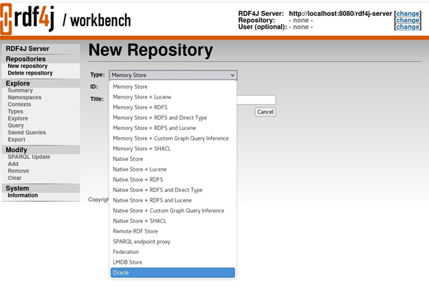

  7. Restart Tomcat and navigate to https://localhost:8080/rdf4j-workbench.
The configuration files, create-oracle.xsl and create.xsl contain the word "Oracle", which you can see in the drop-down in Figure 12-2
"Oracle" appears as an option in the drop-down list in RDF4J Workbench.
Figure 12-2 RDF4J Workbench Repository

  1. Start RDF4J Workbench by entering the url https://localhost:8080/rdf4j-workbench in your browser.
  2. Click New Repository in the sidebar menu and select the new repository Type as "Oracle".

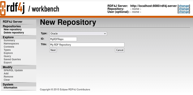

  3. Enter the new repository ID and Title as shown in the following figure and click Next.
    Figure 12-3 RDF4J Workbench New Repository
  4. Enter your Model (RDF graph) details and click Create to create the new repository.
    Figure 12-4 Create New Repository in RDF4J Workbench

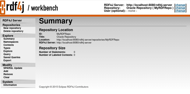

    The newly created repository summary is display as shown:
    Figure 12-5 Summary of New Repository in RDF4J Workbench

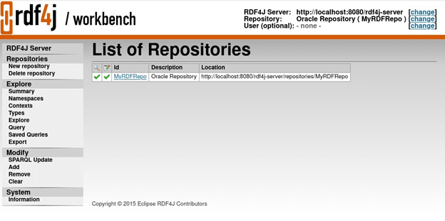

    You can also view the newly created repository in the List of Repositories page in RDF4J Workbench.
    Figure 12-6 List of Repositories
