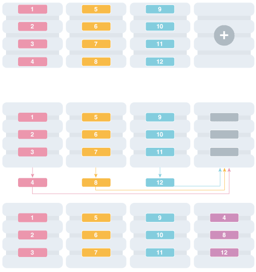

Resharding and Hot Spot Elimination
The process of redistributing data between shards, triggered by a change in the number of shards, is called resharding. Automatic resharding is a feature of the system-managed sharding method that provides elastic scalability of a distributed database.
Sometimes data in a distributed database needs to be migrated from one shard to another. Data migration across shards is required in the following cases:
When one or multiple shards are added to or removed from a distributed database
When there is skew in the data or workload distribution across shards
The unit of data migration between shards is the chunk. Migrating data in chunks guaranties that related data from different sharded tables are moved together.
When a shard is added to or removed from a distributed database, multiple chunks are migrated to maintain a balanced distribution of chunks and workload across shards.
Depending on the sharding method, resharding happens automatically (system-managed) or is directed by the user (composite). The following figure shows the stages of automatic resharding when a shard is added to a distributed database with three shards.
Figure 9-7 Resharding a Distributed Database
Description of "Figure 9-7 Resharding a Distributed Database"
