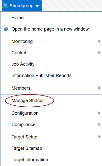

Shards are managed from within their respective shardgroups. To manage a shard you must first navigate to the shardgroup which contains the shard you wish to manage. This can be done from the All Targets page or the Globally Distributed Database page.
In the Shardgroup page, open the Shardgroup menu, located in the top left corner of the shardgroup target page, and choose Manage Shards.
Figure 9-6 Shardgroup Menu
shardgroup menu with Manage Shards
If prompted, enter the shard catalog credentials, select the shard director to manage under Shard Director Credentials, select the shard director host credentials, and log in.

Editing a Shard
You can update a shard's CPU Utilization Threshold (%), Disk Threshold (ms), ONS Port, SCAN Address, Connect Descriptor, and GSMUSER Password in the Manage Shards page in Oracle Enterprise Management Cloud Control.
  1. In the Shardgroup page, open the Shardgroup menu, located in the top left corner of the shardgroup target page, and choose Manage Shards.
  2. If prompted, enter the shard catalog credentials, select the shard director to manage under Shard Director Credentials, select the shard director host credentials, and log in.
  3. In the Manage Shards page, select a shard from the list and click Edit.
  4. Click OK to save any changes made in the Edit Shard dialog.
Removing a Shard
You can remove a shard from your distributed database configuration in the Manage Shards page in Oracle Enterprise Management Cloud Control.
  3. In the Manage Shards page, select a shard from the list and click Remove.
    Use the Force option to remove the specified shard even if it is inaccessible and/or contains chunks. Using this option might result in a lower number of replicas or total unavailability for a certain range of data.
  4. Click OK to confirm that you want to remove the shard.
