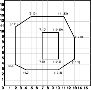

2.7.2 Polygon with a Hole
Figure 2-4 illustrates a polygon consisting of two elements: an exterior polygon ring and an interior polygon ring. The inner element in this example is treated as a void (a hole).
In the SDO_GEOMETRY definition of the geometry illustrated in Figure 2-4:
SDO_GTYPE = SDO_POLYGON2D. This indicates a two-dimensional polygon.
SDO_SRID = NULL.
SDO_POINT = NULL.
SDO_ELEM_INFO = (1,1003,1, 19,2003,1). There are two triplet elements: 1,1003,1 and 19,2003,1.
1003 indicates that the element is an exterior polygon ring; 2003 indicates that the element is an interior polygon ring.
19 indicates that the second element (the interior polygon ring) ordinate specification starts at the 19th number in the SDO_ORDINATES array (that is, 7, meaning that the first point is 7,5).
SDO_ORDINATES = (2,4, 4,3, 10,3, 13,5, 13,9, 11,13, 5,13, 2,11, 2,4, 7,5, 7,10, 10,10, 10,5, 7,5).
The area (SDO_GEOM.SDO_AREA function) of the polygon is the area of the exterior polygon minus the area of the interior polygon. In this example, the area is 84 (99 - 15).
The perimeter (SDO_GEOM.SDO_LENGTH function) of the polygon is the perimeter of the exterior polygon plus the perimeter of the interior polygon. In this example, the perimeter is 52.9193065 (36.9193065 + 16).
Example 2-9 SQL Statement to Insert a Polygon with a Hole
Example 2-9 shows a SQL statement that inserts the geometry illustrated in Figure 2-4 into the database.
INSERT INTO cola_markets VALUES( 10, 'polygon_with_hole', SDO_GEOMETRY( SDO_POLYGON2D, -- two-dimensional polygon NULL, NULL, SDO_ELEM_INFO_ARRAY(1,1003,1, 19,2003,1), -- polygon with hole SDO_ORDINATE_ARRAY(2,4, 4,3, 10,3, 13,5, 13,9, 11,13, 5,13, 2,11, 2,4, 7,5, 7,10, 10,10, 10,5, 7,5) ) );
An example of such a "polygon with a hole" might be a land mass (such as a country or an island) with a lake inside it. Of course, an actual land mass might have many such interior polygons: each one would require a triplet element in SDO_ELEM_INFO, plus the necessary ordinate specification.
Exterior and interior rings cannot be nested. For example, if a country has a lake and there is an island in the lake (and perhaps a lake on the island), a separate polygon must be defined for the island; the island cannot be defined as an interior polygon ring within the interior polygon ring of the lake.
In a multipolygon (polygon collection), rings must be grouped by polygon, and the first ring of each polygon must be the exterior ring. For example, consider a polygon collection that contains two polygons (A and B):
Polygon A (one interior "hole"): exterior ring A0, interior ring A1
Polygon B (two interior "holes"): exterior ring B0, interior ring B1, interior ring B2
The elements in SDO_ELEM_INFO and SDO_ORDINATES must be in one of the following orders (depending on whether you specify Polygon A or Polygon B first):
A0, A1; B0, B1, B2
B0, B1, B2; A0, A1
Parent topic: Geometry Examples

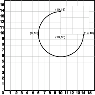

2.7.3 Compound Line String
Figure 2-5 illustrates a crescent-shaped object represented as a compound line string made up of one straight line segment and one circular arc. Four points are required to represent this shape: points (10,10) and (10,14) describe the straight line segment, and points (10,14), (6,10), and (14,10) describe the circular arc.
In the SDO_GEOMETRY definition of the geometry illustrated in Figure 2-5:
SDO_GTYPE = SDO_CURVE2D. The first indicates a two-dimensional line segment.
SDO_SRID = NULL.
SDO_POINT = NULL.
SDO_ELEM_INFO = (1,4,2, 1,2,1, 3,2,2). There are three triplet elements: 1,4,2, 1,2,1, and 3,2,2.
The first triplet indicates that this element is a compound line string made up of two subelement line strings, which are described with the next two triplets.
The second triplet indicates that the line string is made up of straight line segments and that the ordinates for this line string start at offset 1. The end point of this line string is determined by the starting offset of the second line string, 3 in this instance.
The third triplet indicates that the second line string is made up of circular arcs with ordinates starting at offset 3. The end point of this line string is determined by the starting offset of the next element or the current length of the SDO_ORDINATES array, if this is the last element.
SDO_ORDINATES = (10,10, 10,14, 6,10, 14,10).
Example 2-10 shows a SQL statement that inserts the geometry illustrated in Figure 2-5 into the database.
Example 2-10 SQL Statement to Insert a Compound Line String
INSERT INTO cola_markets VALUES( 11, 'compound_line_string', SDO_GEOMETRY( SDO_CURVE2D, NULL, NULL, SDO_ELEM_INFO_ARRAY(1,4,2, 1,2,1, 3,2,2), -- compound line string SDO_ORDINATE_ARRAY(10,10, 10,14, 6,10, 14,10) ) );

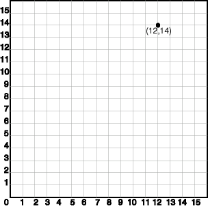

2.7.5 Point
Figure 2-7 illustrates a point-only geometry at coordinates (12,14).
In the SDO_GEOMETRY definition of the geometry illustrated in Figure 2-7:
SDO_GTYPE = SDO_POINT2D. This indicates a two-dimensional single point.
SDO_SRID = NULL.
SDO_POINT = SDO_POINT_TYPE(12, 14, NULL). The SDO_POINT attribute is defined using the SDO_POINT_TYPE object type, because this is a point-only geometry.
For more information about the SDO_POINT attribute, see SDO_POINT.
SDO_ELEM_INFO and SDO_ORDINATES are both NULL, as required if the SDO_POINT attribute is specified.
Example 2-12 shows a SQL statement that inserts the geometry illustrated in Figure 2-7 into the database.
Example 2-12 SQL Statement to Insert a Point-Only Geometry
INSERT INTO cola_markets VALUES( 90, 'point_only', SDO_GEOMETRY( SDO_POINT2D, NULL, SDO_POINT_TYPE(12, 14, NULL), NULL, NULL));
You can search for point-only geometries based on the X, Y, and Z values in the SDO_POINT_TYPE specification. Example 2-13 is a query that asks for all points whose first coordinate (the X value) is 12, and it finds the point that was inserted in Example 2-12.
Example 2-13 Query for Point-Only Geometry Based on a Coordinate Value
SELECT * from cola_markets c WHERE c.shape.SDO_POINT.X = 12; MKT_ID NAME ---------- -------------------------------- SHAPE(SDO_GTYPE, SDO_SRID, SDO_POINT(X, Y, Z), SDO_ELEM_INFO, SDO_ORDINATES) -------------------------------------------------------------------------------- 90 point_only SDO_GEOMETRY(2001, NULL, SDO_POINT_TYPE(12, 14, NULL), NULL, NULL)

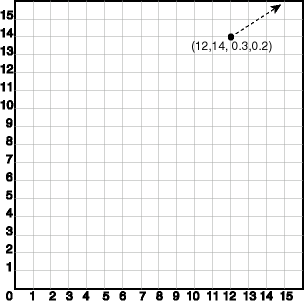

2.7.6 Oriented Point
An oriented point is a special type of point geometry that includes coordinates representing the locations of the point and a virtual end point, to indicate an orientation vector that can be used for rotating a symbol at the point or extending a label from the point. The main use for an oriented point is in map visualization and display applications that include symbols, such as a shield symbol to indicate a highway.
To specify an oriented point:
Use an SDO_GTYPE value (explained in SDO_GTYPE) for a point or multipoint geometry.
Specify a null value for the SDO_POINT attribute.
In the SDO_ELEM_INFO array (explained in SDO_ELEM_INFO), specify an additional triplet, with the second and third values (SDO_ETYPE and SDO_INTERPRETATION) as 1 and 0. For example, a triplet of 3,1,0 indicates that the point is an oriented point, with the third number in the SDO_ORDINATES array being the first coordinate, or x-axis value, of the end point reflecting the orientation vector for any symbol or label.
In the SDO_ORDINATES array (explained in SDO_ORDINATES), specify the coordinates of the end point for the orientation vector from the point, with values between -1 and 1. The orientation start point is assumed to be (0,0), and it is translated to the location of the physical point to which it corresponds.
Figure 2-8 illustrates an oriented point geometry at coordinates (12,14), with an orientation vector of approximately 34 degrees (counterclockwise from the x-axis), reflecting the orientation coordinates 0.3,0.2. (To have an orientation that more precisely matches a specific angle, refer to the cotangent or tangent values in the tables in a trigonometry textbook.) The orientation vector in this example goes from (0,0) to (0.3,0.2) and extends onward. Assuming i=0.3 and j=0.2, the angle in radians can be calculated as follows: angle in radians = arctan (j/i). The angle is then applied to the physical point associated with the orientation vector.
In the SDO_GEOMETRY definition of the geometry illustrated in Figure 2-8:
SDO_SRID = NULL.
SDO_POINT = NULL.
SDO_ELEM_INFO = (1,1,1, 3,1,0). The final 1,0 in 3,1,0 indicates that this is an oriented point.
SDO_ORDINATES = (12,14, 0.3,0.2). The 12,14 identifies the physical coordinates of the point; and the 0.3,0.2 identifies the x and y coordinates (assuming 12,14 as the origin) of the end point of the orientation vector. The resulting orientation vector slopes upward at about a 34-degree angle.
Example 2-14 shows a SQL statement that inserts the geometry illustrated in Figure 2-8 into the database.
Example 2-14 SQL Statement to Insert an Oriented Point Geometry
INSERT INTO cola_markets VALUES( 91, 'oriented_point', SDO_GEOMETRY( SDO_POINT2D, NULL, NULL, SDO_ELEM_INFO_ARRAY(1,1,1, 3,1,0), SDO_ORDINATE_ARRAY(12,14, 0.3,0.2)));
The following guidelines apply to the definition of an oriented point:
The numbers defining the orientation vector must be between -1 and 1. (In Example 2-14, these numbers are 0.3 and 0.2.)
Multipoint oriented points are allowed (see Example 2-15), but the orientation information must follow the point being oriented.
The following considerations apply to the dimensionality of the orientation vector for an oriented point:
A two-dimensional point has a two-dimensional orientation vector.
A two-dimensional point with an LRS measure (SDO_GTYPE=3301) has a two-dimensional orientation vector.
A three-dimensional point (SDO_GTYPE=SDO_POINT3D) has a three-dimensional orientation vector.
A three-dimensional point with an LRS measure (SDO_GTYPE=4401) has a three-dimensional orientation vector.
A four-dimensional point (SDO_GTYPE=4001) has a three-dimensional orientation vector.
Example 2-15 SQL Statement to Insert an Oriented Multipoint Geometry
Example 2-15 shows a SQL statement that inserts an oriented multipoint geometry into the database. The multipoint geometry contains two points, at coordinates (12,14) and (12, 10), with the two points having different orientation vectors. The statement is similar to the one in Example 2-14, but in Example 2-15 the second point has an orientation vector pointing down and to the left at 45 degrees (or, 135 degrees clockwise from the x-axis), reflecting the orientation coordinates -1,-1.
-- Oriented multipoint: 2 points, different orientations INSERT INTO cola_markets VALUES( 92, 'oriented_multipoint', SDO_GEOMETRY( SDO_MULTIPOINT2D, -- Multipoint NULL, NULL, SDO_ELEM_INFO_ARRAY(1,1,1, 3,1,0, 5,1,1, 7,1,0), SDO_ORDINATE_ARRAY(12,14, 0.3,0.2, 12,10, -1,-1)));

2.7.9 Several Two-Dimensional Geometry Types
Example 2-19 creates a table and inserts various two-dimensional geometries, including multipoints (point clusters), multipolygons, and collections. At the end, it calls the SDO_GEOM.VALIDATE_GEOMETRY_WITH_CONTEXT function to validate the inserted geometries. Note that some geometries are deliberately invalid, and their descriptions include the string INVALID
Example 2-19 SQL Statements to Insert Various Two-Dimensional Geometries
CREATE TABLE t1 ( i NUMBER, d VARCHAR2(50), g SDO_GEOMETRY ); INSERT INTO t1 (i, d, g) VALUES ( 1, 'Point', sdo_geometry (SDO_POINT2D, null, null, sdo_elem_info_array (1,1,1), sdo_ordinate_array (10,5)) ); INSERT INTO t1 (i, d, g) VALUES ( 2, 'Line segment', sdo_geometry (SDO_LINESTRING2D, null, null, sdo_elem_info_array (1,2,1), sdo_ordinate_array (10,10, 20,10)) ); INSERT INTO t1 (i, d, g) VALUES ( 3, 'Arc segment', sdo_geometry (SDO_LINESTRING2D, null, null, sdo_elem_info_array (1,2,2), sdo_ordinate_array (10,15, 15,20, 20,15)) ); INSERT INTO t1 (i, d, g) VALUES ( 4, 'Line string', sdo_geometry (SDO_LINESTRING2D, null, null, sdo_elem_info_array (1,2,1), sdo_ordinate_array (10,25, 20,30, 25,25, 30,30)) ); INSERT INTO t1 (i, d, g) VALUES ( 5, 'Arc string', sdo_geometry (SDO_LINESTRING2D, null, null, sdo_elem_info_array (1,2,2), sdo_ordinate_array (10,35, 15,40, 20,35, 25,30, 30,35)) ); INSERT INTO t1 (i, d, g) VALUES ( 6, 'Compound line string', sdo_geometry (SDO_LINESTRING2D, null, null, sdo_elem_info_array (1,4,3, 1,2,1, 3,2,2, 7,2,1), sdo_ordinate_array (10,45, 20,45, 23,48, 20,51, 10,51)) ); INSERT INTO t1 (i, d, g) VALUES ( 7, 'Closed line string', sdo_geometry (SDO_LINESTRING2D, null, null, sdo_elem_info_array (1,2,1), sdo_ordinate_array (10,55, 15,55, 20,60, 10,60, 10,55)) ); INSERT INTO t1 (i, d, g) VALUES ( 8, 'Closed arc string', sdo_geometry (SDO_LINESTRING2D, null, null, sdo_elem_info_array (1,2,2), sdo_ordinate_array (15,65, 10,68, 15,70, 20,68, 15,65)) ); INSERT INTO t1 (i, d, g) VALUES ( 9, 'Closed mixed line', sdo_geometry (SDO_LINESTRING2D, null, null, sdo_elem_info_array (1,4,2, 1,2,1, 7,2,2), sdo_ordinate_array (10,78, 10,75, 20,75, 20,78, 15,80, 10,78)) ); INSERT INTO t1 (i, d, g) VALUES ( 10, 'Self-crossing line', sdo_geometry (SDO_LINESTRING2D, null, null, sdo_elem_info_array (1,2,1), sdo_ordinate_array (10,85, 20,90, 20,85, 10,90, 10,85)) ); INSERT INTO t1 (i, d, g) VALUES ( 11, 'Polygon', sdo_geometry (SDO_POLYGON2D, null, null, sdo_elem_info_array (1,1003,1), sdo_ordinate_array (10,105, 15,105, 20,110, 10,110, 10,105)) ); INSERT INTO t1 (i, d, g) VALUES ( 12, 'Arc polygon', sdo_geometry (SDO_POLYGON2D, null, null, sdo_elem_info_array (1,1003,2), sdo_ordinate_array (15,115, 20,118, 15,120, 10,118, 15,115)) ); INSERT INTO t1 (i, d, g) VALUES ( 13, 'Compound polygon', sdo_geometry (SDO_POLYGON2D, null, null, sdo_elem_info_array (1,1005,2, 1,2,1, 7,2,2), sdo_ordinate_array (10,128, 10,125, 20,125, 20,128, 15,130, 10,128)) ); INSERT INTO t1 (i, d, g) VALUES ( 14, 'Rectangle', sdo_geometry (SDO_POLYGON2D, null, null, sdo_elem_info_array (1,1003,3), sdo_ordinate_array (10,135, 20,140)) ); INSERT INTO t1 (i, d, g) VALUES ( 15, 'Circle', sdo_geometry (SDO_POLYGON2D, null, null, sdo_elem_info_array (1,1003,4), sdo_ordinate_array (15,145, 10,150, 20,150)) ); INSERT INTO t1 (i, d, g) VALUES ( 16, 'Point cluster', sdo_geometry (SDO_MULTIPOINT2D, null, null, sdo_elem_info_array (1,1,3), sdo_ordinate_array (50,5, 55,7, 60,5)) ); INSERT INTO t1 (i, d, g) VALUES ( 17, 'Multipoint', sdo_geometry (SDO_MULTIPOINT2D, null, null, sdo_elem_info_array (1,1,1, 3,1,1, 5,1,1), sdo_ordinate_array (65,5, 70,7, 75,5)) ); INSERT INTO t1 (i, d, g) VALUES ( 18, 'Multiline', sdo_geometry (SDO_MULTICURVE2D, null, null, sdo_elem_info_array (1,2,1, 5,2,1), sdo_ordinate_array (50,15, 55,15, 60,15, 65,15)) ); INSERT INTO t1 (i, d, g) VALUES ( 19, 'Multiline - crossing', sdo_geometry (SDO_MULTICURVE2D, null, null, sdo_elem_info_array (1,2,1, 5,2,1), sdo_ordinate_array (50,22, 60,22, 55,20, 55,25)) ); INSERT INTO t1 (i, d, g) VALUES ( 20, 'Multiarc', sdo_geometry (SDO_MULTICURVE2D, null, null, sdo_elem_info_array (1,2,2, 7,2,2), sdo_ordinate_array (50,35, 55,40, 60,35, 65,35, 70,30, 75,35)) ); INSERT INTO t1 (i, d, g) VALUES ( 21, 'Multiline - closed', sdo_geometry (SDO_MULTICURVE2D, null, null, sdo_elem_info_array (1,2,1, 9,2,1), sdo_ordinate_array (50,55, 50,60, 55,58, 50,55, 56,58, 60,55, 60,60, 56,58)) ); INSERT INTO t1 (i, d, g) VALUES ( 22, 'Multiarc - touching', sdo_geometry (SDO_MULTICURVE2D, null, null, sdo_elem_info_array (1,2,2, 7,2,2), sdo_ordinate_array (50,65, 50,70, 55,68, 55,68, 60,65, 60,70)) ); INSERT INTO t1 (i, d, g) VALUES ( 23, 'Multipolygon - disjoint', sdo_geometry (SDO_MULTIPOLYGON2D, null, null, sdo_elem_info_array (1,1003,1, 11,1003,3), sdo_ordinate_array (50,105, 55,105, 60,110, 50,110, 50,105, 62,108, 65,112)) ); INSERT INTO t1 (i, d, g) VALUES ( 24, 'Multipolygon - touching', sdo_geometry (SDO_MULTIPOLYGON2D, null, null, sdo_elem_info_array (1,1003,3, 5,1003,3), sdo_ordinate_array (50,115, 55,120, 55,120, 58,122)) ); INSERT INTO t1 (i, d, g) VALUES ( 25, 'Multipolygon - tangent * INVALID 13351', sdo_geometry (SDO_MULTIPOLYGON2D, null, null, sdo_elem_info_array (1,1003,3, 5,1003,3), sdo_ordinate_array (50,125, 55,130, 55,128, 60,132)) ); INSERT INTO t1 (i, d, g) VALUES ( 26, 'Multipolygon - multi-touch', sdo_geometry (SDO_MULTIPOLYGON2D, null, null, sdo_elem_info_array (1,1003,1, 17,1003,1), sdo_ordinate_array (50,95, 55,95, 53,96, 55,97, 53,98, 55,99, 50,99, 50,95, 55,100, 55,95, 60,95, 60,100, 55,100)) ); INSERT INTO t1 (i, d, g) VALUES ( 27, 'Polygon with void', sdo_geometry (SDO_POLYGON2D, null, null, sdo_elem_info_array (1,1003,3, 5,2003,3), sdo_ordinate_array (50,135, 60,140, 51,136, 59,139)) ); INSERT INTO t1 (i, d, g) VALUES ( 28, 'Polygon with void - reverse', sdo_geometry (SDO_POLYGON2D, null, null, sdo_elem_info_array (1,2003,3, 5,1003,3), sdo_ordinate_array (51,146, 59,149, 50,145, 60,150)) ); INSERT INTO t1 (i, d, g) VALUES ( 29, 'Crescent (straight lines) * INVALID 13349', sdo_geometry (SDO_POLYGON2D, null, null, sdo_elem_info_array (1,1003,1), sdo_ordinate_array (10,175, 10,165, 20,165, 15,170, 25,170, 20,165, 30,165, 30,175, 10,175)) ); INSERT INTO t1 (i, d, g) VALUES ( 30, 'Crescent (arcs) * INVALID 13349', sdo_geometry (SDO_POLYGON2D, null, null, sdo_elem_info_array (1,1003,2), sdo_ordinate_array (14,180, 10,184, 14,188, 18,184, 14,180, 16,182, 14,184, 12,182, 14,180)) ); INSERT INTO t1 (i, d, g) VALUES ( 31, 'Heterogeneous collection', sdo_geometry (SDO_COLLECTION2D, null, null, sdo_elem_info_array (1,1,1, 3,2,1, 7,1003,1), sdo_ordinate_array (10,5, 10,10, 20,10, 10,105, 15,105, 20,110, 10,110, 10,105)) ); INSERT INTO t1 (i, d, g) VALUES ( 32, 'Polygon+void+island touch', sdo_geometry (SDO_MULTIPOLYGON2D, null, null, sdo_elem_info_array (1,1003,1, 11,2003,1, 31,1003,1), sdo_ordinate_array (50,168, 50,160, 55,160, 55,168, 50,168, 51,167, 54,167, 54,161, 51,161, 51,162, 52,163, 51,164, 51,165, 51,166, 51,167, 52,166, 52,162, 53,162, 53,166, 52,166)) ); COMMIT; SELECT i, d, SDO_GEOM.VALIDATE_GEOMETRY_WITH_CONTEXT (g, 0.5) FROM t1;
