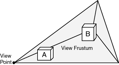

The simplest types of solids can be represented as cuboids, such as a cube or a brick. A more complex solid is a frustum, which is a pyramid formed by cutting a larger pyramid (with three or more faces) by a plane parallel to the base of that pyramid. Frustums are sometimes used as query windows to spatial operators. Frustums and cubes are typically modeled as solid-type SDO_GEOMETRY objects. Figure 1-9 shows a frustum as a query window, with two spatial objects at different distances from the view point.
Figure 1-9 Frustum as Query Window for Spatial Objects
Description of "Figure 1-9 Frustum as Query Window for Spatial Objects"

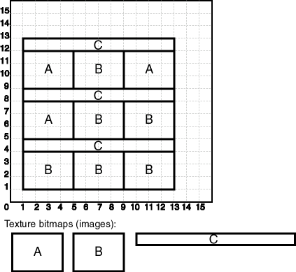

Figure 1-10 shows a large rectangular surface that, when viewed, appears to consist of three textures, each of which is repeated multiple times in various places on the surface.
As shown in Figure 1-10:
The entire image is a large surface that consists of 12 smaller rectangular faces (surface geometries), each of which can be represented by one of three images (labeled A, B, and C).
Three texture bitmaps (labeled A, B, and C) can be used to visualize all of the faces. In this case, bitmap A is used 3 times, bitmap B is used 6 times, and bitmap C is used 3 times.

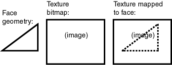

Figure 1-11 shows a texture bitmap mapped to a triangular face.
As shown in Figure 1-11:
The face (surface geometry) is a triangle. (For example, a side or roof of a building may contain several occurrences of this face.)
The texture bitmap (image) is a rectangle, shown in the box in the middle.
A portion of the texture bitmap represents an image of the face. This portion is shown by a dashed line in the box on the right.

For example, assume that the large surface in Figure 1-10 has the following definition:
SDO_GEOMETRY( SDO_POLYGON2D, -- two-dimensional polygon NULL, NULL, SDO_ELEM_INFO_ARRAY(1,1003,1), -- one polygon (exterior polygon ring) SDO_ORDINATE_ARRAY(1,1. 1,13, 13,13, 1,13, 1,1) )

Example 1-1 Inserting Texture Coordinate Definitions
INSERT INTO my_texture_coordinates VALUES( 1, 'Texture_A', SDO_ORDINATE_ARRAY(1,9, 1,5, 5,12, 1,12, 1,9) ); INSERT INTO my_texture_coordinates VALUES( 2, 'Texture_B', SDO_ORDINATE_ARRAY(5,9, 9,9, 9,12, 5,12, 5,9) ); INSERT INTO my_texture_coordinates VALUES( 3, 'Texture_C', SDO_ORDINATE_ARRAY(1,12, 13,12, 13,13, 1,13, 1,12) );
1.14.4.1 Schema Considerations with Texture Data
Texture bitmaps (stored as BLOBs or as URLs in VARCHAR2 format) and texture coordinate arrays (stored using type SDO_ORDINATE_ARRAY) can be stored in the same table as the SDO_GEOMETRY column or in separate tables; however, especially for the texture bitmaps, it is usually better to use separate tables. Texture bitmaps are likely to be able to be shared among features (such as different office buildings), but texture coordinate definitions are less likely to be sharable among features. (For example, many office buildings may share the same general type of glass exterior, but few of the buildings have the same number of windows and floors. In designing your textures and applications, you must consider how many buildings use the same texture subregion or drape the texture in the same size of repetitive matrix.)
An exception is a texture coordinate array that drapes an entire texture bitmap over a rectangular geometric face. In this case, the texture coordinate array can be specified as (0,0, 1,0, 1,1, 0,1, 1,1), defined by vertices "lower left", "lower right", "upper right", "upper left", and closing with "lower left". Many data sets use this texture coordinate array extensively, because they have primarily rectangular faces and they store one facade for each texture bitmap.
If you used separate tables, you could link them to the surface geometries using foreign keys, as in Example 1-2.
