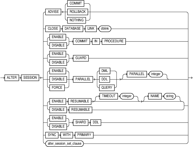

alter_session::=

ADVISE Clause
The ADVISE clause sends advice to a remote database to force a distributed transaction. The advice appears in the ADVICE column of the DBA_2PC_PENDING view on the remote database (the values are ‘C’ for COMMIT, ‘R’ for ROLLBACK, and ‘ ‘ for NOTHING). If the transaction becomes in doubt, then the administrator of that database can use this advice to decide whether to commit or roll back the transaction.
You can send different advice to different remote databases by issuing multiple ALTER SESSION statements with the ADVISE clause in a single transaction. Each such statement sends advice to the databases referenced in the following statements in the transaction until another such statement is issued.
See Also: “Forcing a Distributed Transaction: Example”
CLOSE DATABASE LINK Clause
Specify CLOSE DATABASE LINK to close the database link dblink. When you issue a statement that uses a database link, Oracle Database creates a session for you on the remote database using that link. The connection remains open until you end your local session or until the number of database links for your session exceeds the value of the initialization parameter OPEN_LINKS. If you want to reduce the network overhead associated with keeping the link open, then use this clause to close the link explicitly if you do not plan to use it again in your session.
See Also: Closing a Database Link: Example
ENABLE | DISABLE COMMIT IN PROCEDURE
Procedures and stored functions written in PL/SQL can issue COMMIT and ROLLBACK statements. If your application would be disrupted by a COMMIT or ROLLBACK statement not issued directly by the application itself, then specify DISABLE COMMIT IN PROCEDURE clause to prevent procedures and stored functions called during your session from issuing these statements.
You can subsequently allow procedures and stored functions to issue COMMIT and ROLLBACK statements in your session by issuing the ENABLE COMMIT IN PROCEDURE.
Some applications automatically prohibit COMMIT and ROLLBACK statements in procedures and stored functions. Refer to your application documentation for more information.
ENABLE | DISABLE GUARD
The security_clause of ALTER DATABASE lets you prevent anyone other than the SYS user from making any changes to data or database objects on the primary or standby database. This clause lets you override that setting for the current session.
See Also: security_clause for more information on the GUARD setting
PARALLEL DML | DDL | QUERY
The PARALLEL parameter determines whether all subsequent DML, DDL, or query statements in the session will be considered for parallel execution. This clause enables you to override the degree of parallelism of tables during the current session without changing the tables themselves. Uncommitted transactions must either be committed or rolled back prior to executing this clause for DML.
See Also: “Enabling Parallel DML: Example”
ENABLE Clause
Specify ENABLE to execute subsequent statements in the session in parallel. This is the default for DDL and query statements.
Restriction on the ENABLE clause
You cannot specify the optional PARALLEL integer with ENABLE.
DISABLE Clause
Specify DISABLE to execute subsequent statements in the session serially. This is the default for DML statements.
Restriction on the DISABLE clause
You cannot specify the optional PARALLEL integer with DISABLE.
FORCE Clause
FORCE forces parallel execution of subsequent statements in the session. If no parallel clause or hint is specified, then a default degree of parallelism is used. This clause overrides any parallel_clause specified in subsequent statements in the session but is overridden by a parallel hint.
PARALLEL integer
Specify an integer to explicitly specify a degree of parallelism:
The following types of DML operations are not parallelized regardless of this clause:
RESUMABLE Clauses
These clauses let you enable and disable resumable space allocation. This feature allows an operation to be suspended in the event of an out-of-space error condition and to resume automatically from the point of interruption when the error condition is fixed.
Note: Resumable space allocation is fully supported for operations on locally managed tablespaces. Some restrictions apply if you are using dictionary-managed tablespaces. For information on these restrictions, refer to Oracle Database Administrator’s Guide.
ENABLE RESUMABLE
This clause enables resumable space allocation for the session.
TIMEOUT
TIMEOUT lets you specify (in seconds) the time during which an operation can remain suspended while waiting for the error condition to be fixed. If the error condition is not fixed within the TIMEOUT period, then Oracle Database aborts the suspended operation.
NAME
NAME lets you specify a user-defined text string to help users identify the statements issued during the session while the session is in resumable mode. Oracle Database inserts the text string into the USER_RESUMABLE and DBA_RESUMABLE data dictionary views. If you do not specify NAME, then Oracle Database inserts the default string ‘User username(userid), Session sessionid, Instance instanceid’.
See Also: Oracle Database Reference for information on the data dictionary views
DISABLE RESUMABLE
This clause disables resumable space allocation for the session.
SHARD DDL Clauses
These clauses are valid only if you are connected to a sharded database. They let you control whether DDLs issued in the session are issued against the shard catalog database and all shards, or against only the shard catalog database.
See Also: Using Oracle Sharding
SYNC WITH PRIMARY
Use this clause to synchronize redo apply on a physical standby database with the primary database. An ALTER SESSION statement with this clause blocks until redo apply has applied all redo data received by the standby at the time the statement is issued. This clause returns an error, and synchronization does not occur, if the redo transport state for the standby database is not SYNCHRONIZED or if redo apply is not active.
See Also: Oracle Data Guard Concepts and Administration for more information on this session parameter
