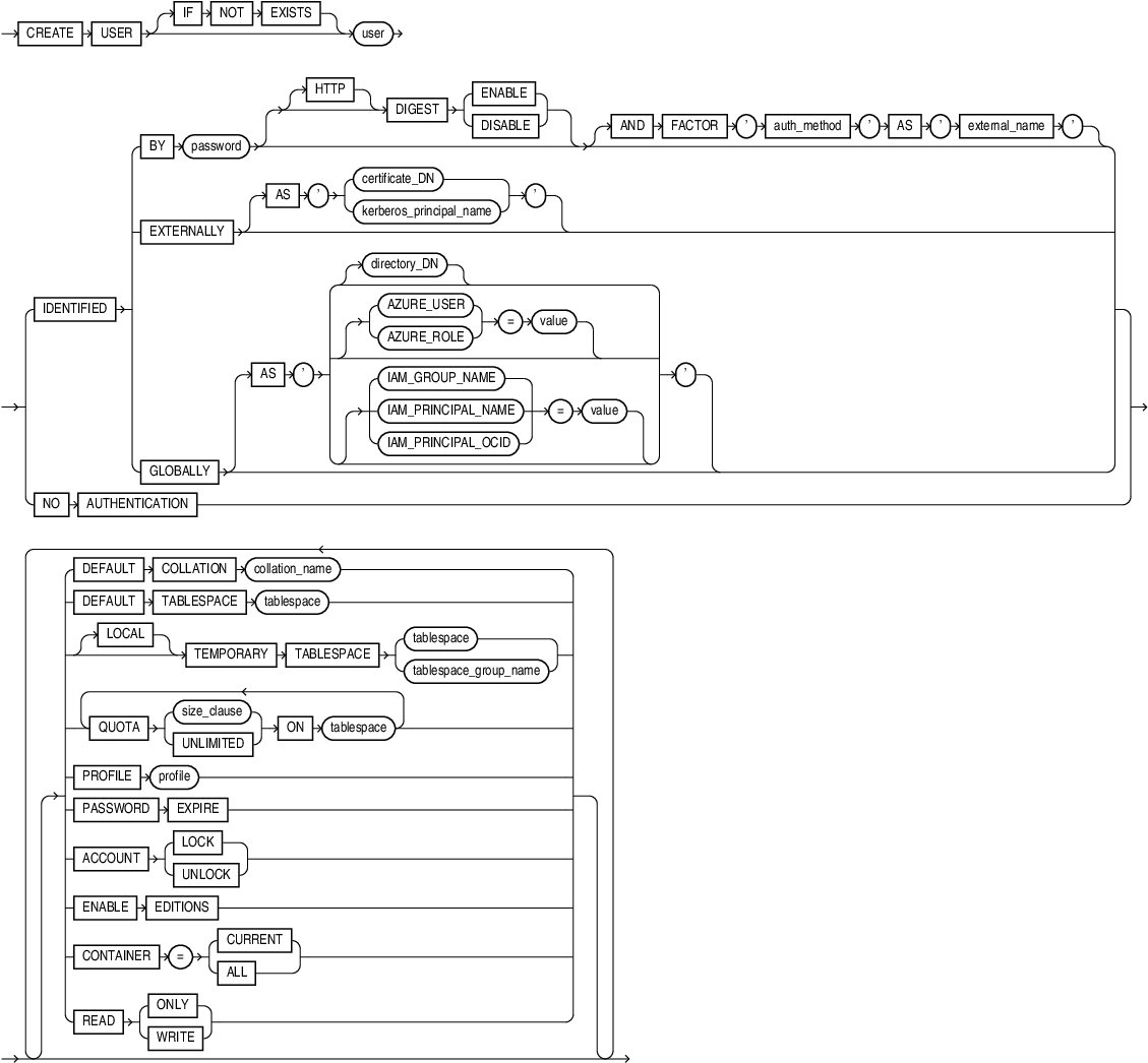

IDENTIFIED Clause
The IDENTIFIED clause lets you indicate how Oracle Database authenticates the user.
BY password
The BY password clause lets you creates a local user and indicates that the user must specify password to log on to the database. Passwords are case sensitive and their maximum length is 1024 bytes. Any subsequent CONNECT string used to connect this user to the database must specify the password using the same case (upper, lower, or mixed) that is used in this CREATE USER statement or a subsequent ALTER USER statement. Passwords can contain any single-byte, multibyte, or special characters, or any combination of these, from your database character set, with the exception of the double quotation mark (") and the return character . If a password starts with a non-alphabetic character, or contains a character other than an alphanumeric character, the underscore (_), dollar sign ($), or pound sign (#), then it must be enclosed in double quotation marks. Otherwise, enclosing a password in double quotation marks is optional.

AND FACTOR 'auth_method' AS 'external_name'
Use this clause to specify second factor authentication for native database users.
auth_method can be one of cert_auth, duo_push, oma_push, totp_auth.
For more see Configuring Authentication of the Database Security Guide.

NO AUTHENTICATION Clause
Use the NO AUTHENTICATION clause to create a schema that does not have a password and cannot be logged into. This is intended for schema only accounts and reduces maintenance by removing default passwords and any requirement to rotate the password.

DEFAULT TABLESPACE Clause
Specify the default tablespace for objects that are created in the user's schema. If you omit this clause, then the user's objects are stored in the database default tablespace. If no default tablespace has been specified for the database, then the user's objects are stored in the SYSTEM tablespace.

[LOCAL] TEMPORARY TABLESPACE Clause
Specify the tablespace or tablespace group for the user's temporary segments. If you omit this clause, then the user's temporary segments are stored in the database default temporary tablespace or, if none has been specified, in the SYSTEM tablespace.
Specify
tablespaceto indicate the user's temporary tablespace. SpecifyTEMPORARYTABLESPACEto indicate a shared temporary tablespace. SpecifyLOCALTEMPORARYTABLESPACEto indicate a local temporary tablespace. If you are connected to a CDB, then you can specifyCDB$DEFAULTto use the CDB-wide default temporary tablespace. -
Specify
tablespace_group_nameto indicate that the user can save temporary segments in any tablespace in the tablespace group specified bytablespace_group_name. Local temporary tablespaces cannot be part of a tablespace group.

QUOTA Clause
Use the QUOTA clause to specify the maximum amount of space the user can allocate in the tablespace.
A CREATE USER statement can have multiple QUOTA clauses for multiple tablespaces.
UNLIMITED lets the user allocate space in the tablespace without bound.
The maximum amount of space that you can specify is 2 terabytes (TB). If you need more space, then specify UNLIMITED.

PROFILE Clause
Specify the profile you want to assign to the user. The profile limits the amount of database resources the user can use. If you omit this clause, then Oracle Database assigns the DEFAULT profile to the user.
You can use the CREATE USER statement to create a new user, and associate the user with a profile that has the PASSWORD_ROLLOVER_TIME configured.
You must first set the password rollover period using CREATE PROFILE or ALTER PROFILE.
In the example u1 is the user, with password p1. prof1 is the profile with PASSWORD_ROLLOVER_TIME set.
CREATE USER u1 IDENTIFIED BY p1 PROFILE prof1 ;

PASSWORD EXPIRE Clause
Specify PASSWORD EXPIRE if you want the user's password to expire. This setting forces the user or the DBA to change the password before the user can log in to the database.
ACCOUNT Clause
Specify ACCOUNT LOCK to lock the user's account and disable access. Specify ACCOUNT UNLOCK to unlock the user's account and enable access to the account. The default is ACCOUNT UNLOCK.

CONTAINER Clause
The CONTAINER clause applies when you are connected to a CDB. However, it is not necessary to specify the CONTAINER clause because its default values are the only allowed values.
To create a common user, you must be connected to the root. You can optionally specify
CONTAINER=ALL, which is the default when you are connected to the root. -
To create a local user, you must be connected to a PDB. You can optionally specify
CONTAINER=CURRENT, which is the default when you are connected to a PDB.
