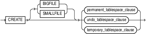

Syntax
create_tablespace::=
(permanent_tablespace_clause::=, temporary_tablespace_clause::=, undo_tablespace_clause::=)

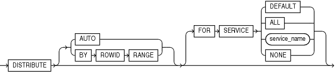

inmemory_distribute_tablespace::=

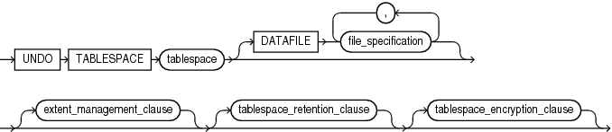

(file_specification::=, extent_management_clause::=, tablespace_retention_clause::=)

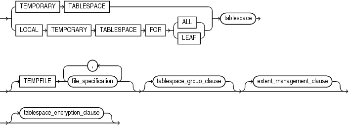

(file_specification::=, tablespace_group_clause::=, extent_management_clause::=, tablespace_encryption_clause::=)

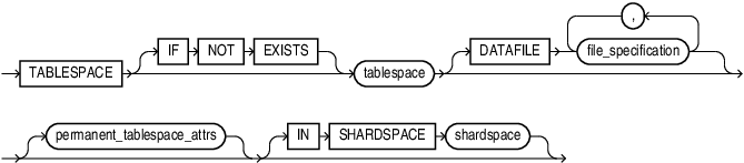

Use the following clauses to create a permanent tablespace. (Some of these clauses are also used to create a temporary or undo tablespace.)
tablespace
Specify the name of the tablespace to be created. The name must satisfy the requirements listed in “Database Object Naming Rules”.
IF NOT EXISTS
Specifying IF NOT EXISTS has the following effects:
If the tablespace does not exist, a new tablespace is created at the end of the statement.
If the tablespace exists, this is the tablespace you have at the end of the statement. A new one is not created because the older one is detected.
Using IF EXISTS with CREATE results in error: Incorrect IF NOT EXISTS clause for CREATE statement.

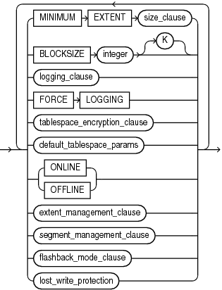

permanent_tablespace_attrs
Use the permanent_tablespace_attrs clauses to set the attributes of the tablespace.
MINIMUM EXTENT Clause
This clause is valid only for a dictionary-managed tablespace. Specify the minimum size of an extent in the tablespace. This clause lets you control free space fragmentation in the tablespace by ensuring that the size of every used or free extent in a tablespace is at least as large as, and is a multiple of, the value specified in the size_clause.
See Also: size_clause for information on that clause and Oracle Database VLDB and Partitioning Guide for more information about using MINIMUM EXTENT to control fragmentation
BLOCKSIZE Clause
Use the BLOCKSIZE clause to specify a nonstandard block size for the tablespace. In order to specify this clause, the DB_CACHE_SIZE and at least one DB_nK_CACHE_SIZE parameter must be set, and the integer you specify in this clause must correspond with the setting of one DB_nK_CACHE_SIZE parameter setting.
Restriction on BLOCKSIZE
You cannot specify nonstandard block sizes for a temporary tablespace or if you intend to assign this tablespace as the temporary tablespace for any users.
Note: Oracle recommend that you do not store tablespaces with a 2K block size on 4K sector size disks, because performance degradation can result.
See Also: Oracle Database Reference for information on the DB_nK_CACHE_SIZE parameter and Oracle Database Concepts for information on multiple block sizes
logging_clause
Specify the default logging attributes of all tables, indexes, materialized views, materialized view logs, and partitions within the tablespace. This clause is not valid for a temporary or undo tablespace.
If you omit this clause, then the default is LOGGING. The exception is creating a tablespace in a PDB. In this case, if you omit this clause, then the tablespace uses the logging attribute of the PDB. Refer to the logging_clause of CREATE PLUGGABLE DATABASE for more information.
The tablespace-level logging attribute can be overridden by logging specifications at the table, index, materialized view, materialized view log, and partition levels.
See Also: logging_clause for a full description of this clause
FORCE LOGGING
Use this clause to put the tablespace into FORCE LOGGING mode. Oracle Database will log all changes to all objects in the tablespace except changes to temporary segments, overriding any NOLOGGING setting for individual objects. The database must be open and in READ WRITE mode.
This setting does not exclude the NOLOGGING attribute. You can specify both FORCE LOGGING and NOLOGGING. In this case, NOLOGGING is the default logging mode for objects subsequently created in the tablespace, but the database ignores this default as long as the tablespace or the database is in FORCE LOGGING mode. If you subsequently take the tablespace out of FORCE LOGGING mode, then the NOLOGGING default is once again enforced.
Note: FORCE LOGGING mode can have performance effects. Refer to Oracle Database Administrator’s Guide for information on when to use this setting.
Restriction on Forced Logging
You cannot specify FORCE LOGGING for an undo or temporary tablespace.

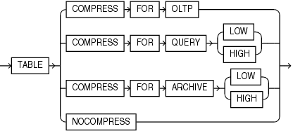

default_table_compression
Use this clause to specify default compression of data for all tables created in the tablespace. This clause is not valid for a temporary tablespace. The subclauses of this clause have the same semantics as they have for the table_compression clause of the CREATE TABLE statement, with one exception: The COMPRESS FOR OLTP clause here is equivalent to the ROW STORE COMPRESS ADVANCED clause of CREATE TABLE. Refer to the table_compression clauses of CREATE TABLE for the full semantics of these subclauses.

Specify OFFLINE to make the tablespace unavailable immediately after creation.
The data dictionary view DBA_TABLESPACES indicates whether each tablespace is online or offline.
The extent_management_clause lets you specify how the extents of the tablespace will be managed.
Note: After you have specified extent management with this clause, you can change extent management only by migrating the tablespace.
AUTOALLOCATEspecifies that the tablespace is system managed. Users cannot specify an extent size. You cannot specifyAUTOALLOCATEfor a temporary tablespace. -
UNIFORMspecifies that the tablespace is managed with uniform extents ofSIZEbytes.The defaultSIZEis 1 megabyte. All extents of temporary tablespaces are of uniform size, so this keyword is optional for a temporary tablespace. However, you must specifyUNIFORMin order to specifySIZE. You cannot specifyUNIFORMfor an undo tablespace.
If you do not specify AUTOALLOCATE or UNIFORM, then the default is UNIFORM for temporary tablespaces and AUTOALLOCATE for all other types of tablespaces.
If you do not specify the extent_management_clause, then Oracle Database interprets the MINIMUM EXTENT clause and the DEFAULT storage_clause to determine extent management.
Note: The DICTIONARY keyword is deprecated. It is still supported for backward compatibility. However, Oracle recommends that you create locally managed tablespaces. Locally managed tablespaces are much more efficiently managed than dictionary-managed tablespaces. The creation of new dictionary-managed tablespaces is scheduled for desupport.
See Also: Oracle Database Concepts for a discussion of locally managed tablespaces
Restrictions on Extent Management
Extent management is subject to the following restrictions:
A permanent locally managed tablespace can contain only permanent objects. If you need a locally managed tablespace to store temporary objects, for example, if you will assign it as a user’s temporary tablespace, then use the temporary_tablespace_clause.
If you specify this clause, then you cannot specify
DEFAULTstorage_clause,MINIMUMEXTENT, or the temporary_tablespace_clause.
See Also: Oracle Database Administrator’s Guide for information on changing extent management by migrating tablespaces and “Creating a Locally Managed Tablespace: Example”
segment_management_clause
The segment_management_clause is relevant only for permanent, locally managed tablespaces. It lets you specify whether Oracle Database should track the used and free space in the segments in the tablespace using free lists or bitmaps. This clause is not valid for a temporary tablespace.
Specify AUTO if you want the database to manage the free space of segments in the tablespace using a bitmap. If you specify AUTO, then the database ignores any specification for PCTUSED, FREELIST, and FREELIST GROUPS in subsequent storage specifications for objects in this tablespace. This setting is called automatic segment-space management and is the default.
MANUAL
Specify MANUAL if you want the database to manage the free space of segments in the tablespace using free lists. Oracle strongly recommends that you do not use this setting and that you create tablespaces with automatic segment-space management.
To determine the segment management of an existing tablespace, query the SEGMENT_SPACE_MANAGEMENT column of the DBA_TABLESPACES or USER_TABLESPACES data dictionary view.
If you specify AUTO segment management, then:
If you set extent management to
LOCALUNIFORM, then you must ensure that each extent contains at least 5 database blocks. -
LOCALAUTOALLOCATE, and if the database block size is 16K or greater, then Oracle manages segment space by creating extents with a minimum size of 5 blocks rounded up to 64K.
Restrictions on Automatic Segment-Space Management
This clause is subject to the following restrictions:
You can specify this clause only for a permanent, locally managed tablespace.
You cannot specify this clause for the
SYSTEMtablespace.
See Also:
Oracle Automatic Storage Management Administrator’s Guide for information on automatic segment-space management and when to use it
Oracle Database Reference for information on the data dictionary views
“Specifying Segment Space Management for a Tablespace: Example”
flashback_mode_clause
Use this clause in conjunction with the ALTER DATABASE FLASHBACK clause to specify whether the tablespace can participate in FLASHBACK DATABASE operations. This clause is useful if you have the database in FLASHBACK mode but you do not want Oracle Database to maintain Flashback log data for this tablespace.
This clause is not valid for temporary or undo tablespaces.
FLASHBACK ON
Specify FLASHBACK ON to put the tablespace in FLASHBACK mode. Oracle Database will save Flashback log data for this tablespace and the tablespace can participate in a FLASHBACK DATABASE operation. If you omit the flashback_mode_clause, then FLASHBACK ON is the default.
FLASHBACK OFF
Specify FLASHBACK OFF to take the tablespace out of FLASHBACK mode. Oracle Database will not save any Flashback log data for this tablespace. You must take the data files in this tablespace offline or drop them prior to any subsequent FLASHBACK DATABASE operation. Alternatively, you can take the entire tablespace offline. In either case, the database does not drop existing Flashback logs.
Note: The FLASHBACK mode of a tablespace is independent of the FLASHBACK mode of an individual table.
See Also:
Oracle Database Backup and Recovery User’s Guide for information on Oracle Flashback Database
ALTER DATABASE and FLASHBACK DATABASE for information on setting the
FLASHBACKmode of the entire database and reverting the database to an earlier version
lost_write_protection
Specify the lost_write_protection clause to create a storage area for lost write records. This storage area or shadow tablespace must be created, before you can enable lost write protection on datafiles and databases.
You may create as many shadow tablespaces as you need, and name them as you would any other tablespace.
Example: Create a Shadow Tablespace in a Database
This example creates the shadow tablespace sh_lwp1 for lost write protection:
CREATE BIGFILE TABLESPACE sh_lwp1 DATAFILE sh_lwp1.df SIZE 10M BLOCKSIZE 8K
LOST WRITE PROTECTION;
To enable lost write protection on datafiles and databases, you must specify the lost_write_protection clause with the ALTER TABLESPACE, ALTER DATABASE, and ALTER PLUGGABLE DATABASE statements.
Specify UNDO to create an undo tablespace. When you run the database in automatic undo management mode, Oracle Database manages undo space using the undo tablespace instead of rollback segments. This clause is useful if you are now running in automatic undo management mode but your database was not created in automatic undo management mode.
Oracle Database always assigns an undo tablespace when you start up the database in automatic undo management mode. If no undo tablespace has been assigned to this instance, then the database uses the SYSTEM rollback segment. You can avoid this by creating an undo tablespace, which the database will implicitly assign to the instance if no other undo tablespace is currently assigned.
The DATAFILE clause is described in “DATAFILE | TEMPFILE Clause”.
It is unnecessary to specify the extent_management_clause when creating an undo tablespace, because undo tablespaces must be locally managed tablespaces that use AUTOALLOCATE extent management. If you do specify this clause, then you must specify EXTENT MANAGEMENT LOCAL or EXTENT MANAGEMENT LOCAL AUTOALLOCATE, both of which are the same as omitting this clause. Refer to extent_management_clause for the full semantics of this clause.
This clause is valid only for undo tablespaces.
RETENTIONGUARANTEEspecifies that Oracle Database should preserve unexpired undo data in all undo segments of tablespace even if doing so forces the failure of ongoing operations that need undo space in those segments. This setting is useful if you need to issue an Oracle Flashback Query or an Oracle Flashback Transaction Query to diagnose and correct a problem with the data. -
RETENTIONNOGUARANTEEreturns the undo behavior to normal. Space occupied by unexpired undo data in undo segments can be consumed if necessary by ongoing transactions. This is the default.
This clause has the same semantics for undo tablespaces as for permanent tablespaces. Refer to tablespace_encryption_clause in the documentation on permanent tablespaces for full information.
Restrictions on Undo Tablespaces
Undo tablespaces are subject to the following restrictions:
You cannot create database objects in this tablespace. It is reserved for system-managed undo data.
The only clauses you can specify for an undo tablespace are the
DATAFILEclause, the tablespace_retention_clause, the tablespace_encryption_clause, and the extent_management_clause to specify localAUTOALLOCATEextent management. You cannot specify localUNIFORMextent management or dictionary extent management using the extent_management_clause. All undo tablespaces are created permanent, read/write, and in logging mode. Values forMINIMUMEXTENTandDEFAULTSTORAGEare system generated.
See Also:
Oracle Database Administrator’s Guide for information on automatic undo management and undo tablespaces and Oracle Database Reference for information on the
UNDO_MANAGEMENTparameter -
CREATE DATABASE for information on creating an undo tablespace during database creation, and ALTER TABLESPACE and DROP TABLESPACE
Use this clause to create a temporary tablespace, which is an allocation of space in the database that can contain transient data that persists only for the duration of a session. This transient data cannot be recovered after process or instance failure.
The transient data can be user-generated schema objects such as temporary tables or system-generated data such as temp space used by hash joins and sort operations. When a temporary tablespace, or a tablespace group of which this tablespace is a member, is assigned to a particular user, then Oracle Database uses the tablespace for sorting operations in transactions initiated by that user.
You can create two types of temporary tablespaces:
You can create a shared temporary tablespace by specifying the
TEMPORARYTABLESPACEclause. A shared temporary tablespace stores temp files on shared disk, so that the temporary space is accessible to all database instances. Shared temporary tablespaces were available in prior releases of Oracle Database and were called “temporary tablespaces.” Elsewhere in this guide, the term “temporary tablespace” refers to a shared temporary tablespace unless specified otherwise. -
Starting with Oracle Database 12c Release 2 (12.2), you can create a local temporary tablespace by specifying the
LOCALTEMPORARYTABLESPACEclause. Local temporary tablespaces are useful in an Oracle Clusterware environment. They store a separate, nonshared temp files for each database instance, which can improve I/O performance. A local temporary tablespace must be aBIGFILEtablespace.-
Specify
FORALLto instruct the database to create separate, nonshared temp files for all HUB and LEAF nodes. -
Specify
FORLEAFto instruct the database to create separate nonshared temp files for only LEAF nodes.
TEMPFILE
The TEMPFILE clause is described in “DATAFILE | TEMPFILE Clause”.
This clause is relevant only for temporary tablespaces. Use this clause to determine whether tablespace is a member of a tablespace group. A tablespace group lets you assign multiple temporary tablespaces to a single user and increases the addressability of temporary tablespaces.
Specify a group name to indicate that tablespace is a member of this tablespace group. The group name cannot be the same as tablespace or any other existing tablespace. If the tablespace group already exists, then Oracle Database adds the new tablespace to that group. If the tablespace group does not exist, then the database creates the group and adds the new tablespace to that group.
Specify an empty string (‘ ‘) to indicate that tablespace is not a member of any tablespace group.
Restriction on Tablespace Groups
Tablespace groups support only shared temporary tablespaces. You cannot add a local temporary tablespace to a tablespace group.
The extent_management_clause is described in extent_management_clause.
This clause has the same semantics for temporary tablespaces as for permanent tablespaces. Refer to tablespace_encryption_clause in the documentation on permanent tablespaces for full information.
See Also:
ALTER TABLESPACE and “Adding a Temporary Tablespace to a Tablespace Group: Example” for information on adding a tablespace to a tablespace group
CREATE USER for information on assigning a temporary tablespace to a user
Oracle Database Administrator’s Guide for more information on tablespace groups
Restrictions on Temporary Tablespaces
The data stored in temporary tablespaces persists only for the duration of a session. Therefore, only a subset of the CREATE TABLESPACE clauses are relevant for temporary tablespaces. The only clauses you can specify for a temporary tablespace are the TEMPFILE clause, the tablespace_group_clause, the extent_management_clause, and the tablespace_encryption_clause.
