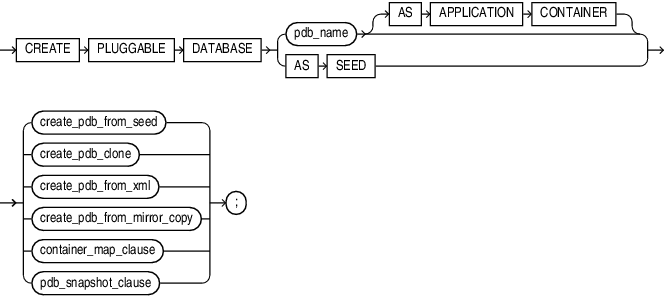

Syntax
create_pluggable_database::=
(create_pdb_from_seed::=, create_pdb_clone::=, create_pdb_from_xml::=)

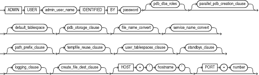

(pdb_dba_roles::=, parallel_pdb_creation_clause::=, default_tablespace::=, file_name_convert::=, service_name_convert::=, pdb_storage_clause::=, path_prefix_clause::=, tempfile_reuse_clause::=, user_tablespaces_clause::=, standbys_clause::=, logging_clause::=, create_file_dest_clause::=)

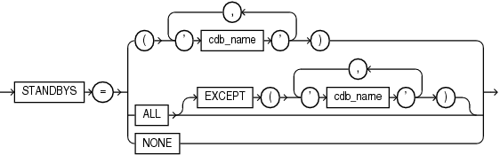

standbys_clause::=

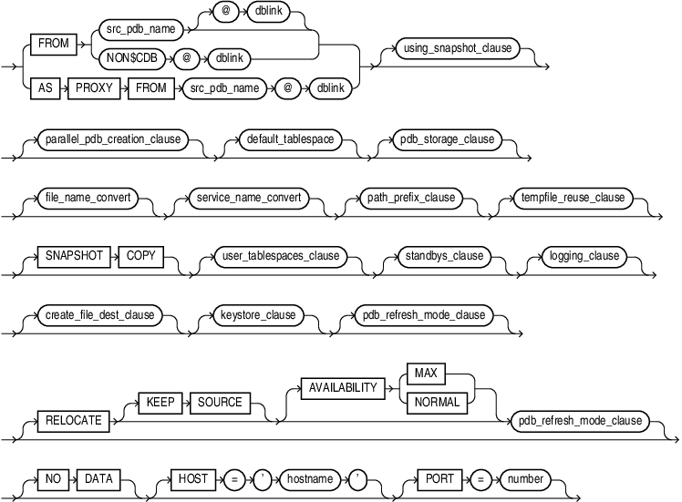

create_pdb_clone::=
(parallel_pdb_creation_clause::=, default_tablespace::=, pdb_storage_clause::=, file_name_convert::=, service_name_convert::=, path_prefix_clause::=, tempfile_reuse_clause::=, user_tablespaces_clause::=, standbys_clause::=, logging_clause::=, create_file_dest_clause::=, keystore_clause::=, pdb_refresh_mode_clause::=)

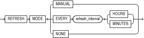

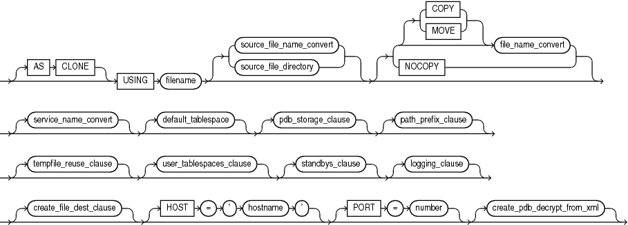

(source_file_name_convert::=, source_file_directory::=, file_name_convert::=, service_name_convert::=, default_tablespace::=, pdb_storage_clause::=, path_prefix_clause::=, tempfile_reuse_clause::=, user_tablespaces_clause::=, standbys_clause::=, logging_clause::=, create_file_dest_clause::=)
This clause enables you to create a PDB by using the seed in the CDB as a template.
See Also: Creating a PDB from Scratch
ADMIN USER
Use this clause to create an administrative user who can be granted the privileges required to perform administrative tasks on the PDB. For admin_user_name, specify name of the user to be created. Use the IDENTIFIED BY clause to specify the password for admin_user_name. Oracle Database creates a local user in the PDB and grants the PDB_DBA local role to that user.

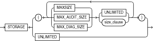

pdb_storage_clause
Use this clause to specify storage limits for the PDB.
Use
MAXSIZEto limit the amount of storage that can be used by all tablespaces in the PDB to the value specified with size_clause. This limit includes the size of data files and temporary files for tablespaces belonging to the PDB. SpecifyMAXSIZEUNLIMITEDto enforce no limit. -
Use
MAX_AUDIT_SIZEto limit the amount of storage that can be used by unified audit OS spillover (.binformat) files in the PDB to the value specified with size_clause. SpecifyMAX_AUDIT_SIZEUNLIMITEDto enforce no limit. -
Use
MAX_DIAG_SIZEto limit the amount of storage for diagnostics (trace files and incident dumps) in the Automatic Diagnostic Repository (ADR) that can be used by the PDB to the value specified with size_clause. SpecifyMAX_DIAG_SIZEUNLIMITEDto enforce no limit.
If you omit this clause, or specify STORAGE UNLIMITED, then there are no storage limits for the PDB. This is equivalent to specifying STORAGE (MAXSIZE UNLIMITED MAX_AUDIT_SIZE UNLIMITED MAX_DIAG_SIZE UNLIMITED).

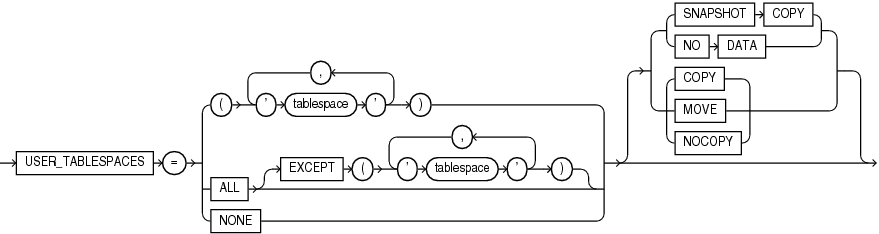

This clause lets you specify the tablespaces to be made available in the new PDB. The SYSTEM, SYSAUX, and TEMP tablespaces are available in all PDBs and cannot be specified in this clause.
You can use this clause to separate the data for multiple schemas into different PDBs.
Specify tablespace to make the tablespace available in the new PDB. You can specify more than one tablespace in a comma-separated list.
Specify
ALLto make all tablespaces available in the new PDB. This is the default. -
Specify
ALLEXCEPTto make all tablespaces available in the new PDB, except the specified tablespaces. -
Specify
NONEto make only theSYSTEM,SYSAUX, andTEMPtablespaces available in the new PDB.
When the compatibility level of the CDB is 12.2 or higher, the tablespaces that are excluded by this clause are created offline in the new PDB, and they have no data files associated with them. When the compatibility level of the CDB is lower than 12.2, the tablespaces that are excluded by this clause are offline in the new PDB, and all data files that belong to these tablespaces are unnamed and offline.
{ SNAPSHOT COPY | NO DATA }
These clauses apply only when cloning a PDB with the create_pdb_clone clause. By default, the database creates each tablespace to be made available in the new PDB according to the settings specified for cloning the PDB. These clauses allow you to override those settings as follows:
SNAPSHOTCOPY- Clone the tablespace using storage snapshots. -
NODATA- Clone the data model definition of the tablespace, but not the tablespace’s data.
{ COPY | MOVE | NOCOPY }
These clauses apply when you plug in a PDB with the create_pdb_from_xml clause. By default, the database creates each tablespace to be made available in the new PDB according to the settings specified for plugging in the PDB. These clauses allow you to override those settings as follows:
COPY- Copy the tablespace files to the new location. -
MOVE- Move the tablespace files to the new location. -
NOCOPY- Do not copy or move the tablespace files to the new location.
standbys_clause
Use this clause to specify whether the new PDB is included in one or more standby CDBs. If you include a PDB in a standby CDB, then during standby recovery the standby CDB will search for the data files for the PDB. If the data files are not found, then standby recovery will stop and you must copy the data files to the correct location before you can restart recovery.
Specify cdb_name to include the new PDB in the specified standby CDB. You can specify more than one standby CDB name in a comma-separated list.
Specify
ALLto include the new PDB in all standby CDBs. This is the default. -
Specify
ALLEXCEPTto include the new PDB in all standby CDBs, except the specified standby CDBs. -
Specify
NONEto exclude the new PDB from all standby CDBs. When a PDB is excluded from all standby CDBs, the PDB’s data files are unnamed and marked offline on all of the standby CDBs. Standby recovery will not stop if the data files for the PDB are not found on the standby. If you instantiate a new standby CDB after the PDB is created, then you must explicitly disable the PDB for recovery on the new standby CDB.
You can enable a PDB on a standby CDB after it was excluded on that standby CDB by copying the data files to the correct location, bringing the PDB online, and marking it as enabled for recovery.
logging_clause
Use this clause to specify the default logging attribute for tablespaces created within the PDB. The logging attribute controls whether certain DML operations are logged in the redo log file (LOGGING) or not (NOLOGGING).The default is LOGGING.
When creating a tablespace, you can override the default logging attribute by specifying the logging_clause of the CREATE TABLESPACE statement.
Refer to logging_clause for a full description of this clause.
By default, a newly created PDB inherits its Oracle Managed Files settings from the root. If the root uses Oracle Managed Files, then the PDB also uses Oracle Managed Files. The PDB shares the same base file system directory for Oracle Managed Files with the root and has its own subdirectory named with the GUID of the PDB. If the root does not use Oracle Managed Files, then the PDB also does not use Oracle Managed Files.
This clause lets you override the default behavior. You can enable or disable Oracle Managed Files for the PDB and you specify a different base file system directory or Oracle ASM disk group for the PDB’s files.
Specify
NONEto disable Oracle Managed Files for the PDB. -
Specify either directory_path_name or diskgroup_name to enable Oracle Managed Files for the PDB.
Specify directory_path_name to designate the base file system directory for the PDB’s files. Specify the full path name of the operating system directory. The directory must exist and Oracle processes must have appropriate permissions on the directory. The single quotation marks are required, with the result that the path name is case sensitive.
Specify diskgroup_name to designate the default Oracle ASM disk group for the PDB’s files.
If you specify a value other than NONE, then the database implicitly sets the DB_CREATE_FILE_DEST initialization parameter with SCOPE=SPFILE in the PDB.
HOST and PORT
These clauses are useful only if you are creating a PDB that you plan to reference from a proxy PDB. This type of PDB is called a referenced PDB.
When creating a referenced PDB:
If the name of the listener is different from the host name of the PDB, then you must specify the
HOSTclause. For hostname, specify the fully qualified domain name of the listener. Enclose hostname in single quotation marks. For example:'myhost.example.com'.In an Oracle Real Application Clusters (Oracle RAC) environment, you can specify for hostname any of the hosts for the PDB.
If the port number of the listener is not 1521, then you must specify the
PORTclause. For number, specify the port number for the listener.
A proxy PDB uses a database link to establish communication with its referenced PDB. After communication is established, the proxy PDB communicates directly with the referenced PDB without using a database link. The host name and port number of the listener for the referenced PDB must be correct for the proxy PDB to function properly.
See Also: The clause AS PROXY FROM of create_pdb_clone for information on creating a proxy PDB
create_pdb_clone
This clause enables you to create a new PDB by cloning a source to a target PDB. The source can be a PDB in the local CDB, or a PDB in a remote CDB. The target PDB is the clone of the source.
If the source is a PDB in the local CDB, then the source PDB can be plugged in or unplugged. If the source is a PDB in a remote CDB, then the source PDB must be plugged in.
If the source is a PDB in a remote CDB, then the source and the CDB that contains the target PDB must meet the following requirements:
They must have the same endian format.
They must have compatible character sets and national character sets, which means:
Every character in the source character set is available in the local CDB character set.
Every character in the source character set has the same code point value in the local CDB character set.
They must have the same set of database options installed.
Users in the PDB who used the default temporary tablespace of the source PDB use the default temporary tablespace of the new PDB. Users who used non-default temporary tablespaces in the PDB continue to use the same local temporary tablespaces in the new PDB.
You can clone a united PDB or an isolated PDB with the same command. The only difference is that the keystore password you must provide are for different keystores.

FROM
Use this clause to specify the source PDB. The files associated with the source are copied to a new location and these copied files are then associated with the new PDB.
The source PDB cannot be closed. It can be open as follows:
If the CDB that contains the source PDB (the source CDB) is in
ARCHIVELOGmode and local undo mode, then the source PDB can be open inREADWRITEmode and fully functional during the cloning operation. This is called hot PDB cloning. -
If the source CDB is not in
ARCHIVELOGmode, then the source PDB must be openREADONLY.
Specify the source PDB as follows:
If the source is a PDB in the local CDB, then use src_pdb_name to specify the name of the source PDB. You cannot specify
PDB$SEEDfor src_pdb_name. Instead, use the create_pdb_from_seed clause to create a PDB by using the seed as a template. -
If the source is a PDB in a remote CDB, then use src_pdb_name to specify the name of the source PDB and dblink to specify the name of the database link to use to connect to the remote CDB.
If source PDB datafiles are created as Oracle Managed File then the target datafiles need to be created as Oracle Managed File for the same CDB.
AS PROXY FROM
Use this clause to create a proxy PDB by referencing a different PDB, which is referred to as the referenced PDB. The referenced PDB can be in the same CDB as the proxy PDB or in a different CDB. A local proxy PDB is in the same CDB as its referenced PDB, and a remote proxy PDB is in a different CDB than its referenced PDB.
For src_pdb_name@dblink, specify the referenced PDB.
See Also: Creating a PDB as a Proxy PDB

pdb_storage_clause
Use this clause to specify storage limits for the new PDB. Refer to pdb_storage_clause for the full semantics of this clause.
The REFRESH MODE clause applies only when cloning a PDB. The source PDB must be in a remote CDB, that is, you must specify the source PDB using the FROM src_pdb_name@dblink clause.
This clause lets you specify the refresh mode of the PDB. You can use this clause to create a refreshable PDB. Changes in the source PDB can be propagated to the refreshable PDB, either manually or automatically. This operation is called a refresh. You can specify the following refresh modes:
MANUAL- This mode allows you to refresh the refreshable PDB manually at any time by issuing anALTERPLUGGABLEDATABASEREFRESHstatement. -
EVERYrefresh_intervalMINUTESorHOURS– This mode instructs the database to refresh the refreshable PDB every refresh_interval of selected time units, minutes or hours. If you selectMINUTES, therefresh_intervalmust be less than 3000. If you selectHOURS, therefresh_intervalmust be less than 2000. This mode also allows you to refresh the PDB manually at any time by issuing anALTERPLUGGABLEDATABASEREFRESHstatement. -
NONE- If you specify this mode, then the clone PDB is not a refreshable PDB. The database cannot refresh the PDB automatically and you cannot refresh the PDB manually. If you specify this mode, then you cannot later change the PDB into a refreshable PDB. This is the default.
A refreshable PDB can be opened only in READ ONLY mode. A refreshable PDB must be closed in order for a refresh to occur. If it is not closed when you attempt to perform a manual refresh, then an error will occur. If it is not closed when the database attempts an automatic refresh, then the refresh will be deferred until the next scheduled refresh.
See Also:
ALTERPLUGGABLEDATABASEREFRESH for information on refreshing a PDB manually -
ALTERPLUGGABLEDATABASEpdb_refresh_mode_clause for information on changing the refresh mode of a PDB -
Oracle Database Administrator’s Guide for more information on refreshable PDBs
RELOCATE
Use this clause to relocate a PDB from one CDB to another. The database first clones the source PDB to the target PDB, and then removes the source PDB. The database also moves the files associated with the PDB to a new location. This operation is the fastest way to relocate a PDB with minimal down time. The down time for the PDB is approximately the time required to copy the PDB’s files from their old location to their new location. The source PDB can be open in READ WRITE mode and fully functional during the relocation operation.
Specify REFRESH MODE to keep the PDB current during the relocate process.
You can specify the availability level with the AVAILABILITY keyword. The default availability is NORMAL. If you specify AVAILABILITY MAX, then additional operations are performed to ensure a smooth migration of the workload in a persistent connection between source and target.
In the create_pdb_clone clause, you must use the FROM src_pdb_name@dblink syntax to identify the location of the source PDB. For src_pdb_name, specify the name of the source PDB. For dblink, specify a database link that indicates the location of the source PDB. The database link must have been created in the CDB to which the PDB will be relocated. It can connect either to the root of the remote CDB or to the remote PDB.
KEEP SOURCE
Specify KEEP SOURCE if you want to keep the source PDB and preserve it in an unplugged state.
See Also: Relocating a PDB
NO DATA
The NO DATA clause applies only when cloning a PDB. This clause specifies that the source PDB’s data model definition is cloned, but not the PDB’s data. The dictionary data in the source PDB is cloned, but all user-created table and index data from the source PDB is discarded.

create_pdb_from_xml
This clause enables you to create a PDB by plugging an unplugged PDB (the source database) into a CDB (the target CDB). If the source database is an unplugged PDB, then it may have been unplugged from the target CDB or a different CDB.
The source database and the target CDB must meet the following requirements:
Every character in the source database character set is available in the target CDB character set.
Every character in the source database character set has the same code point value in the target CDB character set.
See Also:
- __COMMENT_76__
- Oracle Database PL/SQL Packages and Types Reference for more information on the
DBMS_PDBpackage
AS CLONE
Specify this clause only if the target CDB already contains a PDB that was created using the same set of data files. The source files remain as an unplugged PDB and can be used again. Specifying AS CLONE also ensures that Oracle Database generates new identifiers, such as DBID and GUID, for the new PDB.
USING
This clause lets you specify a file that contains information about the source database that your are plugging in. For filename, specify the full path name of the file. You can obtain this file in one of the following ways:
If the source database is an unplugged PDB, then the file was created by the pdb_unplug_clause of
ALTERPLUGGABLEDATABASEas follows:-
If the filename ends with the extension .xml, then it is an XML file containing metadata about the PDB. In this case, you must ensure that the XML metadata file, as well as the PDB’s data files, are in a location that is accessible to the CDB.
If the filename ends with the extension .pdb, then it is a PDB archive file. This is a compressed file that includes an XML file containing metadata about the PDB, as well as the PDB’s data files. The PDB archive file must exist in a location that is accessible to the CDB. When you use a .pdb archive file, this file is extracted when you plug in the PDB, and the PDB’s files are placed in the same directory as the .pdb archive file. Therefore, the source_file_directory clause is not required.
If the source database is a non-CDB, then you must create the XML metadata file using the
DBMS_PDBpackage, and ensure that the XML metadata file, as well as the source non-CDB’s data files, are in a location that is accessible to the CDB.
See Also:
ALTERPLUGGABLEDATABASE -
DBMS_PDBpackage
Specify this clause only if the contents of the XML file do not accurately describe the locations of the source files. If the files that must be used to plug in the source database are no longer in the location specified in the XML file, then use this clause to map the specified file names to the actual file names.
For filename_pattern, specify the string for the location of the files as specified in the XML file.
For replacement_filename_pattern, specify the string for the actual location that contains the files that must be used to create the PDB.
Oracle Database will replace filename_pattern with replacement_filename_pattern when searching for the source database files.
File name patterns cannot match files or directories managed by Oracle Managed Files.
If the files that must be used to create the PDB exist in the location specified in the XML file, you can either omit this clause or specify SOURCE_FILE_NAME_CONVERT=NONE.
Specify this clause only if the contents of the XML file do not accurately describe the locations of the source files and the source files are all present in a single directory. This clause is convenient when you have a large number of data files and specifying a replacement file name pattern for each file using the source_file_name_convert clause is not feasible.
- For directory_path_name, specify the absolute path of the directory that contains the source files. The directory is scanned to find the appropriate files based on the unplugged PDB’s XML file.
You can specify this clause for configurations that use Oracle Managed Files and for configurations that do not use Oracle Managed Files.
If the files that must be used to create the PDB exist in the location specified in the XML file, you can either omit this clause or specify SOURCE_FILE_DIRECTORY=NONE.
COPY
Specify COPY if you want the files listed in the XML file to be copied to the new location and used for the new PDB. This is the default. You can use the optional file_name_convert clause to use pattern replacement in the new file names. Refer to file_name_convert for the full semantics of this clause.
MOVE
Specify MOVE if you want the files listed in the XML file to be moved, rather than copied, to the new location and used for the new PDB. You can use the optional file_name_convert clause to use pattern replacement in the new file names. Refer to file_name_convert for the full semantics of this clause.
If the storage locations are different mounts, or if the storage locations do not support move at the OS or storage level, then the MOVE clause first copies the files then deletes the originals.
NOCOPY
Specify NOCOPY if you want the files for the PDB to remain in their current locations. Use this clause if there is no need to copy or move the files required to plug in the PDB.
Use this clause to determine how the database renames services for the new PDB. Refer to service_name_convert::= for the full semantics of this clause.
default_tablespace
Use this clause to specify a permanent default tablespace for the PDB. Oracle Database will assign the default tablespace to any non-SYSTEM user for whom a different permanent tablespace is not specified. The tablespace must already exist in the source database. Because the tablespace already exists, you cannot specify the DATAFILE clause or the extent_management_clause when creating a PDB with the create_pdb_from_xml clause.
pdb_storage_clause
path_prefix_clause
Use this clause to ensure that all directory object paths associated with the PDB are restricted to the specified directory or its subdirectories. Refer to path_prefix_clause for the full semantics of this clause.
Specify TEMPFILE REUSE to instruct the database to format and reuse a temp file associated with the new PDB if it already exists. Refer to tempfile_reuse_clause for the full semantics of this clause.
HOST and PORT
These clauses are useful only if you are creating a PDB that you plan to reference from a proxy PDB. This type of PDB is called a referenced PDB. Refer to HOST and PORT for the full semantics of these clauses.

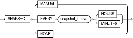

pdb_snapshot_clause
Specify this clause if you want to be able to create PDB snapshots.
NONEis the default. It means that no snapshots of the PDB can be created. -
MANUALmeans that the PDB snapshot can only be created manually. -
If snapshot interval is specified, PDB snapshots will be created automatically at specified interval. In addition, a user will also be able to create PDB snapshots manually
If expressed in minutes,
snapshot_intervalmust be less than 3000. -
If expressed in hours,
snapshot_intervalmust be less than 2000.
create_pdb_decrypt_from_xml
You must have the SYSKM privilege to execute this command.
For PDBs in united mode, the following restrictions apply:
You must specify the clause if you are using a TDE protected database. Otherwise it is optional.
You need not specify the clause for an isolated PDB.
The wallet must be open in
ROOT. -
The wallet file is copied in all cases:
NOCOPY,COPY, andMOVE.
Plugging a PDB from an XML Metadata File: Example
CREATE PLUGGABLE DATABASE CDB1_PDB2 USING '/tmp/cdb1_pdb2.xml' NOCOPY
KEYSTORE IDENTIFIED BY keystore_password DECRYPT USING transport_secret
Plugging a PDB from an Archive File: Example
CREATE PLUGGABLE DATABASE CDB1_PDB1_1_C USING '/tmp/cdb1_pdb3.pdb' DECRYPT USING transport_secret
For PDBs in isolated mode, you need not specify DECRYPT USING transport_secret. This is not required because the wallet file is copied during the creation of an unplugged PDB from an XML file. if you are creating a PDB from an archive file with the .pdb extension, the wallet file of the PDB is available in the zipped archive.
If the ewallet.p12 file already exists at the destination, a backup is automatically initiated. The backup file has the following format: ewallet_PLGDB_2017090517455564.p12.

Creating a PDB by Using the Seed: Example
The following statement creates a PDB salespdb by using the seed in the CDB as a template. The administrative user salesadm is created and granted the dba role. The default tablespace assigned to any non-SYSTEM users for whom no permanent tablespace is assigned is sales. File names for the new PDB will be constructed by replacing /disk1/oracle/dbs/pdbseed/ in the file names in the seed with /disk1/oracle/dbs/salespdb/. All tablespaces that belong to sales must not exceed 2G. The location of all directory object paths associated with salespdb are restricted to the directory /disk1/oracle/dbs/salespdb/.
CREATE PLUGGABLE DATABASE salespdb
ADMIN USER salesadm IDENTIFIED BY password
ROLES = (dba)
DEFAULT TABLESPACE sales
DATAFILE '/disk1/oracle/dbs/salespdb/sales01.dbf' SIZE 250M AUTOEXTEND ON
FILE_NAME_CONVERT = ('/disk1/oracle/dbs/pdbseed/',
'/disk1/oracle/dbs/salespdb/')
STORAGE (MAXSIZE 2G)
PATH_PREFIX = '/disk1/oracle/dbs/salespdb/';
