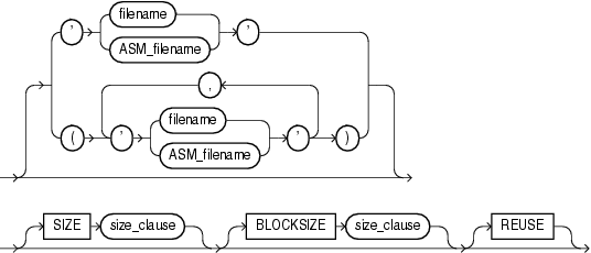

redo_log_file_spec::=
(size_clause::=)

redo_log_file_spec
Use this clause to specify the attributes of redo log files if your database storage is in a file system or in Oracle ASM disk groups.

SIZE Clause
Specify the size of the file in bytes. Use K, M, G, or T to specify the size in kilobytes, megabytes, gigabytes, or terabytes.
See Also: Oracle Database Administrator’s Guide for information on automatic undo management and undo tablespaces and “Adding a Log File: Example”
BLOCKSIZE Clause
Specify BLOCKSIZE to override the operating system-dependent sector size. If you omit this clause, then the database uses the operating system-dependent sector size as the block size.
When you add a redo log file to a 512-byte sector disk or to a 4KB sector disk with 512-byte emulation, the blocksize of the new file must be the original platform base block size or 4KB.
All logs within a log group must have the same block size. Two log groups created on separate disks can have different block sizes. However, the mixed configuration introduces overhead at every log switch. Oracle recommends that you create all log files with the same block size.
This clause is useful when the 4K sector size is in use, but you want to optimize disk space use rather than performance. In such a case you can override the operating system sector size by specifying BLOCKSIZE 512 or, for HP-UX, BLOCKSIZE 1024.
See Also: “Adding a Log File: Example”
REUSE
Specify REUSE to allow Oracle to reuse an existing file.
Restriction on the REUSE Clause
You cannot specify REUSE unless you have specified filename.
Whenever Oracle uses an existing file, the previous contents of the file are lost.
See Also: “Adding a Data File: Example” and “Adding a Log File: Example”
