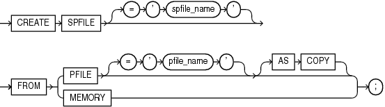

create_spfile::=

spfile_name
This clause lets you specify a name for the server parameter file you are creating.
If you specify spfile_name, then Oracle Database creates a nondefault server parameter file.
For spfile_name, you can specify a traditional filename, a file in an Oracle ACFS (Oracle Advanced Cluster File System) file system, or an Oracle Storage Management (Oracle ASM) filename.
If you specify a traditional filename or a file in an Oracle ACFS file system, then spfile_name can include a path prefix. If you do not specify such a path prefix, then the database adds the path prefix for the default storage location, which is platform dependent.
If you specify the Oracle ASM filename syntax, then the database creates the spfile in an Oracle ASM disk group.
When using a nondefault server parameter file, you must specify the server parameter filename in the
STARTUPcommand when you start up the database. The exception to this rule is as follows:- If the database is defined as a resource in Oracle Clusterware, the instance from which the command is issued is running, and you specify the spfile_name, specify the
FROMPFILEclause, and omit theASCOPYclause, then this statement automatically updates the SPFILE in the database resource. In this case, you can start up the database without referring to the server parameter file by name. If the instance from which the command is issued is not running, then the SPFILE in the database resource must be updated manually usingsrvctlmodifydatabase-ddbname-spfilespfile_path.
If you omit spfile_name, then Oracle Database uses the platform-specific default server parameter filename. If such a file already exists on the server, then this statement overwrites it. When using a default server parameter file, you can start up the database without referring to the file by name.
Restriction on spfile_name
You cannot specify spfile_name when creating a server parameter file while connected to a PDB.
See Also:
“Creating a Server Parameter File: Examples” for information on starting up the database with default and nondefault server parameter files
file_specification for the syntax of traditional and Oracle ASM filenames and ALTER DISKGROUP for information on modifying the characteristics of an Oracle ASM file
The appropriate operating-system-specific documentation for default parameter file names
pfile_name
Specify the traditional plain-text initialization parameter file from which you want to create a server parameter file. The traditional parameter file must reside on the server.
If you specify pfile_name and the traditional parameter file does not reside in the default directory for parameter files on your operating system, then you must specify the full path.
If you do not specify pfile_name, then Oracle Database looks in the default directory for parameter files on your operating system for the default parameter filename and uses that file. If that file does not exist in the expected directory, then the database returns an error.
Note: In an Oracle Real Application Clusters environment, you must first combine all instance parameter files into one file before specifying that filename in this statement to create a server parameter file. For information on accomplishing this step, see Oracle Real Application Clusters Administration and Deployment Guide.
AS COPY
This clause applies only if the database is defined as a resource in Oracle Clusterware. By default, if you specify both the spfile_name and the FROM PFILE clause, then the CREATE SPFILE statement automatically updates the SPFILE in the database resource. You can specify AS COPY to prevent the database from updating the SPFILE in the database resource.
MEMORY
Specify MEMORY to create an spfile using the current system-wide parameter settings. In an Oracle RAC environment, the created file will contain the parameter settings from each instance.
