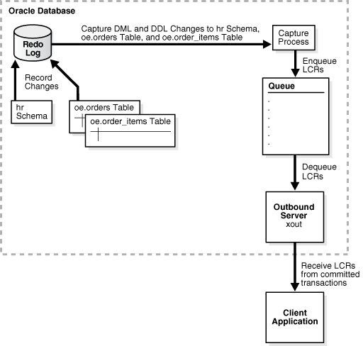

Figure 4-1 Local Capture and Outbound Server in the Same Database
Description of "Figure 4-1 Local Capture and Outbound Server in the Same Database"

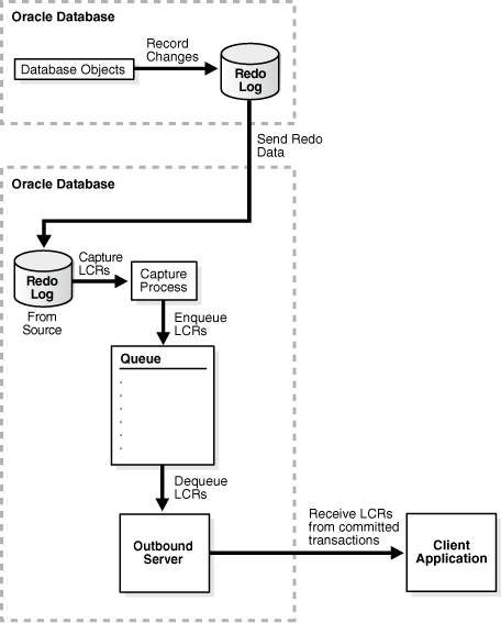

Figure 4-2 Downstream Capture and Outbound Server in the Same Database
Description of "Figure 4-2 Downstream Capture and Outbound Server in the Same Database"

If Required, Configure Log File Transfer to a Downstream Database
If you decided to use a local capture process, then log file transfer is not required. However, if you decided to use downstream capture that uses redo transport services to transfer archived redo log files to the downstream database automatically, then configure log file transfer from the source database to the capture database.
See "Decide How to Configure XStream Out" for information about this decision.
Tip:
You can use Oracle Enterprise Manager Cloud Control to configure log file transfer and a downstream capture process. See the Oracle Enterprise Manager Cloud Control online help for instructions.
The steps in this section configure the source database to transfer its redo log files to the capture database and configure the capture database to accept these redo log files.
To configure log file transfer to a downstream database:
Configure Oracle Net so that the source database can communicate with the downstream database.
Configure authentication at both databases to support the transfer of redo data.
Redo transport sessions are authenticated using either the Secure Sockets Layer (SSL) protocol or a remote login password file. If the source database has a remote login password file, then copy it to the appropriate directory on the downstream capture database system. The password file must be the same at the source database and the downstream capture database.
See Also:
Oracle Data Guard Concepts and Administration for detailed information about authentication requirements for redo transport
At the source database, set the following initialization parameters to configure redo transport services to transmit redo data from the source database to the downstream database:
LOG_ARCHIVE_DEST_n- Configure at least oneLOG_ARCHIVE_DEST_ninitialization parameter to transmit redo data to the downstream database. Set the following attributes of this parameter in the following way:-
SERVICE- Specify the network service name of the downstream database. -
ASYNCorSYNC- Specify a redo transport mode.The advantage of specifying
ASYNCis that it results in little or no effect on the performance of the source database.ASYNCis recommended to avoid affecting source database performance if the downstream database or network is performing poorly.The advantage of specifying
SYNCis that redo data is sent to the downstream database faster than whenASYNCis specified. Also, specifyingSYNCAFFIRMresults in behavior that is similar toMAXIMUMAVAILABILITYstandby protection mode. Note that specifying anALTERDATABASESTANDBYDATABASETOMAXIMIZEAVAILABILITYSQL statement has no effect on an XStream capture process. -
NOREGISTER- Specify this attribute so that the location of the archived redo log files is not recorded in the downstream database control file. -
VALID_FOR- Specify either(ONLINE_LOGFILE,PRIMARY_ROLE)or(ONLINE_LOGFILE,ALL_ROLES). -
TEMPLATE- If you are configuring an archived-log downstream capture process, then specify a directory and format template for archived redo logs at the downstream database. TheTEMPLATEattribute overrides theLOG_ARCHIVE_FORMATinitialization parameter settings at the downstream database. TheTEMPLATEattribute is valid only with remote destinations. Ensure that the format uses all of the following variables at each source database:%t,%s, and%r.Do not specify the
TEMPLATEattribute if you are configuring a real-time downstream capture process. -

Figure 4-3 provides an overview of this XStream Out configuration.
Figure 4-3 Sample XStream Out Configuration Created Using CREATE_OUTBOUND
Description of "Figure 4-3 Sample XStream Out Configuration Created Using CREATE_OUTBOUND"

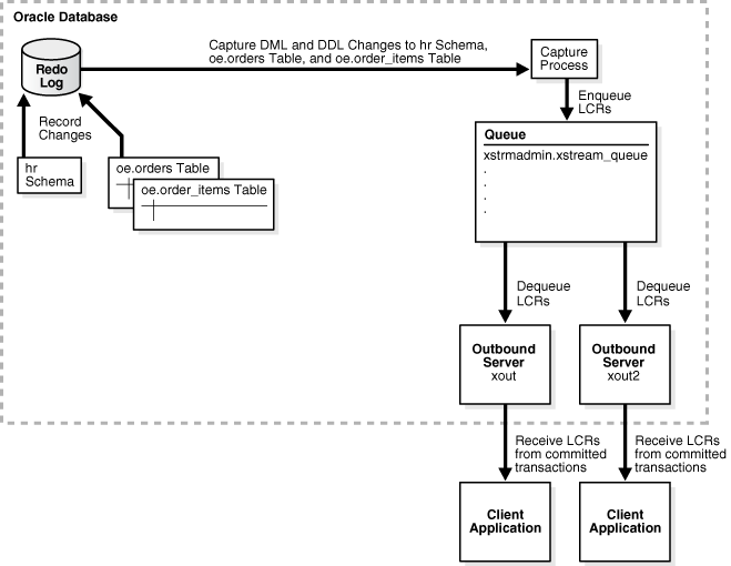

Adding an Additional Outbound Server to a Capture Process Stream
XStream Out configurations often require multiple outbound servers that process a stream of LCRs from a single capture process. You can add an additional outbound server to a database that already includes at least one outbound server.
The additional outbound server uses the same queue as another outbound server to receive the LCRs from the capture process. When an XStream Out environment exists, use the ADD_OUTBOUND procedure in the DBMS_XSTREAM_ADM package to add another outbound server to a capture process stream.
Prerequisites
Before completing the steps in this section, configure an XStream Out environment that includes at least one outbound server. The following sections describe configuring and XStream Out environment:
Assumptions
This section makes the following assumptions:
The name of the outbound server is
xout2. -
The queue used by the outbound server is
xstrmadmin.xstream_queue. -
DML and DDL changes made to the
oe.ordersandoe.order_itemstables are sent to the outbound server. -
hrschema are sent to the outbound server. -
The source database for the database changes is
db1.example.com.
Figure 4-4 provides an overview of this XStream Out configuration.
Figure 4-4 Sample XStream Out Configuration With an Additional Outbound Server
Description of "Figure 4-4 Sample XStream Out Configuration With an Additional Outbound Server"
To add another outbound server to a capture process stream using the ADD_OUTBOUND procedure:

Figure 4-5 provides an overview of this XStream Out configuration.
Figure 4-5 Sample XStream Out Configuration Created Using ADD_OUTBOUND
Description of "Figure 4-5 Sample XStream Out Configuration Created Using ADD_OUTBOUND"
To create an outbound server using the ADD_OUTBOUND procedure:

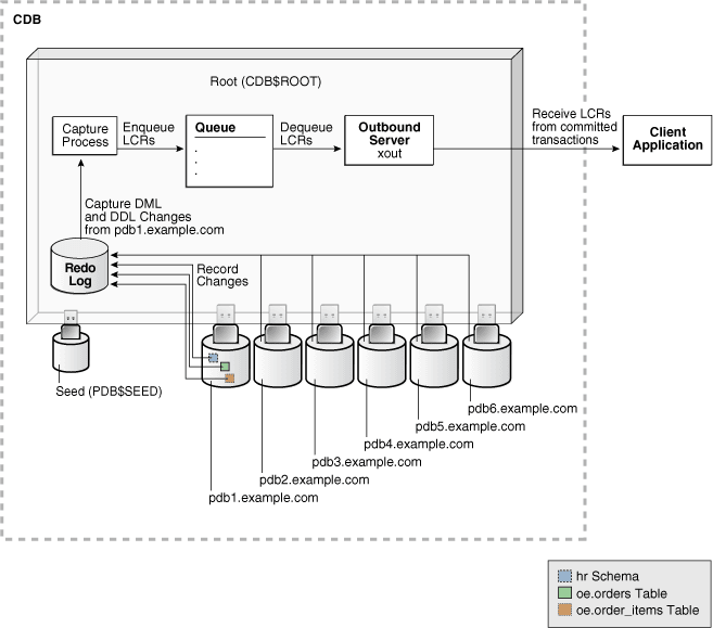

Figure 4-6 provides an overview of this XStream Out configuration.
Figure 4-6 Sample XStream Out Configuration Created Using CREATE_OUTBOUND for a PDB
Description of "Figure 4-6 Sample XStream Out Configuration Created Using CREATE_OUTBOUND for a PDB"
To create an outbound server using the CREATE_OUTBOUND procedure:

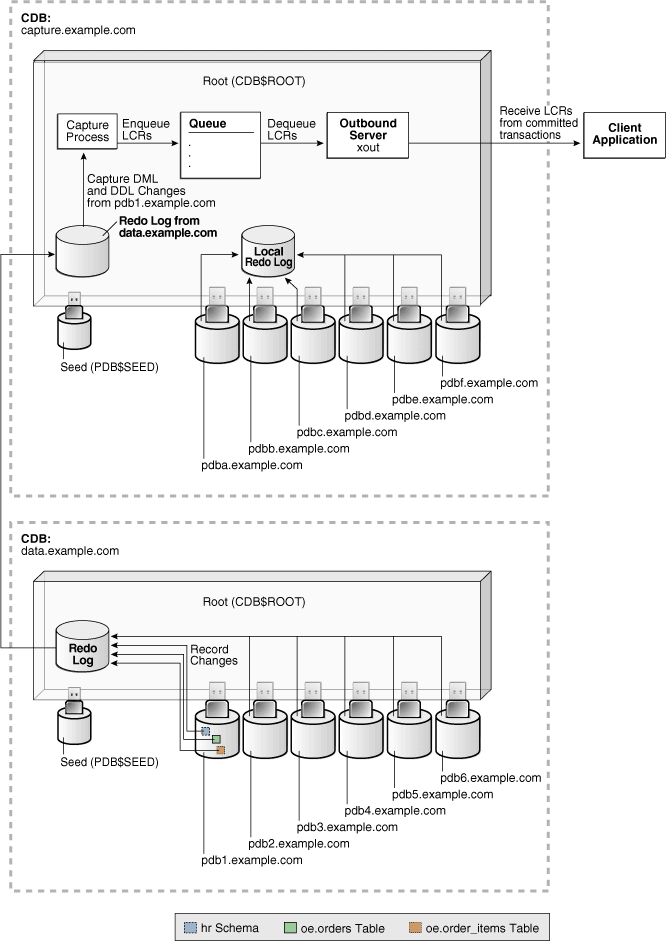

Assumptions
xout. -
c##xstrmadmin.xstream_queue. -
The source database is the PDB
pdb1.example.comin the CDBdata.example.com. -
The capture process runs in the CDB
capture.example.com. -
The outbound server runs in the CDB
oe.ordersandoe.order_itemstables from the PDBpdb1.example.comare sent to the outbound server. -
hrschema from the PDBpdb1.example.comare sent to the outbound server.
The following figure gives an overview of this XStream Out configuration.
Figure 4-7 Sample XStream Out Configuration Using Multiple CDBs and Downstream Capture
Description of "Figure 4-7 Sample XStream Out Configuration Using Multiple CDBs and Downstream Capture "
