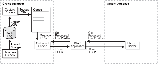

Figure A-1 provides an overview of the XStream environment configured in this section.
Figure A-1 Sample XStream Configuration
Description of Figure A-1 follows
Description of "Figure A-1 Sample XStream Configuration"
