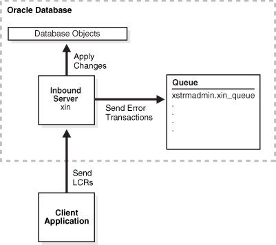

Assumptions for the Sample XStream In Configuration
This section makes the following assumptions:
The name of the inbound server is
xin. -
The inbound server applies all of the changes it receives from the XStream client application.
The queue used by the inbound server is
xstrmadmin.xin_queue.
Figure 9-1 provides an overview of this XStream In configuration.
Figure 9-1 Sample XStream In Configuration
Description of "Figure 9-1 Sample XStream In Configuration"

Creates an inbound server named
xin. -
Sets the queue with the name
xin_queueas the inbound server's queue, and creates this queue if it does not exist. This queue does not store LCRs sent by the client application. Instead, the queue stores error transactions if an LCR raises an error. The current user is the queue owner. In this example, the current user is the XStream administrator. -
Sets the current user as the apply user for the inbound server. In this example, the current user is the XStream administrator. The client application must connect to the database as the apply user to interact with the inbound server.

Create and run the client application that will connect to the inbound server and send LCRs to it.
See Also:
"Sample XStream Client Application" for a sample application
If the inbound server is disabled, then start the inbound server.
For example, enter the following:
exec DBMS_APPLY_ADM.START_APPLY('xin');
