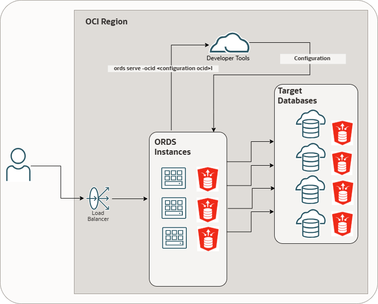

DATABASE
Configures ORDS so that all pool connections use an ORDS Runtime Database user (for example: ORDS_PUBLIC_USER). ORDS must be installed in these databases, and all RESTful service definitions must be sourced from the database.
When service definitions are stored in the database, the following options can also be configured:
  • All available ORDS configuration properties
  • Database Actions
  • Oracle APEX
Figure 4-1 DATABASE ORDS RESTful Service Definition Location

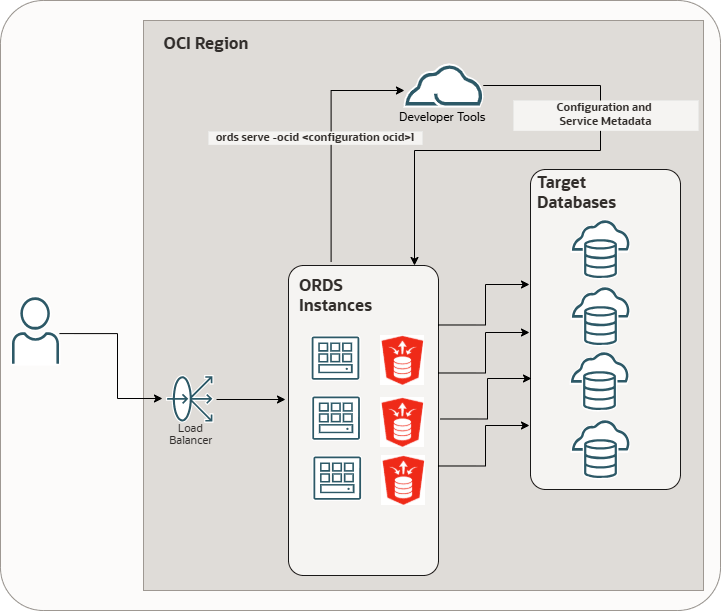

CLOUD
In this configuration, all RESTful service definitions including user-defined resources such as modules, templates, and handlers, as well as user-enabled resources such as AutoREST APIs are managed exclusively through the configuration. This deployment model offers maximum flexibility and enables ORDS to be used with databases where installing ORDS is not permitted.
In this configuration:
  • ORDS pools are defined using OCI Database Tools Connections for enhanced security
  • ORDS pool connections use a non-ORDS Runtime Database user.
  • ORDS installation is not required for these databases (that is, will not reference ORDS_METADATA for RESTful service implementation).
Figure 4-2 CLOUD ORDS RESTful Service Definition Location

  9. Create a Database API Gateway service, choose one of two available deployment methods:
    1. In the Database: In this setup, ORDS is already installed in the target database. The ORDS, an additional ORDS Runtime User has been created (i.e. a new ORDS_PUBLIC_USER[n] schema or on an existing schema via the ORDS_ADMIN.PROVISION_RUNTIME_ROLE procedure), and ORDS metadata reside in the database). Only
      1. Under this deployment only the ORDS global and pool configuration settings are retrieved dynamically. API definitions are still defined in the database.
    2. In the Cloud: In this setup, ORDS is not installed in the target database. Instead, all ORDS artifacts are dynamically retrieved, including global and pool configuration settings, ORDS metadata, Auto-REST definitions, and user-created ORDS APIs.
      When choosing which APIs to enable, verify that the target objects are owned by the same schema associated with the Database Tools Connection user.
      Refer to sample OpenAPI Specification Document for an example OpenAPI specification that conforms to the OCI Database API Gateway API specifications.
  10. Start ORDS using your Database API Configuration.
    1. For Instance Principal authentication (with ORDS deployed on an OCI Compute instance), navigate to the Database API Connection dashboard. From the Actions menu, select View ORDS Command Line to display and copy the required ORDS CLI command. From your OCI compute Instance, start the ORDS service using the following command:
      ords serve --ocid <CONFIG_OCID>
    2. If you are using OCI Profile authentication (IAM user), with ORDS deployed locally, external to OCI, or for instance a Docker container, start ORDS using the following command:
      ords --java-options "-Doci.profile=DEFAULT" serve --OCID <CONFIG_OCID>
      This example assumes an OCI CLI profile exists and the DEFAULT profile has been used.
      At startup, ORDS dynamically retrieves its configuration from the OCI Database API Gateway service and applies updates at runtime without requiring a restart
